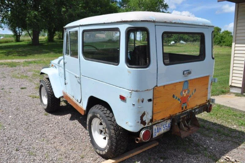

Here's the image from the ad. I assume this was when the seller bought it:

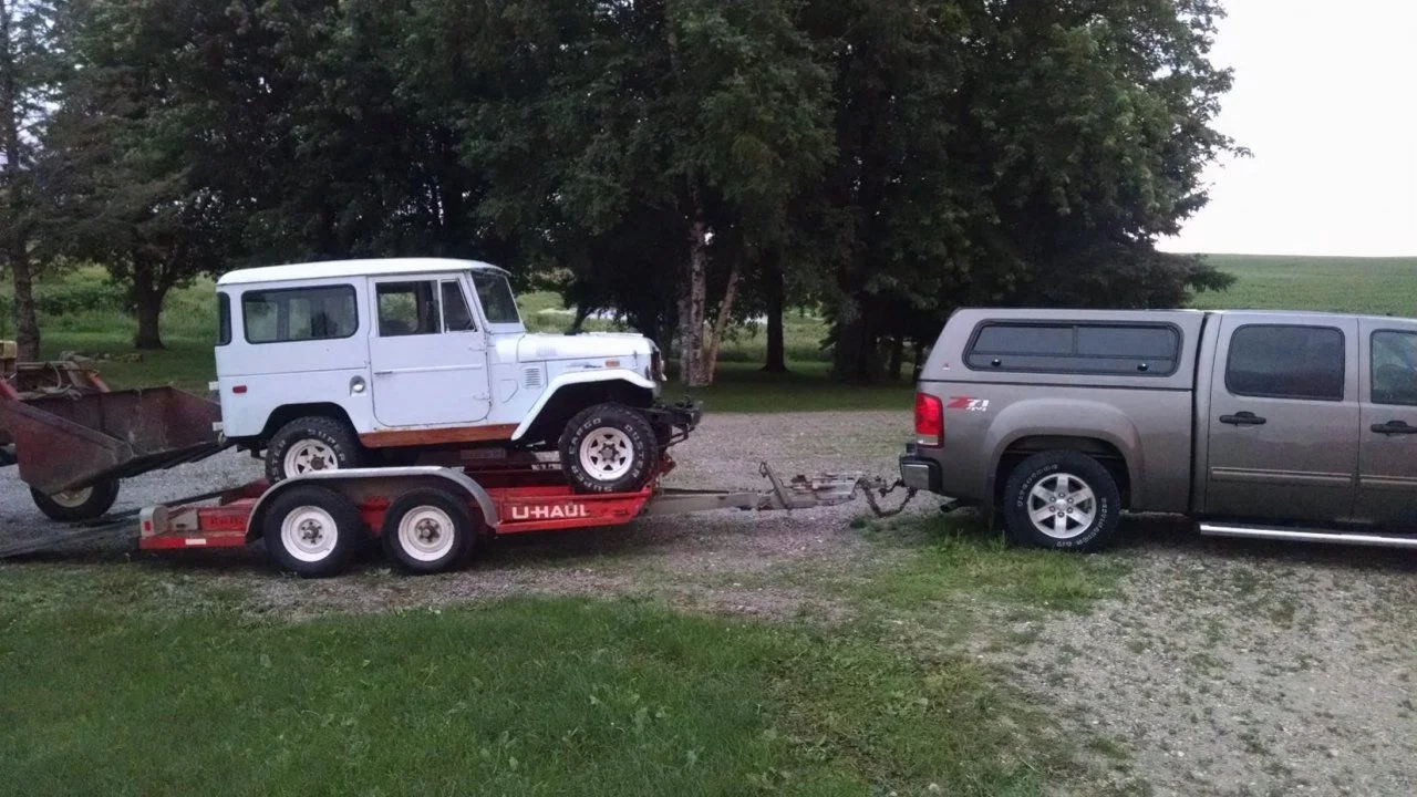

Getting it home. I forgot to take a picture of the truck bed full of parts, but the engine, trans and TC were out when I bought it. The custom tailgate and mural are pretty classic...

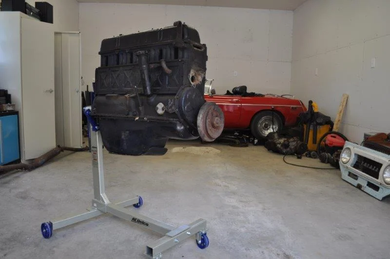

The engine has a spun bearing.

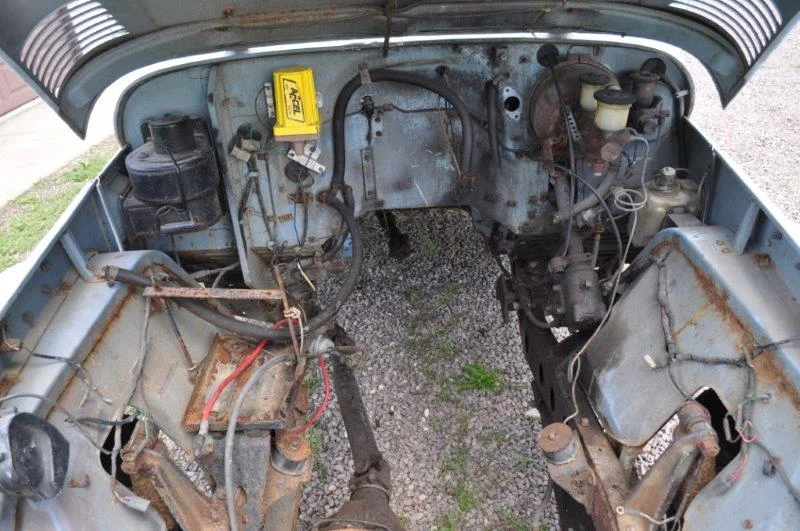

Step 1 was disassembly to see what I actually got myself into.
