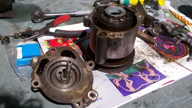

Smog Pump Rebuild
Smog Pump Rebuild. So after getting this thing running again, the smog pump started howling. So we pulled the belt and ran it for a while. I decided to keep the pump running and ordered new bearings from the links on this thread.
https://forum.ih8mud.com/40-55-series-tech/156216-smog-pump-rebuild-bearings.html
The parts ran less than $30. I borrowed a puller from Autozone (FREE) and got some synthetic high temp GreenGrease (Green Grease....The Best Grease Money Can Buy!....Just ask anyone who has used it!.....). There is some debate on what is the best grease to use, I will let you know how long the rebuild holds up. Also this thread by Trollhole with pictures was great on the rebuild.
https://forum.ih8mud.com/40-55-series-tech/204096-smog-pump-rebuild.html
Pump sounds much happier and is working well. Next on the list is a carb rebuild, not right away but at some point in the near future. The carb has never been rebuilt from my knowledge and is hesitating in certain spots under a load. What is the best way to get a carb rebuild done? I know most people have this done by an expert. Any opinions?
Damn that engine bay looks good. I might need to do this to mine.
Curious why you are keeping the smog system hooked up? I got mine a few months back from the original owner and it looks to me like they pulled the belt off about 30 years ago. I've been tempted to hook it back up...but only if I will save in fuel. I'd imagine it is taking horsepower.
When I got mine it had all emissions working including the pump. I agree that it probably takes some horsepower to run the emissions. I just want to keep the engine original and all in working order. Good luck with putting yours back together.
