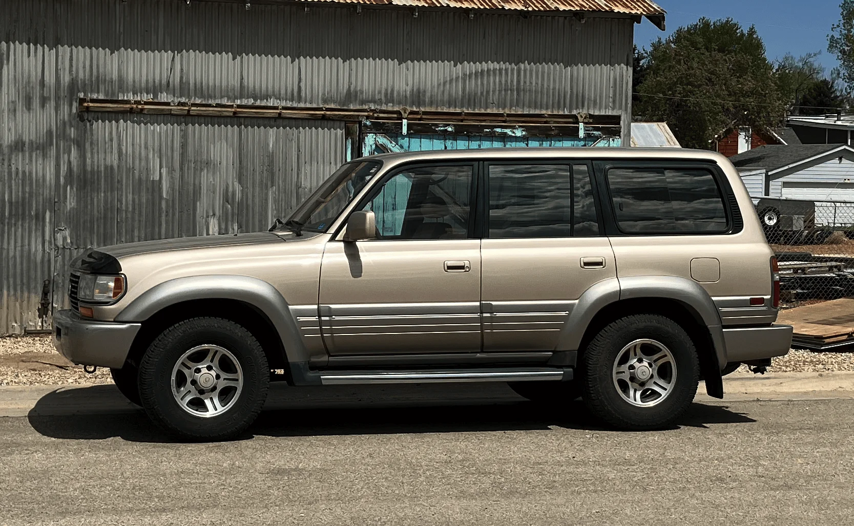

Nice man! Looks a lot like mine except I still have my roof rack :bang:
How many miles does it have?

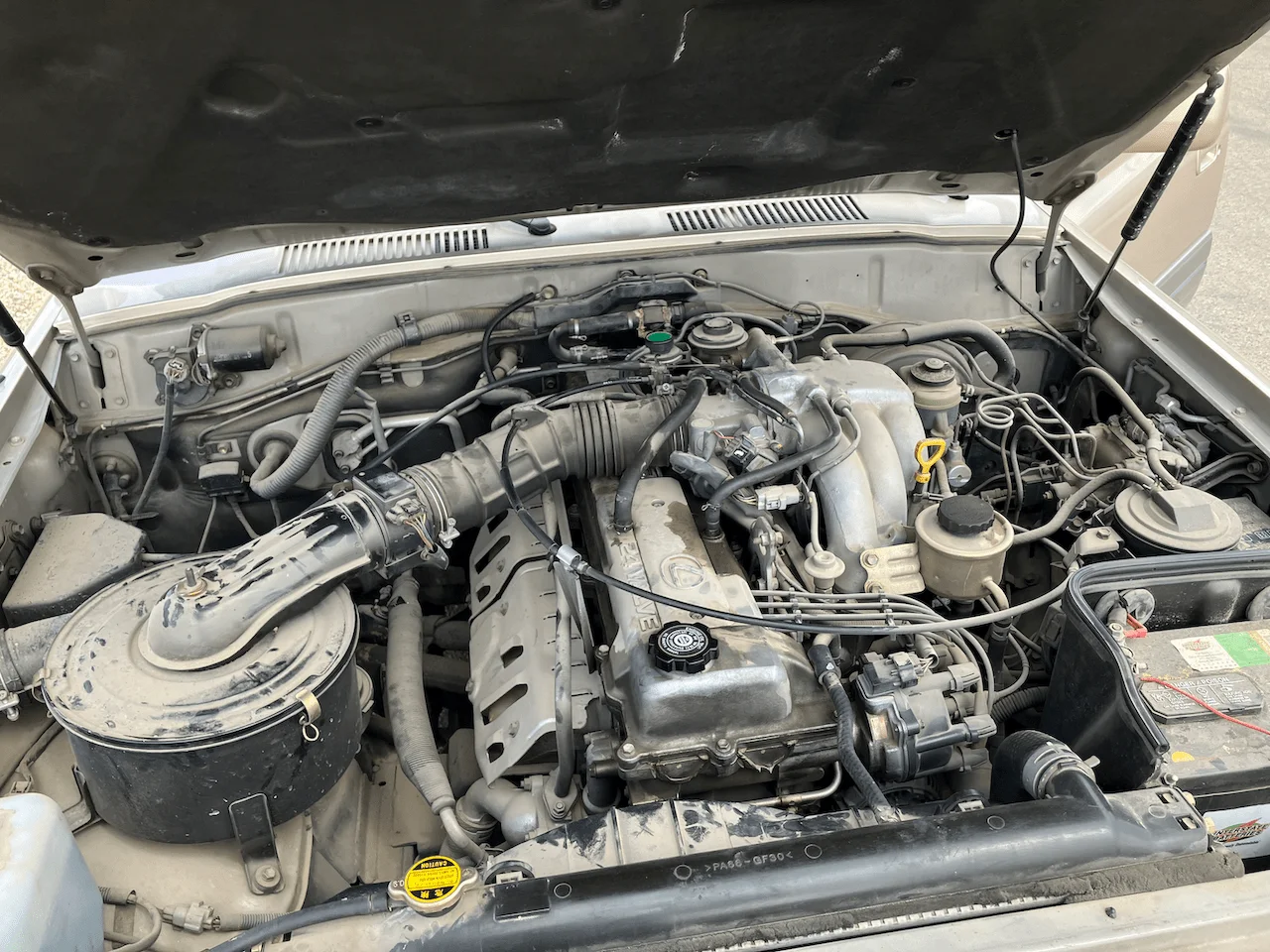

And +1 on the video, maybe drop an engine bay pic while we wait :bounce:
Yeah lost somewhere in the past 30 years haha. Odometer reads 177k, pretty sure it's accurate from the sporadic readings I can find on Carfax.
It's not pretty but here's the engine bay. Service records are scarce, last I have access to is 1998. Pretty sure the last owner only put 30k or so miles in 6 years so it was basically just sitting. I find fresh oil underneath the front axle just about every day, and even though I keep filling the tank about a quarter of the way, every time I check tank is empty. Could be related to the very strong smell of gas from the exhaust when I run it. I have a video of it smoking but it was when I first got it, definitely less smoke now so I'll just get a new video tomorrow.
