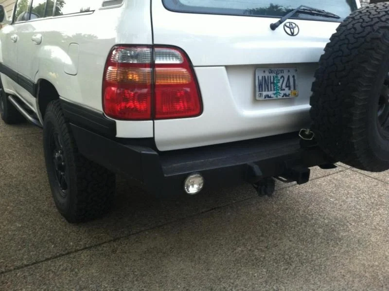

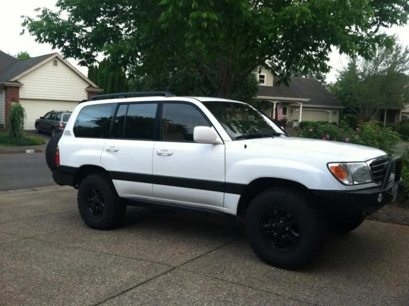

I think i finally got her to the point where i'm comfortable with posting some pics
That looks bad ass! What kind of bumpers are those? I really like how that front bumper doesn't protrude so far out like many other bumpers.
Front bumper wing looks like it's nearly touching the sheetmetal, from my own unfortunate experience i'd recommend .75" as a gap if you will wheel it. I started with .5" and have damage on both sides, at .75 I have not touched yet. Granted you have a different bumper but the flex is in the truck, the body moves a lot on the frame.
Looking nice though. :cheers:
Thanks for the responses. The wheels are liquid stripped and painted with Duplicolor black and clear. Did it about a year ago and has held up really well. I had a guy here in town do the bumpers. Just works out of his garage and is pretty inexpensive which worked well with my budget. Definitely not slee but no complaints. I'm a little concerned with the tight fit against the sheetmetal but i'm pretty tame when it comes to wheelin. Really just want to reach the remote fishin lakes.

If you have not already, consider installing some rubber weather strip on the inside lip of the bumper, It would help with contact abrasion a bit at least.
beautiful build. Love the custom bumpers
Looks great!! Keep it up
Bumpers look awesome would love to see some more pics of each
Recommendation on good weather strip?
E-mail Slee and find out what they use on their front bumpers. I thought it was something available at Autozone.
