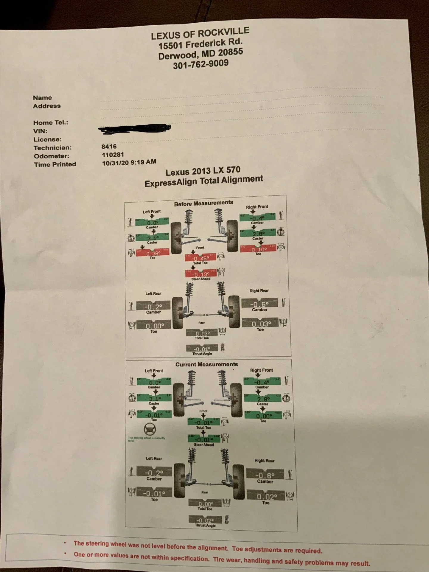

@TTO5 @TeCKis300 @bloc @Taco2Cruiser @gaijin @nwfl4runner I’m happy to report that after 3 months of dealing with a loose front end over bumps due to a Lexus dealer (left driver side tie rod nut left loose) and 2 Indy shops not being able to properly align my 2013 LX570 with 110,000 miles, I decided to take it to the dealer where I purchased it from last year which is about 40 mins from me. They nailed it! I was seriously considering replacing The whole front suspension or selling the truck. Now I’m floored by the difference a good alignment can make to the driving experience! All credit to Ourisman Lexus of Rockville, MD! Only took an hour while I waited on a Saturday afternoon for $122! Truck finally tracks straight with little steering correction and feels solid up front after they re-checked everything up front and properly aligned! Steering wheel is dead center and I was cheesing from ear to ear as I drove home as my LX570 has never felt like this. Amazing how a 7 year old SUV with 110,000 miles can feel brand new with a proper factory alignment! I’ve posted the alignment sheet. Thanks to all for the suggestions on troubleshooting.

Here are my alignment reports from two different shops in less than 1 week:
This is from a local tire store. See how they got it to 0 in after reading.
this is from dealership within 1 week as they diagnosed the vibration issue:
Dealer was telling me, it’s not easy to fake this 0.0 readings in the software. Someone has to push the wheel to get to 0.0 and another person has to click capture when that happens. I don’t know what to say, except I spend 200$ for that perfect 0.0 alignment which is completely off in a week on dealer machine. 😂
