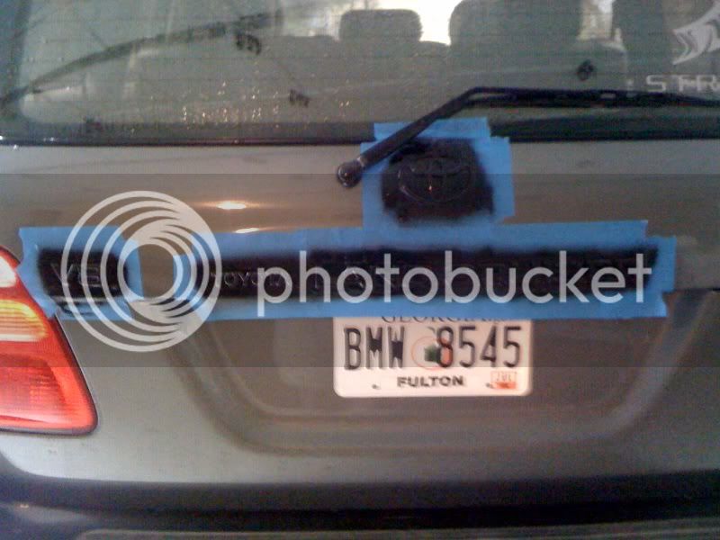

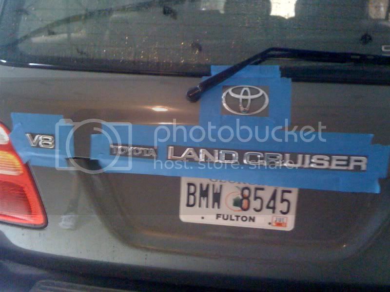

I got a can of plastidip from a friend today and decided to mask off and black out the rear emblems.
I sprayed it down and let it sit for 30 minutes then did the second coat.

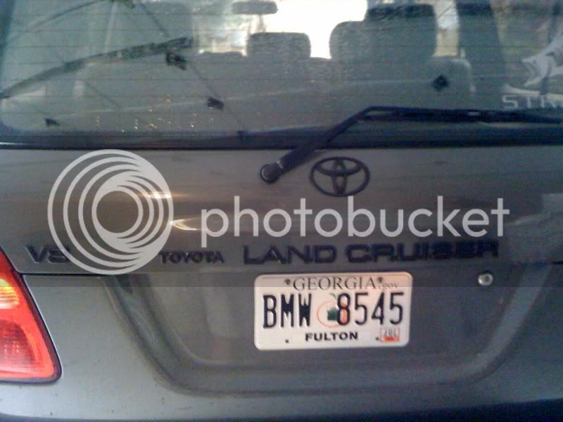

Then after it was all dried it peeled off perfectly! and I love the look

no i didnt tape off in between each individual letter and the insides of the emblems. when i pulled off the tape the plastidip tucked up against the bottom and top edges peeled of with the tape but still managed to completely wrap the letters and emblems well. there were little bits that hung off that i picked off with a tiny screwdriver which i also used on the insides of the emblem. it came off perfectly, i was expecting it to be more time consuming but it was actually really quick and simple

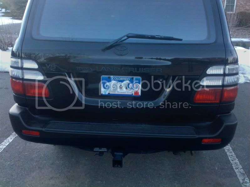

That looks great Taylor. I did mine the same way a few months ago. Plasti-Dip holds up well. Fuzz did his rear bumper in the stuff. You might want to ask him about it. Once you start with it, you want to put it on everything! Cool thing is, if you don't like how it turns out...just peel it off.

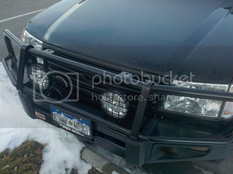

Anyone use this on the entire front grill, if so, how has it held up?

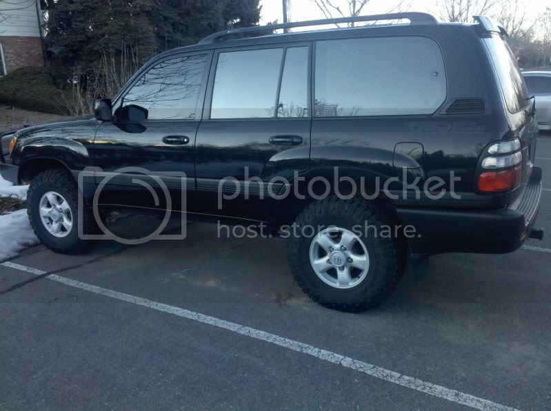

Paul is correct. I've plastidipped pretty much everything on the outside of my truck that wasn't black (except the wheels...yet). Grille, side trim, rear bumper, emblems. It's been on for about 3 months now and has held up remarkably well through the winter. Cleans easily, and holds up to both high pressure touchless and brush car washes. As for wheeling, no data on that yet. I'm sure I'll sustain some damage/tears in the coating if a sharp branch or rock really gets into it, but for now it's all good.

how did you do the grille? did you tape it off and put newspapers behind it?

I also painted the surrounding parts of my third brake light black and masked off the portion of lens light emits from to decrease the chances of the light getting "washed out" from intense sunlight. You'll notice most school buses and traffic lights have the areas around the light painted black to increase the visibility. Also, you can see TheFuzz did the same, painted around the actual light, to help increase visibility during intense sunlight.
