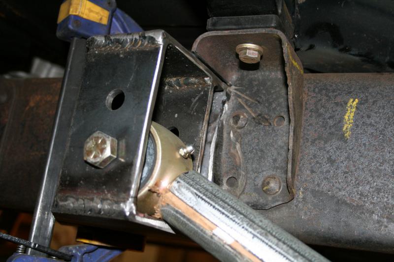

I found this photo last night and it's a good representation of how you could raise the lower brackets and keep the proper separation at the frame. I'm guessing that shorter links were used in order to keep the right triangulation with narrower mounting points in between the frame. It looks like the best way to mount the lower links as high as possible.

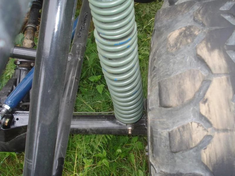

Chop shop I don't see any bump stops in there at all, or limit straps? It looks like your links might be hitting there on the driver side frame end stopping the up travel of your suspension. Is this what your using to stop the up travel before your tire crashes into the coilovers? If so, that is no good at all!!!! You need a bumpstop of some kind for sure, and limit straps. Also your waisting all of whats left of your shock looks like 4" of travel or so! Why, your tire is obviously in the way to get any more up travel?
I personally don't think it is a good idea for your tire to get so close to your coilover, I think it's a real bad idea.

My links dont hit at all. Its the angle of the pics.
The pics I posted were on my way to Bobbys to charge the shocks and I had yet to install any straps. It has limit straps and a limmiter on the diff aswell.
The tires DO NOT rub the shocks at all. This is a guess based on the pic of the truck when it was flexed on the lift with different wheels. It is fine now.
I do not have any bumpstops cuz its a wore out 22r, it will never jump anything. The coils are setup so the top coil is a 14 inch 100# and the lower is a 350# the top coils adjuster is setup to bottom out right before the top coil binds and then put the load on the lower coil ramping it up on the 350 rate quickly acting as a bumpstop of sorts.
The truck is setup to have about 6 inches of up travel. way more than enough. If you think an 18 inch shock should have 9 inches of up and 9 inches of down travel, then you have alot to learn.
with 6 inches up and 9 inches of droop that leaves 3 inches of shaft in the shock body at all times lowering the chance of a bent shaft.

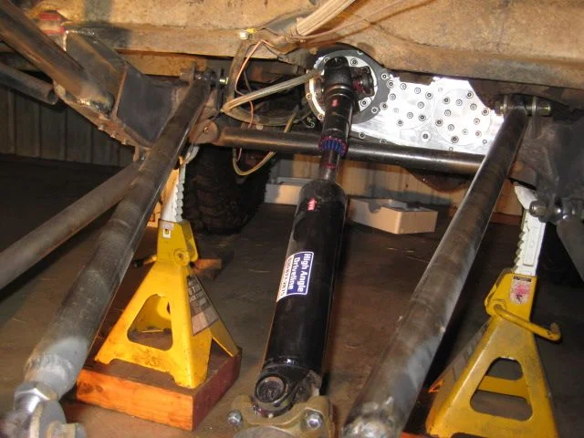

First shot is full stuff tire/shock clearance and second pic is full droop shock/frame clearance.
Third shot is when it was sitting on "full stuff" while building it. It clearly shows links clearing at full compression with an inch of shaft left, just enough for the shaft mounted bumpstops.

The first two are of the frame side uppers. You can see where I had to notch the body mount. The last one is the centerline of my axle, it gives me a ~24 inch driveshaft. It just happened to line up with that hole in the frame. Does anybody have any pics of their rigs at about this location with 35's so I can get an idea of what it will look like. So far I think my rig will look very similar to Nota Fn jeep's.
