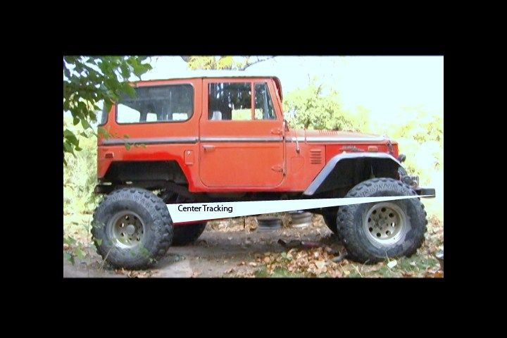

I have to agree here. This is why I chose to mount both my brackets lower on the frame, sacrificing ground clearance. By doing this it helped with the rear steer, as it lowered the center tracking. This allowed for the axle to be at the pivot point at ride height. So......., the curve it travels on, it gets closer to the t.case output, in both directions of travel. You have to imagine a vertical line drawn through the frame straight to the ground at the t.case output. As this is the point I'm measuring to from the axle. So..... as the axle twists it moves forward at both ends at the same time. This keeps it more square with the frame under articulation. If I had mounted them higher in the frame it would have raised the center tracking. This more than likely would cause the axle to move away from this vertical line when under compression. It would still get closer to this vertical line when under drop. So when articulated you would have one end of the axle further away and one end closer to this vertical line. When twisted the axle isn't square with the frame, resulting in rear steer. It is hard to explain any better than that, I hope it made some sense.
Pinon angle is very important as well, so in any case make your brackets adjustable. I wish I had made more adjustment in my lower brackets before I welded them on. It is a lot easier to see how it all works in reality than on paper.

Here is a quick representation of my center tracking as my cruiser is now. A good point of center tracking in relation to my frame was a top priority to me while designing it. As this is how the suspension travels in relation to the rest of the chassis.
I was also very concerned with good squat characteristics, and achieving the proper ride height to match my front "soa" shackle reversal, suspension.
