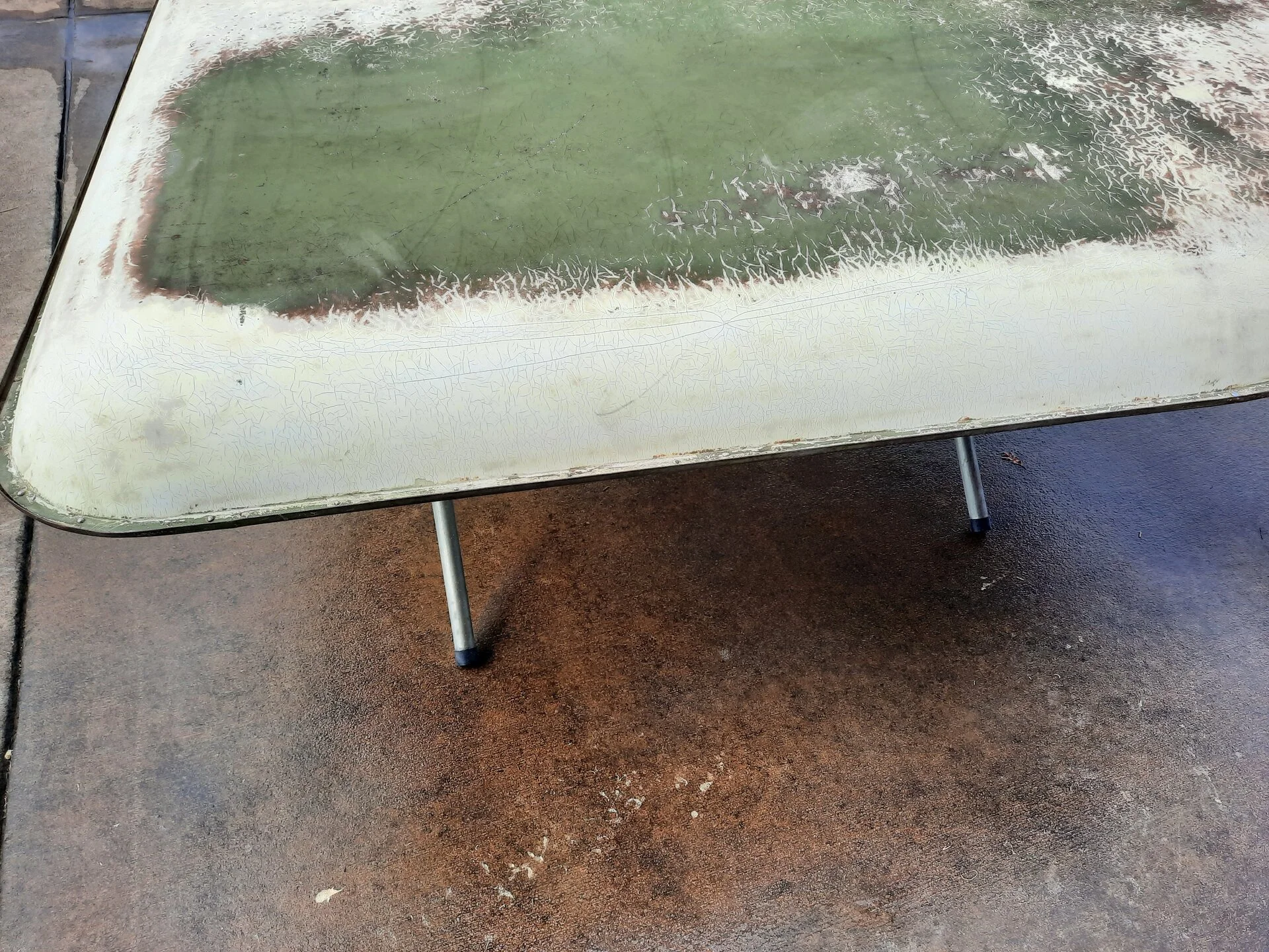

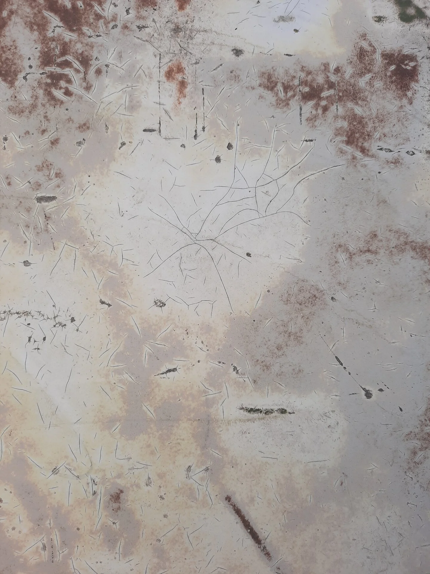

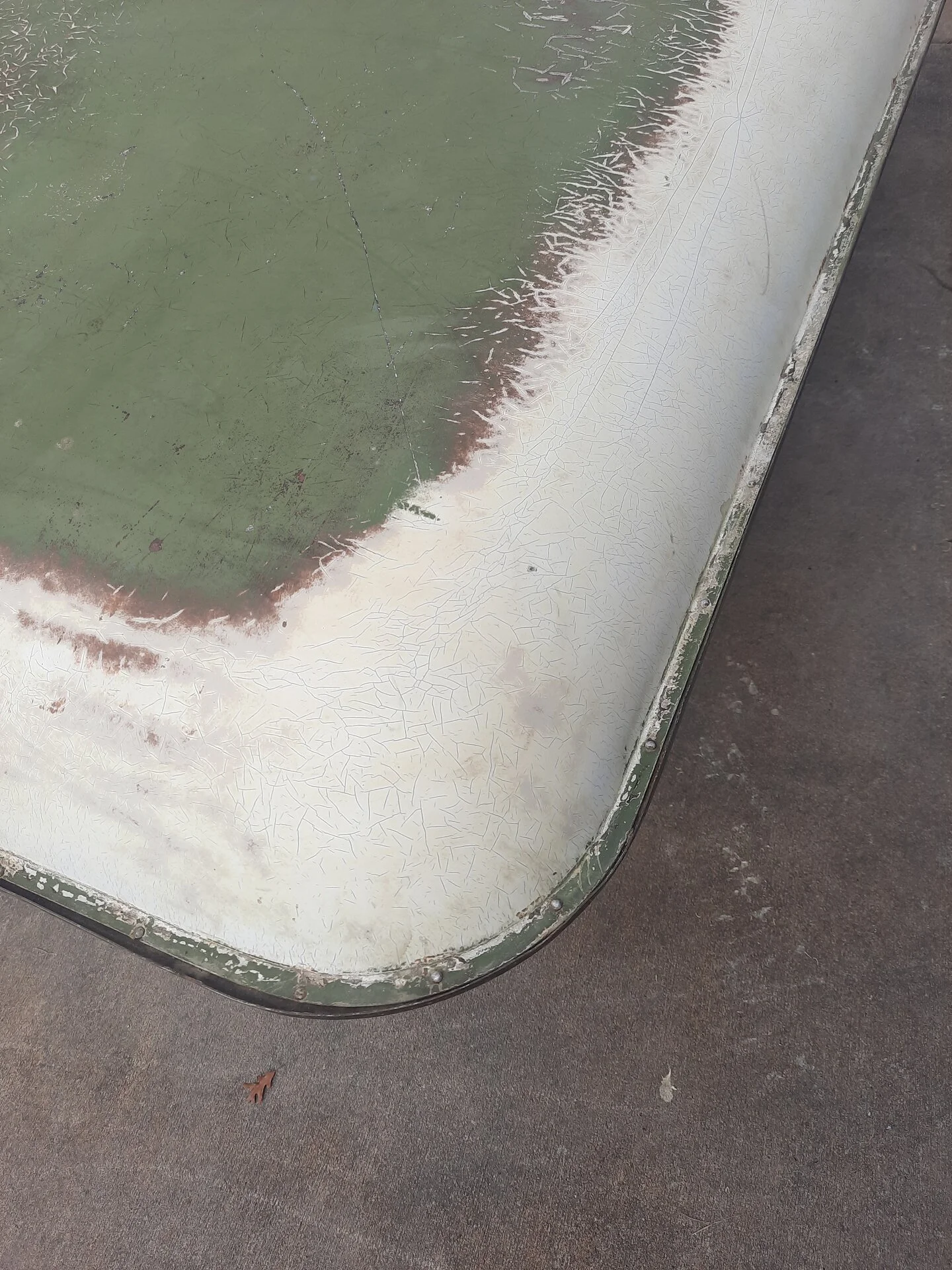

I'm just getting into the top repairs and the fiberglass is covered in spider cracks. I did some reading up and common repair is to take a Dremel to all the cracks then apply gel coat. There are so many cracks I think I am better of to sand all the gel coat off and apply new gel coat. Anyone have any experiance on this repair?
I sanded nearly all the gelcoat off, gouges eachbcrack with a die grinder and filled with fiberglass. Sanded that down then Coates with gel coat. Let that cure the sanded it and uses 2K primer to fill minor imperfections. Was a TON of work.
