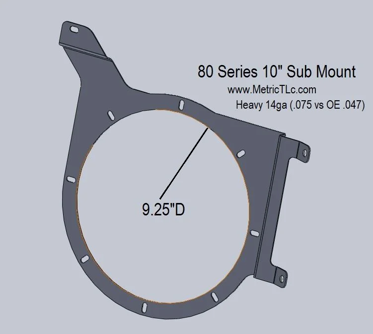

Feeler for Sub bracket Group-Buy
I am recently new to the 80 platform and excited about new parts and designs, so prepare for lots of new gear.
While writing my build thread I had mentioned that my girl had bought some sound gear and a 10" sub. I am NOT for boxes, so set out for a solution. I stated my idea and was asked to build it as a 10" didn't exist, so here it is.
This is for a head count on a small run of these.
-Speaker bracket that holds a 10" subwoofer shallow mount Free-Air
-9.25" opening, I search and search and this was the largest I had found, you must very.
-Will ship with foam block to isolate speaker from harmonics by isolating speaker and body panel.
-14ga galvanized steel for corrosion resistance and strength.
-Direct bolt in like OEM
The only change I may make is to drop a tab down 4" to attach a fuse block as we are looking for a place that is out of the way.
Will be under $100 ($80 if enough want it) shipped to your door, $16.00 is flat rate shipping USPS Priority

Damn I wish this was available a couple weeks ago. I bought a 12" infinity sub (nothing reproduces the low end of rock music like a 12" woofer) and put it in an entirely too big box taking up too much room in the back. Sounds freaking fantastic though. :)
Is this only for the toyo 80 series?? I have an LX and there is no way I could fit a 10" in the oem sub housing....
I have mine disconnected, but I believe it is 4."

I tried every way to get a 12" to fit without having another leg, just wouldn't work so 10" it is.
...also when u say "free air" are you referring to a ported sub?

Free-Air meaning the sub does not need a box to perform. It's designed to be mounted anyplace with a box or enclosure.

I have the WholeHog one now that has been installed but the selection for 8" subs has been lackluster. I do like the added space for the amp though. What I really want is a new cargo sheet metal that hugs close to the quarter but gives the entire cargo width worth of mounting to add everything from an inverter to amp to sub to fusepanel to circuit breakers to whatever.
If you are going basic then this would be good. Just large enough to add the BlueSea 5029 Fuse Block.

I would be down with a speaker bracket for sure.
What about a larger bracket that allows mounting an inverter, amp, air pump, etc. above the wheel well?
Working on it now.
[/QUOTE]
If you are going basic then this would be good. Just large enough to add the BlueSea 5029 Fuse Block.[/QUOTE]
Adding it into the design and adding a 4th attachment location to prevent vibrations.
It's an either one at this point. The 10" sub takes up some space. I will do a mounting plate that huge the body and allow for endless mounting solutions, other than a speaker.

After several PM's and posts wanting a place to mount their Blue Sea fuse black and other bits, I thought this out a little. I added two more mounting locations at the bottom for a total of 5. this should end all vibrations and make for a solid platform.
Second choice is, I will remove the speaker and make a mounting face that is 3" in at the top and 4" at the bottom for roughly 15" tall mounting face. with the same 5 mounting holes to make a sold platform.
-We now have
-Speaker and with mounting platform
-mounting platform for all your electrical gear (no speaker and not shown)
