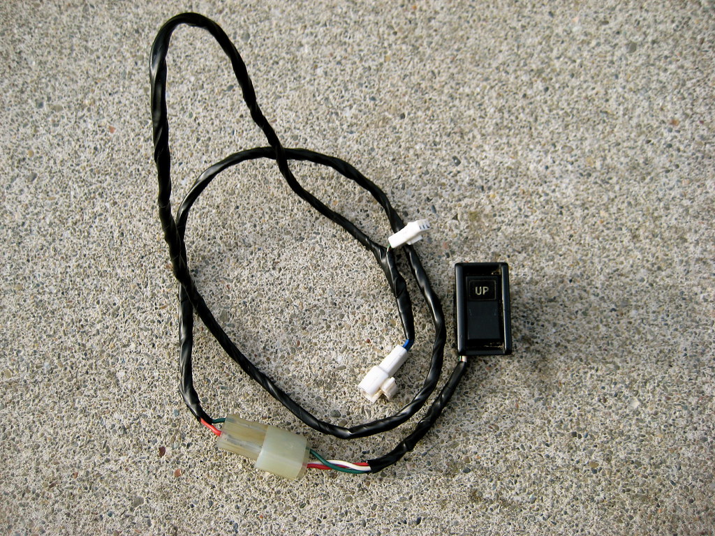

1990-1993 4Runner Interior Tailgate Window Switch and Conversion Harness
Why do this?? Read Me... It's an improvement on this idea using factory parts and a cleaner placement and appearance.
**If anyone's interested in one of these I'm putting a list together once a price is decided on. *The parts/supplies* go for roughly $30 plus my labor and shipping fees, what would people pay? $55 too low/high? ($30..Switch ~$15 Plugs~$10 Wires-n-Solder~$5)
*Parts* 1990-1993 is one type, 1994-1995 is a different type, so price may fluctuate. (Of Connector at the lock.) I would need to know for sure which connector your lock switch has first in order to do the piece.

I like the idea. (In fact I have gathered all the pieces to do just this.. :D) Is that pictured harness just long enough to be mounted in the tail gate? I think a gate mounted switch might turn some people off because of possible damage while using the truck for other things... I know that the tail gate is the easiest place to do a complete plug-in mod like this though.. My plan was to cut into the harness on the drivers side and put my switch near the stock light over the wheel well..... Out of the way of damage by whatever crazy thing I use my truck for in the future.... :D

You'd be putting one in like Corax has, in the side panel then, and that's fine for the first and 2nd gens, for the side panel only. On the 2nd gens the light is overhead and centered, where I initially wanted to try and fit it, but the wiper motor and linkage interfere and could cause wires to be cut and shorted out.
FWIW..as I said in another forum, it's live all the time as it's spliced in with the lock harness and the instructions I'm planning are to place it just to the passenger side of the handle, inset in the carpet and held by the mdf board. (Cutout the carpet, then cutout the board, and a little bigger cutout of the impact plate so the switch is recessed and protected from accidental use.)
Unless you go around beating up on it with gear it shoud be OK, and I can also make the adapter for placing on the side panel just as easily, the only issue there is the material needed to properly secure the switch is not there and you need to shim stack it.
There's enough wire there to plug it together, and using 5 zipties and the factory holes and options, it's all secured and safe.

Without putting too much thought into it, I would probably put the switch in the rear wiper motor cover (in my 85 4Runner). There's plenty of room inside, it's up high which keeps it out of the way of cargo, and it's easy to access from inside. It's also not difficult to run wire up there but you will need a longer run that what is shown in your prototype.

2 problems with the suggestions are the availability of those parts for the 1st gens, and of course, the willingness of someone to let me tear into their vehicle.
Now as for the front switch bypass, well, making the rear window into a hot switch is one thing, but by making the front controller hot you also enable all the door windows hot, and that defeats the window lock switch, which, if you have kids, is a valuable safety control, thus why I figured out the car alarm fob method, so the driver is the only one in control of that set of options. Any car alarm, for example the ones with that and remote start can be integrated. We just didn't hook up the remote start since the beta test vehicle had a clutch.
