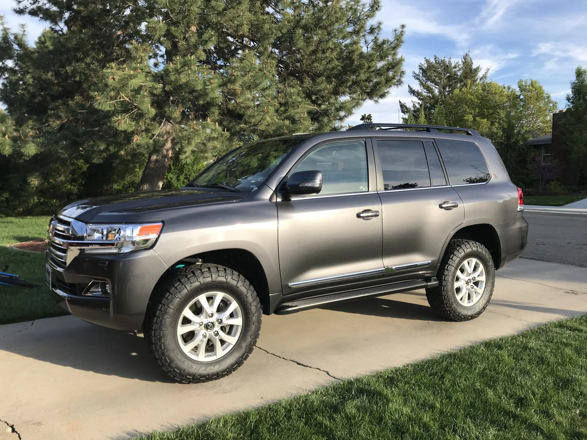

Lift-
Dobinson
C59-542 front 2” springs
GS59-688 front shocks
C59-545 rear 2” springs
GS59-682 rear shocks
1/4” front strut spacer (1)
SPC UCA
Tires-
285/70r18 Ridge Grapplers
Bumpers-
Stock
Amount of lift-
Front 2”
Rear 3”
Advantages / disadvantages-
Still rides smooth and quiet
2k installed
I’ll drop down to the 535 springs In the rear if it doesn’t settle. Have to load 200lbs in the back to get into the garage.
With removed mud flaps, I’m only rubbing on the KDSS bar drivers front when reversing at full lock.
1.25 Bora spacers on order
Did the spacers solve the rubbing issue on the KDSS Bar?
