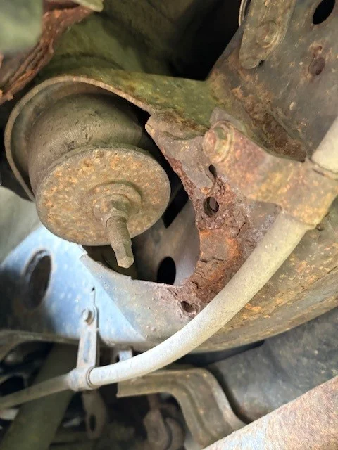

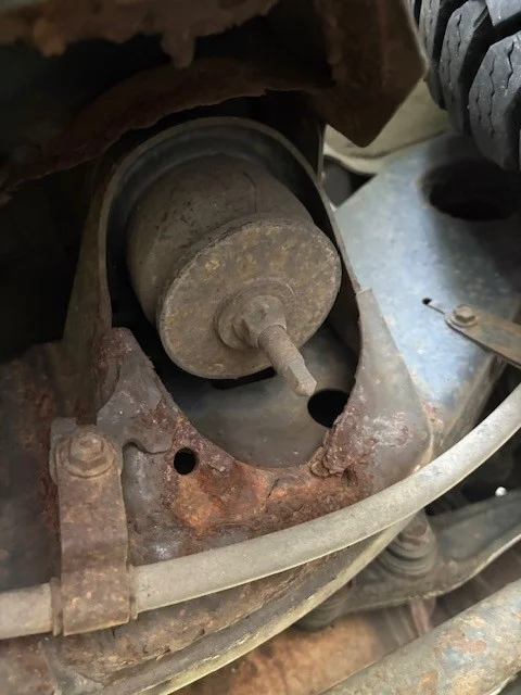

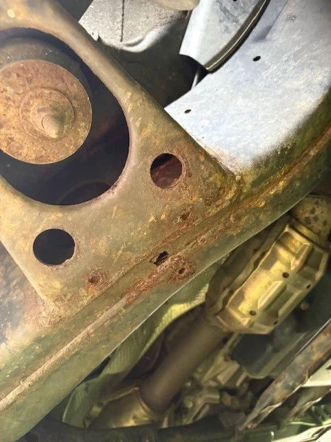

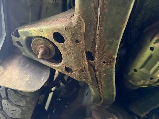

Would like for any to comment their objective thoughts on whether you think this is worthy of being failed for an inspection due to too much rust? Tried to take the best pics I could, especially of the "worst" areas I could find. Would especially like to hear if anyone else has had any frame rust issues/trouble getting it passed for inspection? I see a lot of questionable cars on the road, and not sure that this qualifies. Body and mechanical is otherwise in fantastic shape. (Located in VA, for those wondering where the inspection is taking place/I know some states do not require. Model year 2009) Thanks.
We’ve seen worse posted on here, but that first photo is pretty bad. No inspection in my state, so I’m not familiar with protocol. Any chance of doing some treatment before inspection?
A frame shop should be able to fix this with fresh metal. This is a pretty straightforward fix. Definitely would fluid film this going forward.
Already failed, which is how it came to my attention. Any recs on best way to treat?
Rattle can flat black paint and then find a different shop to reinspect. I lived in VA for years… some shops use a microscope and some will honk the horn and flash the lights and slap a sticker on you. If you’re anywhere near Manassas I can recommend a shop that used to be easy to go to…

Appreciate it. I am thinking something similar. may get that one spot fixed for peace of mind and then just spray the rest to keep it from spreading further. In Cville, so prob 2 hours south of Manassas. The shop I went to used to be great, but I think they possibly got in trouble, because the last 2 times have been hell with inspections. On my other car, told me I needed pads and rotors and quoted me $1100. I did it and pulled them myself and the pads had 60-70% left. Just replaced all parts anyway to the tune of $90 and got the sticker. Shame on me for giving them a 2nd chance...

Most Eastern Sates will fail you for any "rust created" hole in the frame. No matter the size. I lived in PA for a while and had a fab shop as a client. They did a ton of Toyota frame patches to get people through inspection.
Thats an easy fix. Get someone to patch it and get reinspected.

Yeah, they couldn't do the frame repair, but rest assured they had a laundry list of what items they could help with. They asked if I wanted a quote and I told them I'd pass.
Good to know. Any thoughts on a range (rough estimate) would be to get something like this repaired? Thanks
