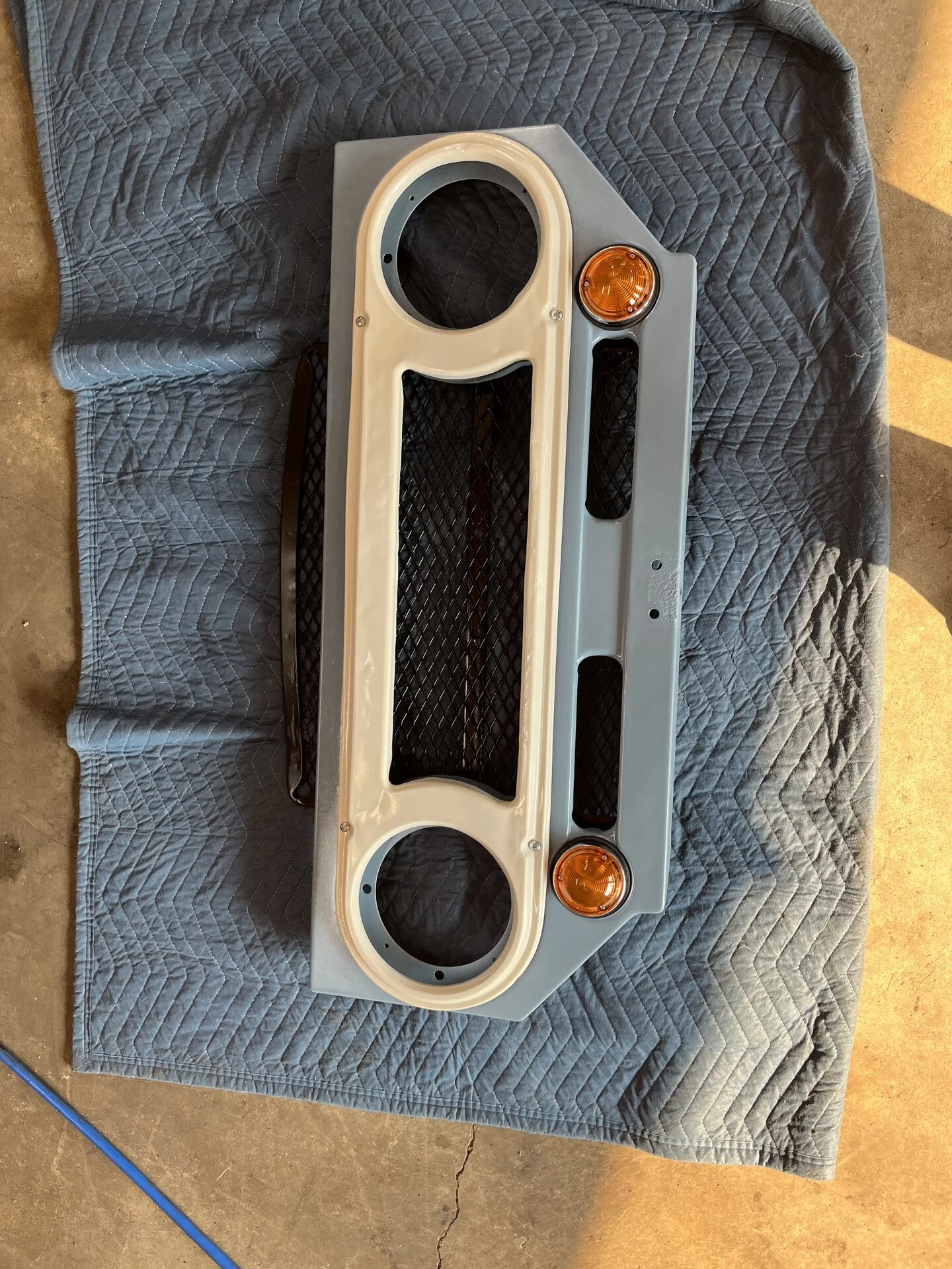

I had my local paint shop mix a quart and put in aerosols. Turned out really close. Capri blue. The bib, floor and tunnel are all what they mixed
It was $65 (or $85?) for the paint, then $18 per aerosol can. I got 4 cans. So $150 ish.

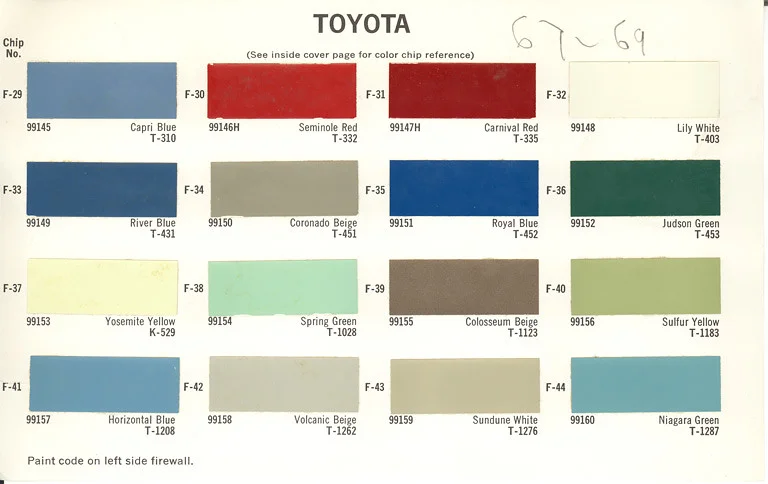

Looking for third party confirmation that Capri blue (as seen in the photos above) is code T310????? I ran the code and it's displaying what I know to be "Cadet Blue"
I'd say T-310 is the authentic code for Capri blue..
EDIT:
Note that somebody wrote "67-69" on this chip sheet. The note "paint code on left side firewall" was only true on later models, not my 1973 for certain. It was horizontal blue.
Please have a look at link below which shows the horizontal blue. My research was not able to determine when capri blue and horizontal blue were offered, or even if they overlapped in some manner.
The difference between capri blue and horizonal blue is that capri blue has a slightly grayer tinge.
EDIT:
Thanks for the response with the paint chip, however this highlights the issue I had that the paint shop. T310 Capri blue in shops, matches my truck. But the nomenclature for the truck that I own would be considered horizontal blue. In any event, greatly appreciated. Color code changes from 50 years ago... what are you going to do. I guess I'll machine match it and shoot the truck; I'll have to save the mystery of 50 Shades of Toyota Blue for a rainy day. 😂
