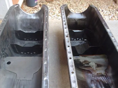

Any way - I finally got out of a project to start on the 40 and the first thing I did was remove a smashed oil pan from a 2F and the good one from the F. Posted are the picks of the difference if anyone cares to know what they are exactly. All due to the oil pump.

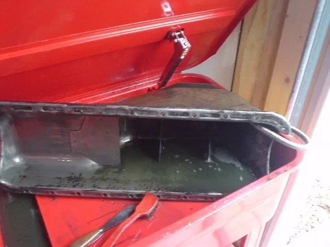

I cut a cardboard template and traced the outline on the two baffles that needed to be modified and went at it with the Dremel. It was tuff cuz there is little room but the finished product will work I am sure, place the F has some holes in the bottom of the rear baffle that look like they may make the motor happy.
Close up of the 2F
Close up of the F
The F notched.
I hope that somebody finds this useful.

Uh, my 2F pan looks different than either one of those.
Really? Must be differences varying by year. What are your differences?
They do not have the baffle holes in them. They are welded on the sides and the front one is open completely on the bottom. Meaning that is is not welded at all on the bottom.
Guess Toyota is always trying new stuff. Thanks for the description.
