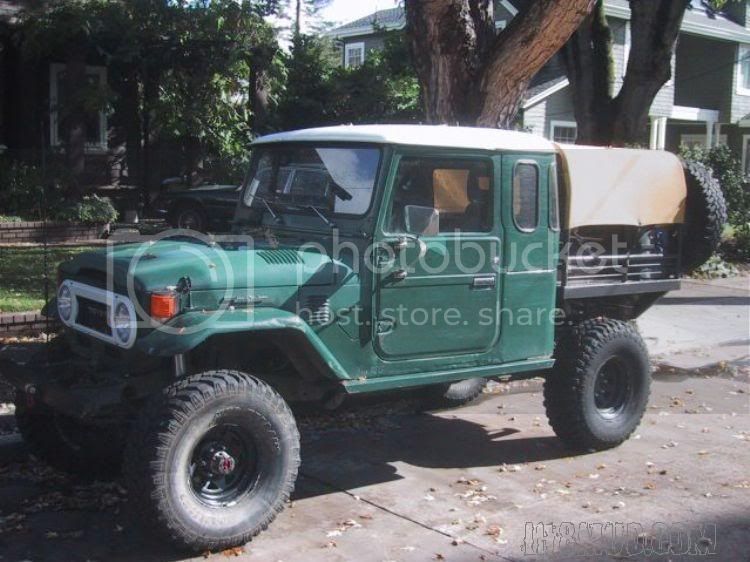

Kurt Grasso' s FJ45 ext cab
Some of my favorites.
I cannot seem to find the picture of the white one with the Wolf alarm system.
Dan, The white on in post #12 is the same one as the one with the "wolf" alram. He has two different sets of tires for it. sbc 350, factory 4spd, fairy overdrive, stock case, limited slips front and rear. He built a blue one first if you have ever seen that one.(it was in an old Toyota trails) Some guy offered him a boatload of money for it. He sold it and then built the white one. I saw it my first year at GSMTR, he came in and camped right next to me. We did not have to worry about bears in the campsite with that wolf there, that thing was HUGE! The 45 was not small either.
Kurt used to live up here in Va but now I believe has moved to Georgia. He has a airplane buisness, buys sells, repairs. He had a airfield up here and a great shop with all the machines to make his own parts ect. I think he dabbles in old Jaguars as well. I have a few pics of the white one buried some where I will see if I can dig them out.
Rob
