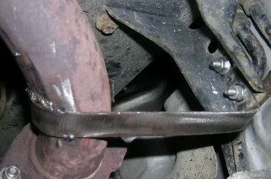

I am dealing with your very problem right now. It seems the PO banged the cat (Should have noticed from the dent in the running board [now off]) which also destroyed the rear mounting bracket. Anyway, I removed the bracket and cut a 1" by 11" piece of 16ga sheet metal and bolted it to the mounting point and bent it down and around the pipe and tack welded it to the pipe (so if the weld breaks at least it's still held in place until I can re-weld it).
- OK, so I replaced the gaskets, but noticed alot of metal loss between the flanges (possibly from long time exhaust leak?). After putting it all back together, it was still leaking (5 minutes ago:frown: ). Also used stainless steel bolts to save grinding in the future.
- SO, my solution is to remove the cat again and grind down the mating surfaces so the gasket will be crushed (not too hard I hope) and do its job. Funny, I have a 25yr old FJ40 that had less wear around the cat than my 97 LX450.
Pictures follow:
Cat with gap (shiny bit is gasket)
Exaust hanger
