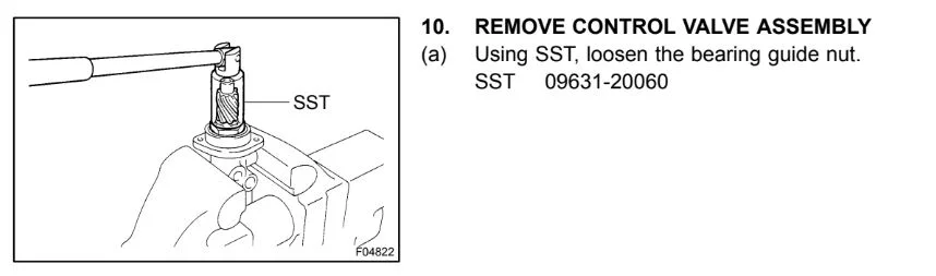

Anyone know the tool/part that allows the remove of the reverse nut in the contral valve?
Can't see what is in your link but all the tools needed for the job are listed with their part number in the FSM.
Doesn't this video show you exactly the what you'll need to get the R&P open up?
@medtro , as always really appreciate this forum... not sure how i spaced on that. Desert heat and between the reindexing of my tbars and dropping in this new rack/pinion just didnt come to mind.
