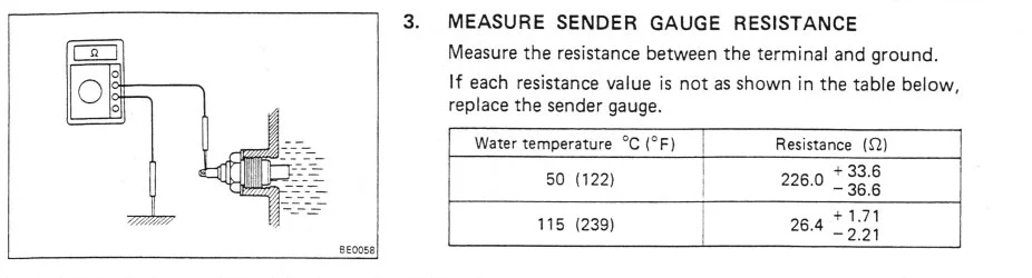

Check your temp sending unit too. I fought an overheating issue driving from CA to VA, replaced the entire cooling system along the way, when i got home figured out it was the sending unit.
  • Like
Reactions: M P
Easy enough to ohm test the sender. This on a 2f ...not sure if it's the same for a 3fe
