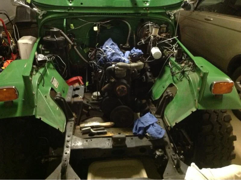

Thanks to All!!! I think I'll go w the 2 ton. Now I'll just dig into CL and find me a used one. I'm sure I'll find a good "used once" deal. I share some pics of my job as I go. :)
