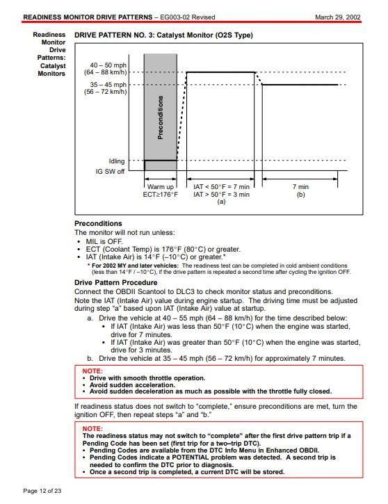

Had a similar issue with mine here in ATL after a battery replacement. Follow the FSM drive cycle guidelines EXACTLY to get it to clear out. Took me a couple try's but ultimately was successful.
Here is the drive pattern up to 2002:
Taken from Toyota TSB "READINESS_MONITOR_DRIVE_PATTERNS_T-EG02-003" (google this to find the complete TSB).
