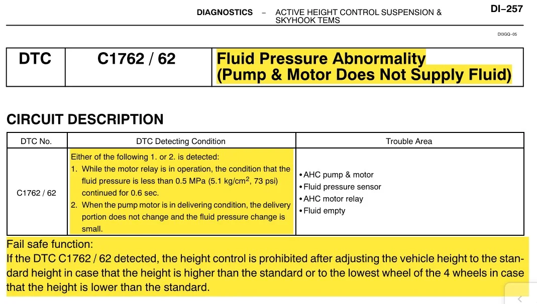

There can be various causes of the "Fluid Pressure Abnormality" Diagnostic Trouble Code (DTC) C1762. By far the most is common cause is when there are large quantities of air in the AHC/TEMS system. Other causes can include partial blockages of the strainers inside the AHC Pump or incorrect operation of the Return Valve.`
The point is that the response time of DTC C1762 is very quick -- about 0.6 seconds according to the FSM extract immediately below -- at which time the Suspension ECU initiates the "Fail Safe Function" defined below. This prohibits the Height Control function, meaning the ECU prevents operation of the AHC Pump, and, meaning the ECU may cause the vehicle to drop to the level of the lowest wheel.
The fix procdedure described on the second page of the full FSM extract for DTC C1762 attached below is similar to the Active Test, except that the instruction is to start to bleed with the pump motor operating. This would mean that the ECU causes opening of the Levelling Valves in the Control Valve Assembly to allow AHC Fluid to pass to the open bleeding screw(s).
However, experience shows that this procedure does not always work and the defined "Fail Safe Function" repeatedly stops the AHC Pump after ~0.6 seconds.
When this happens, the repetitive effort described by @TXLXAG in Post #2 is the practical workaround.

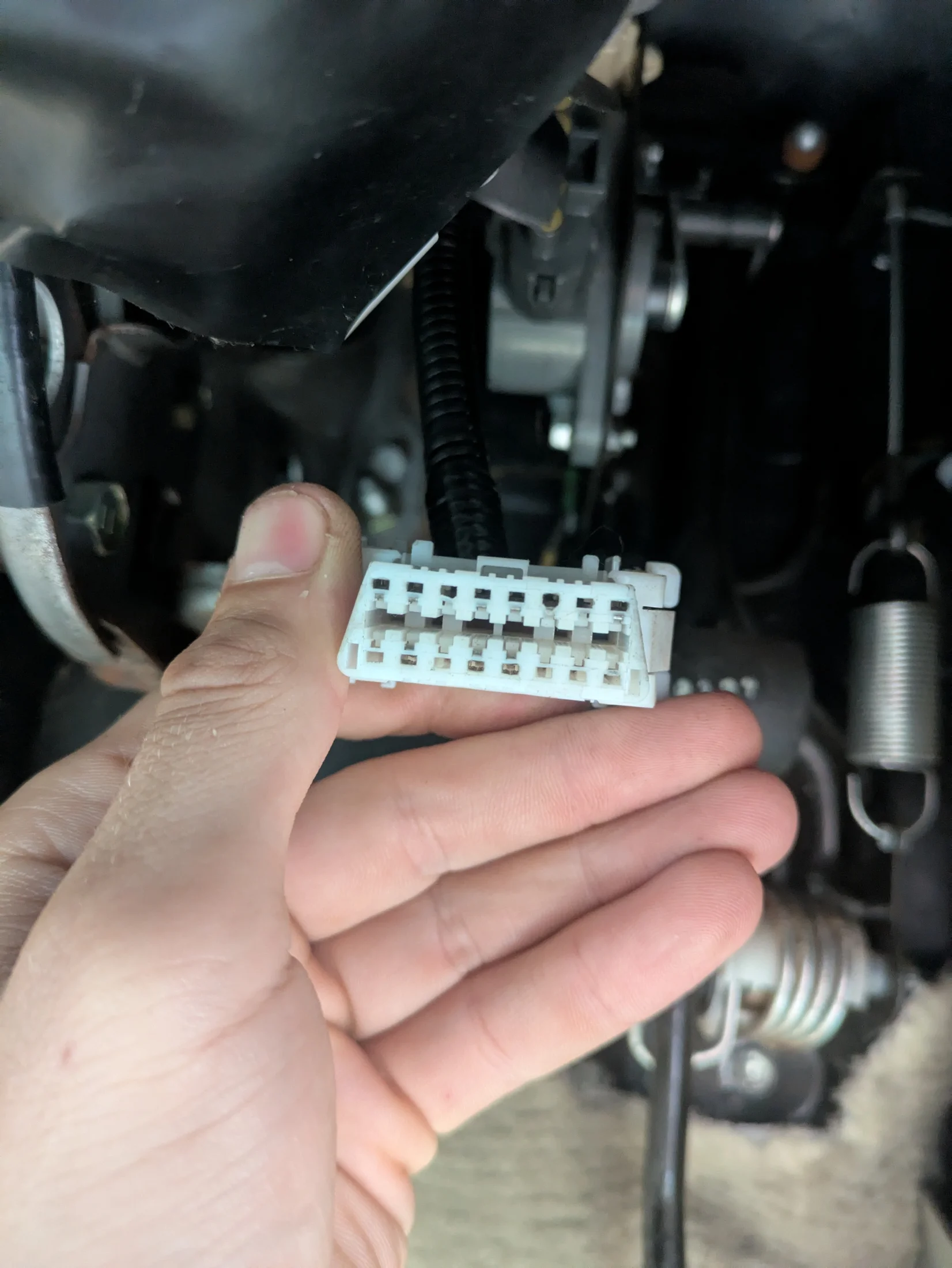

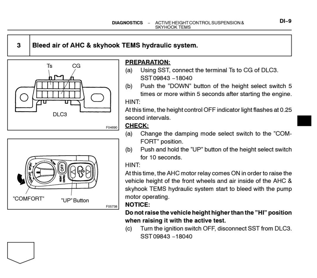

Worked my way through steps 1 and 2 of DI-9 all fine no issues got to step 3 "bleed air out of ahc and tems system"
Looking at the DLC3 port on the top row working left to right the TS pin should be the third along? However there's no pin in the third position from the left. What am I missing here?

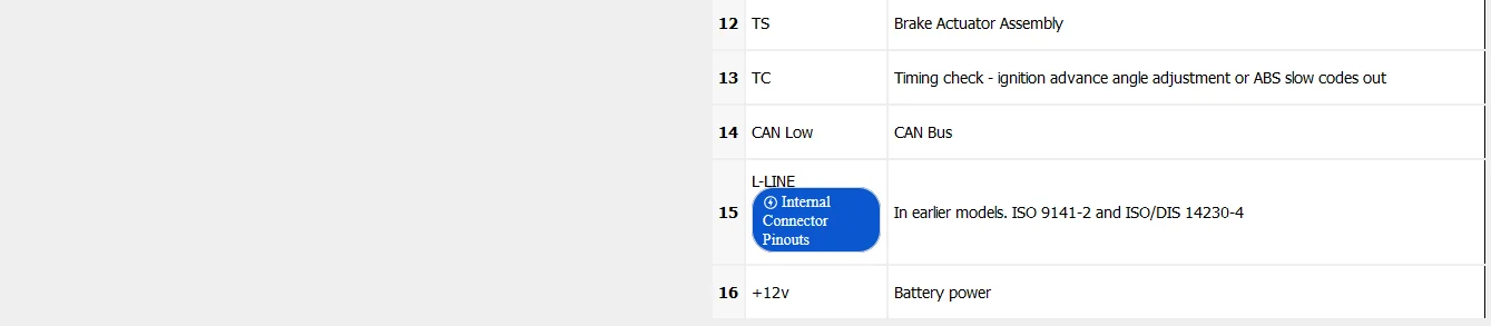

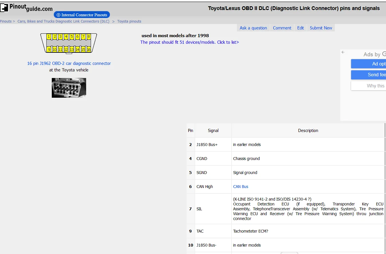

It's late, and I may be sleep–typing, but aren't you supposed to use the DLC1 terminal, on the engine side of the firewall?
Most tests do. However this particular test from the FSM suggested by @IndroCruise uses DLC3 hence the ask.
Then he means pins 4 (chassis ground) & 14 (CANbus)
Most tests do. However this particular test from the DLC3 suggested by @IndroCruise uses DLC1 hence the ask.

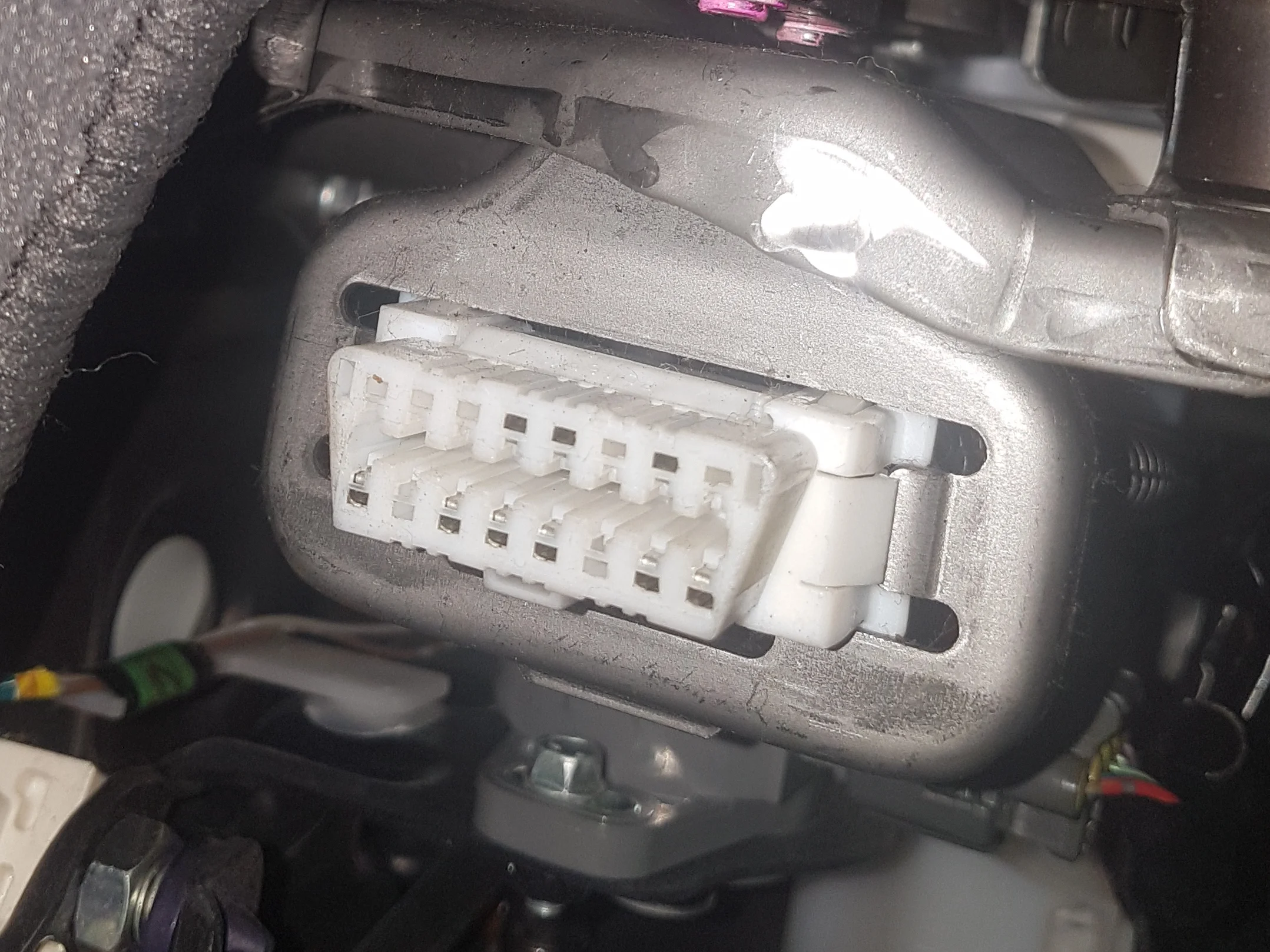

The DLC3 under the dashboard of 2006 LC100 RHD with AHC and 1HD-FTE vehicle delivered in Australia is as shown below. It appears to be in order and is suitable for test connections -- although I have had so much trouble achieving a stable connection to the 'unofficial' versions of Techstream that I gave up and resorted to other kinds of scanners capable of reading the Suspension Electronic Control Unit (ECU), as needed for AHC pressures or other diagnosis from time to time, using DLC3.
For convenience and relevant test purposes, I prefer to bridge between Ts and E1 at DLC1 in the engine bay, knowing that this provides equivalent ECU connections as the FSM bridging between Ts and CG at DLC3 as noted long ago by @PADDO at

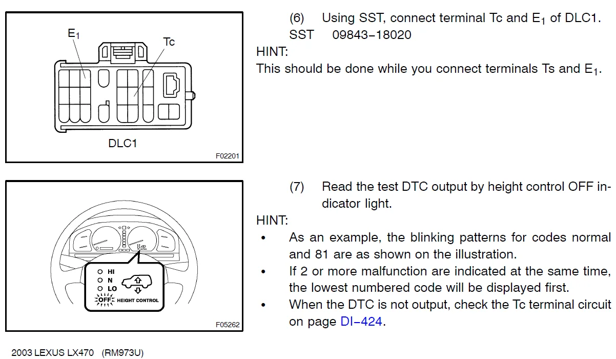

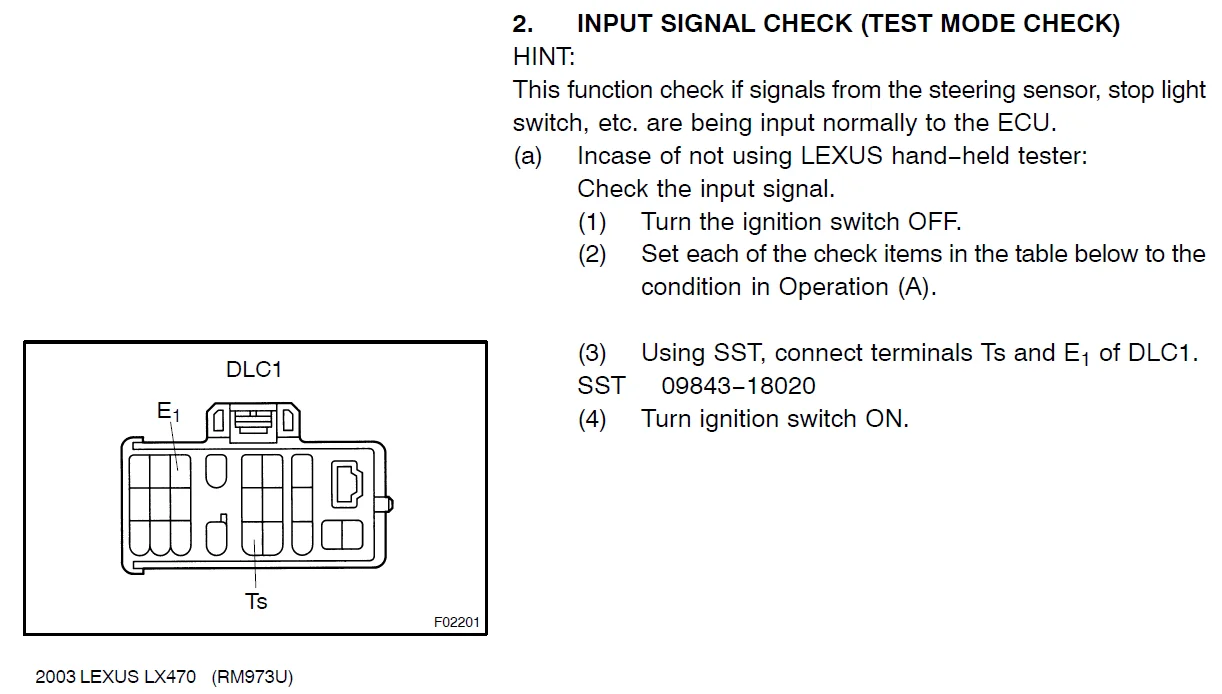

This is from the 2003 LX470 (USDM) service manual [the UK service manual may be different]:
and so on. I'd be very leery of shorting the CANbus terminal to ground (using the DLC3 connector), if you do not know what you're doing. The CANbus is a network; every electrical system on the truck is connected to it, and every node has to work.
This is the downside of the CANbus architecture for automotive use. For industrial use, it's great, becuase when you have a fault, everything shuts down, and you know there's a problem. No one gets hurt and there can't be any snakes in the woodpile, waiting to bite you when you're not looking. I'd personally rather not have my truck wired that way, but no one asked me.
View attachment 3986399View attachment 3986401

Thanks @Malleus -- that's very useful and has given me cause to do a bit of research and strenthen my hazy knowledge of automotive CANbus ('CAN' being Controller Area Network and 'bus' being the two-wire shared connections to multiple components around the vehicle -- as I understand or misunderstand it).
Your images at Post #12 are like-for-like, page-by-page, with the extract I have offered previously (attached again for clarification), as posted on this Forum long ago by @PADDO -- and which I believe he also extracted from the 2003 LX470 Factory Service Manual for the US Domestic Market (USDM), although @PADDO also had Australian connections as denoted by his avatar.
To that extent, all are "on the same page" concerning connections and procedures at DLC1 -- and which I prefer.

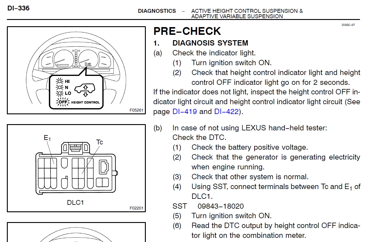

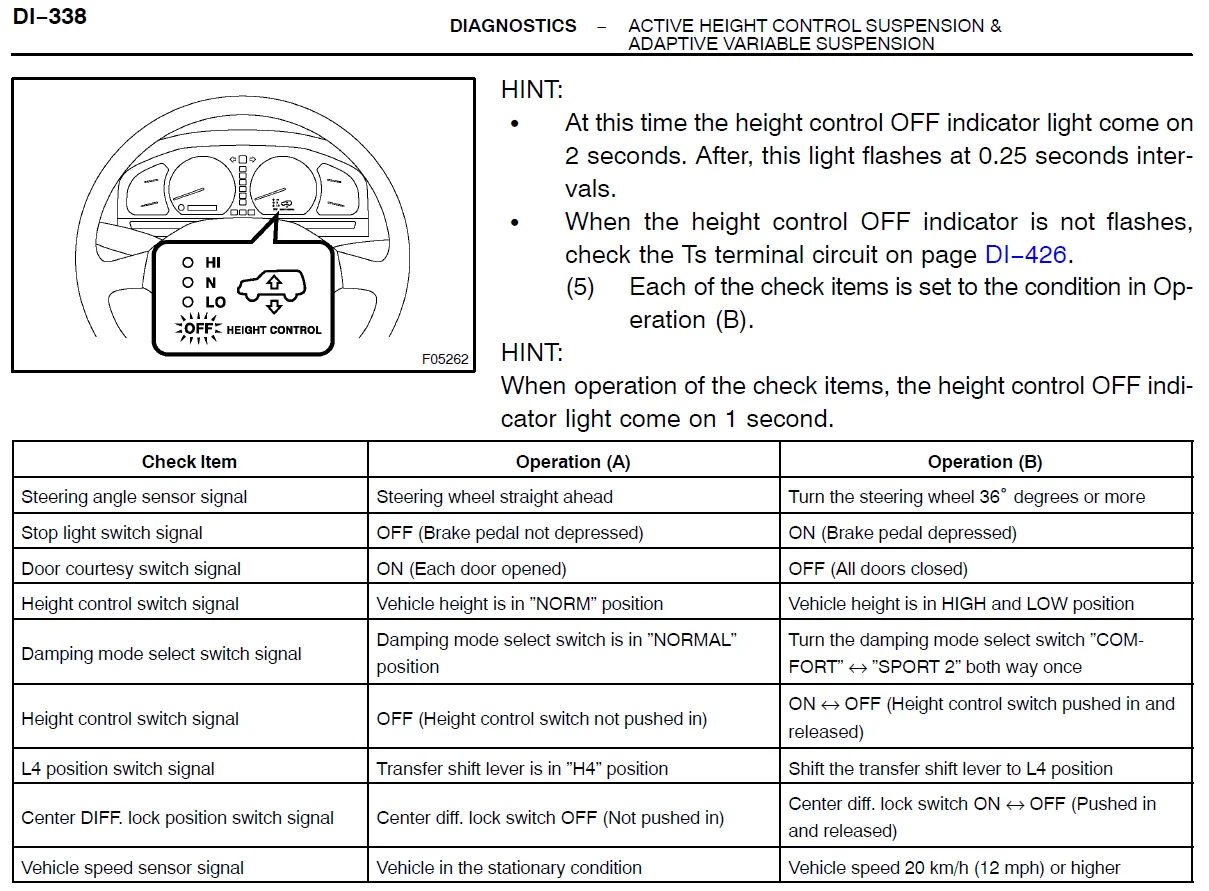

Then going to the online version of the LC100 Factory Service Manual which is published with the header TOYOTA OVERSEAS CUSTOMER SERVICE TECHNICAL DIVISION -- found at HOME | LC100 Factory Service Manual - https://lc100e.github.io/ -- and used by many IH8MUD Members around the world, the same test procedures are found, but using specified connections at DLC3, rather than DLC1. Two examples follow below:
-- using Tc to CG for Pre-check - Diagnosis System:
-- using Ts to CG for Height Control Operation Test (Active Test):
