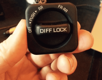

Definitely not a $400 solution, but we offer an internally actuated, 4-pinion electric e-locker option new in box with all required bits - even a new OEM 2-locker switch as a thank-you.
