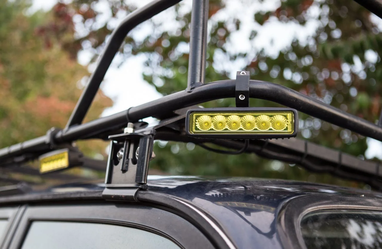

New perimeter lights

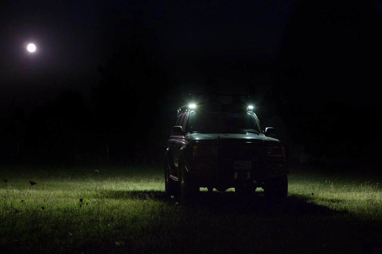

Coverage, nice camping light without creating light pollution.

Way cool. How'd you do the wiring? Wonder how I could do a similar setup with my prinsu rack... :hmm:
I ran a single 10ga wire from the engine compartment through the fender and up the driver rain channel. I ran two 12ga wires the same way up the passenger rain channel. The 10ga is the ground and the two 12ga give me two independent light circuits.
