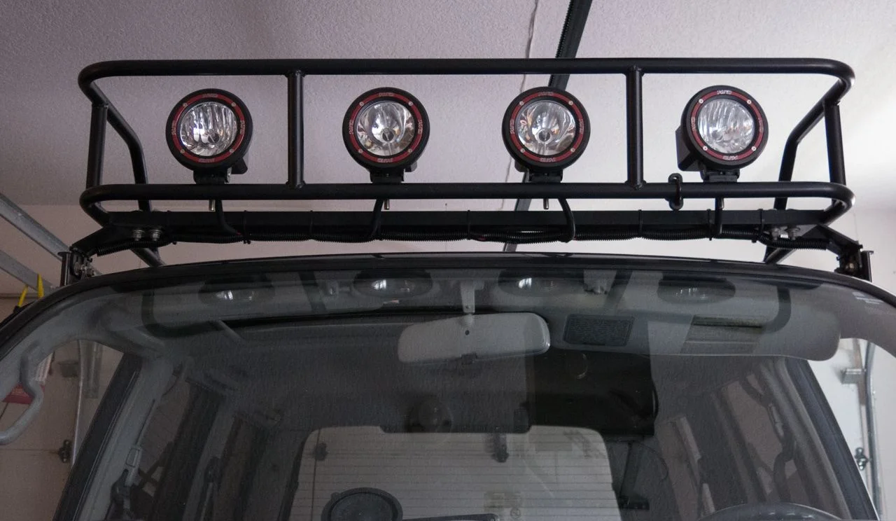

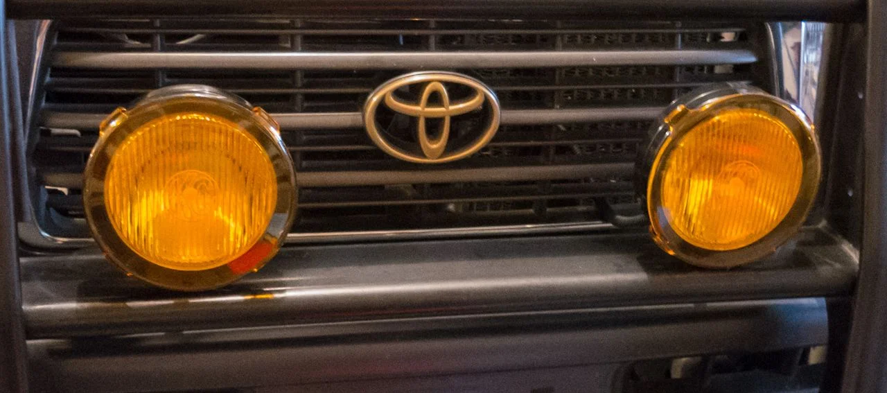

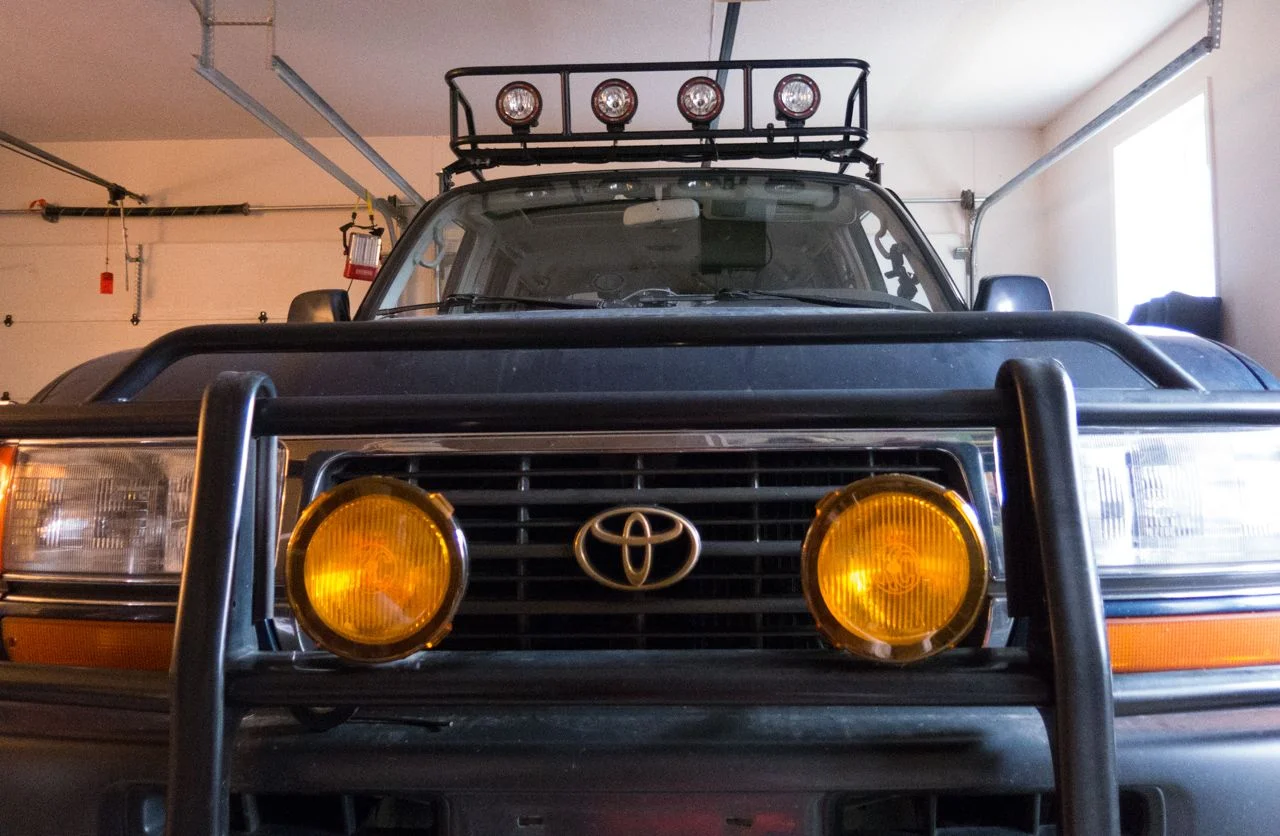

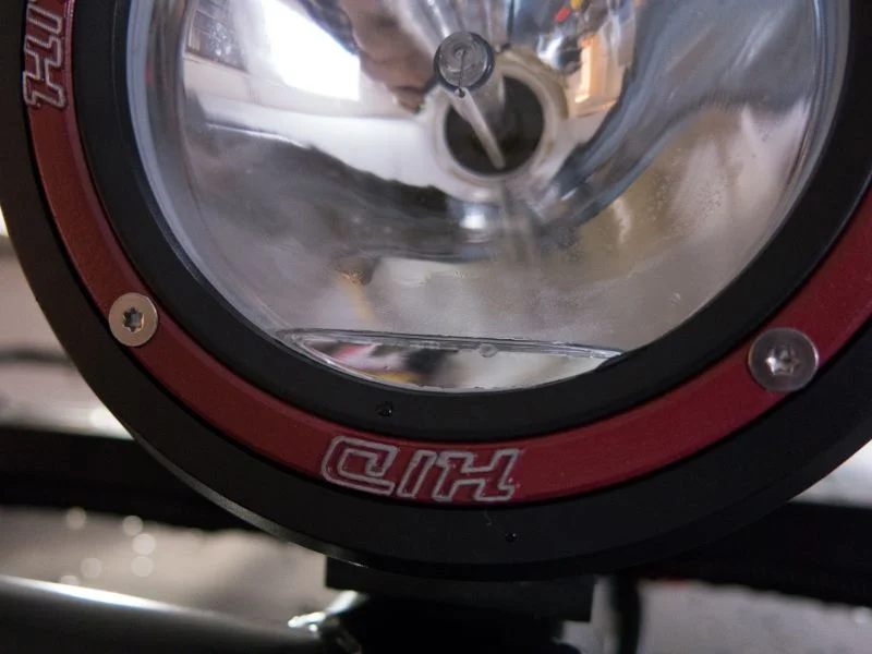

I finally finished wiring and installing the lights today. So much work from the new switches to the heavy duty wiring up to the roof rack. I went with some inexpensive 4" 55w HID lights, two spot and two flood. I wanted to put 6" lights on top but they just won't clear the top bar. It is exactly 7" from the mount to the bottom of the bar and most lights I saw were 7 1/4" with the mount. Should I change my mind later the wiring can handle 4 x 100w. I also finished the upgrade of my KC fog lights. Completely rewired the lights using 12ga wire and ran separate relays for each light. They put out a lot of light with the 130W bulbs and the amber covers are great for the fog.

Time to tear em apart and re-seal. If you care to or it's worthwhile.
Nope, returning them. I get crazy spill from them down in the windshield and dash. I also noticed a lot of wind noise on the highway. I'm rethinking roof lights. I'd love to find some small projector type lights. The stock headlights are great on the 80 and the KC fogs put out a wide beam from the ground out to the center of the high beams.

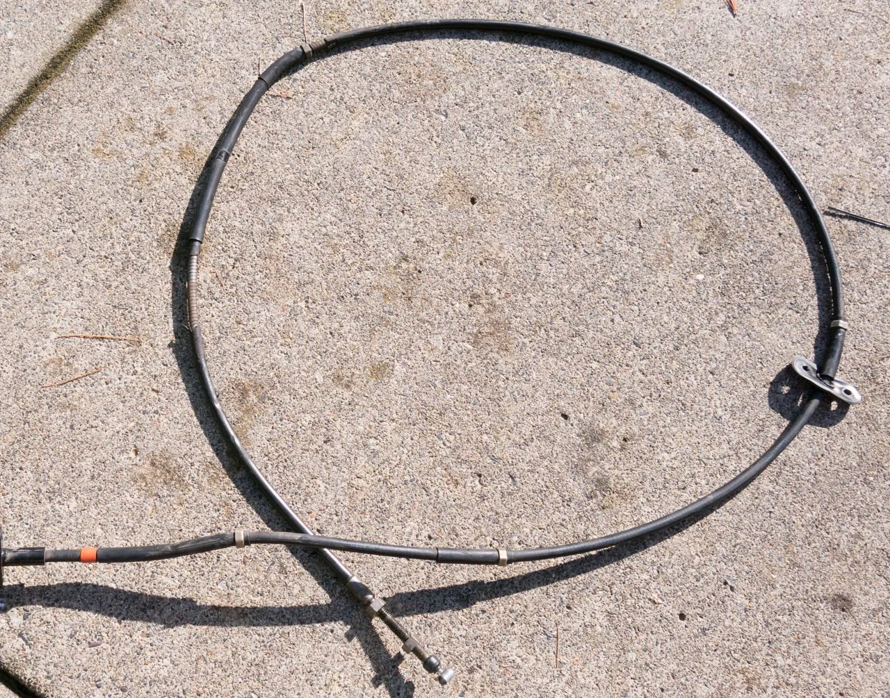

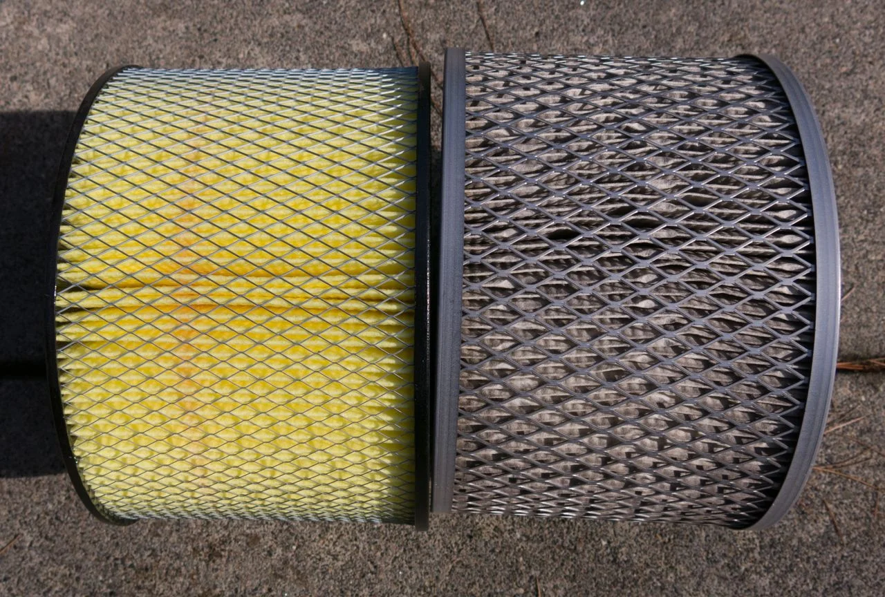

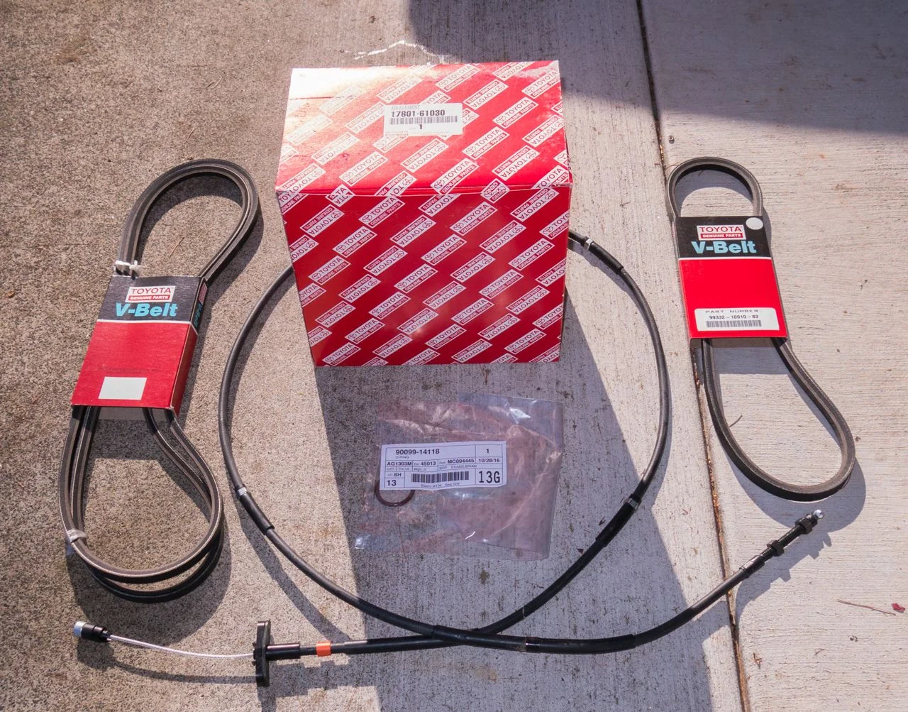

I got around to doing some upgrades under the hood. I replaced the air cleaner, original throttle cable, leaking distributor seal and the standard high and low beam lights. I can now feel the gas pedal while driving, no more lead foot driving. I checked the timing before replacing the distributor o-ring. It was 4 deg before shorting the E1 and TE1 terminals and 3 deg after. I never got the CEL to flash but there was a definite change in timing. I upped the timing to 5 deg which came out to 8 deg in normal mode. The bottom end really came alive however I did get pinging under higher RPM load. I dropped it back to 4 deg base and 5 deg normal with no pinging. I may bump it up again with some higher octane gas and try again. I'm not sure why the ECU is adding so little advance in normal mode at low RPM. No CEL codes and the vehicle runs good but does have an occasional miss at idle. The plugs, wires, rotor and cap were replaced before I purchased it and look in good condition. I did a seafoam treatment and it seems to have made some improvements. Another oddity I have noticed is the engine needs to crank for 2-3 seconds before it starts(warm or cold).

No amount of lube would help this cable.

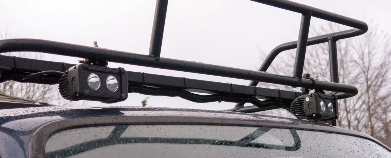

It's been a while since I've updated but I haven't stopped the upgrades. After I returned the water filled HID lights I found some cheap 20w LED spots that do well on top. They don't have the wind noise as the other lights and don't reflect off the windshield.

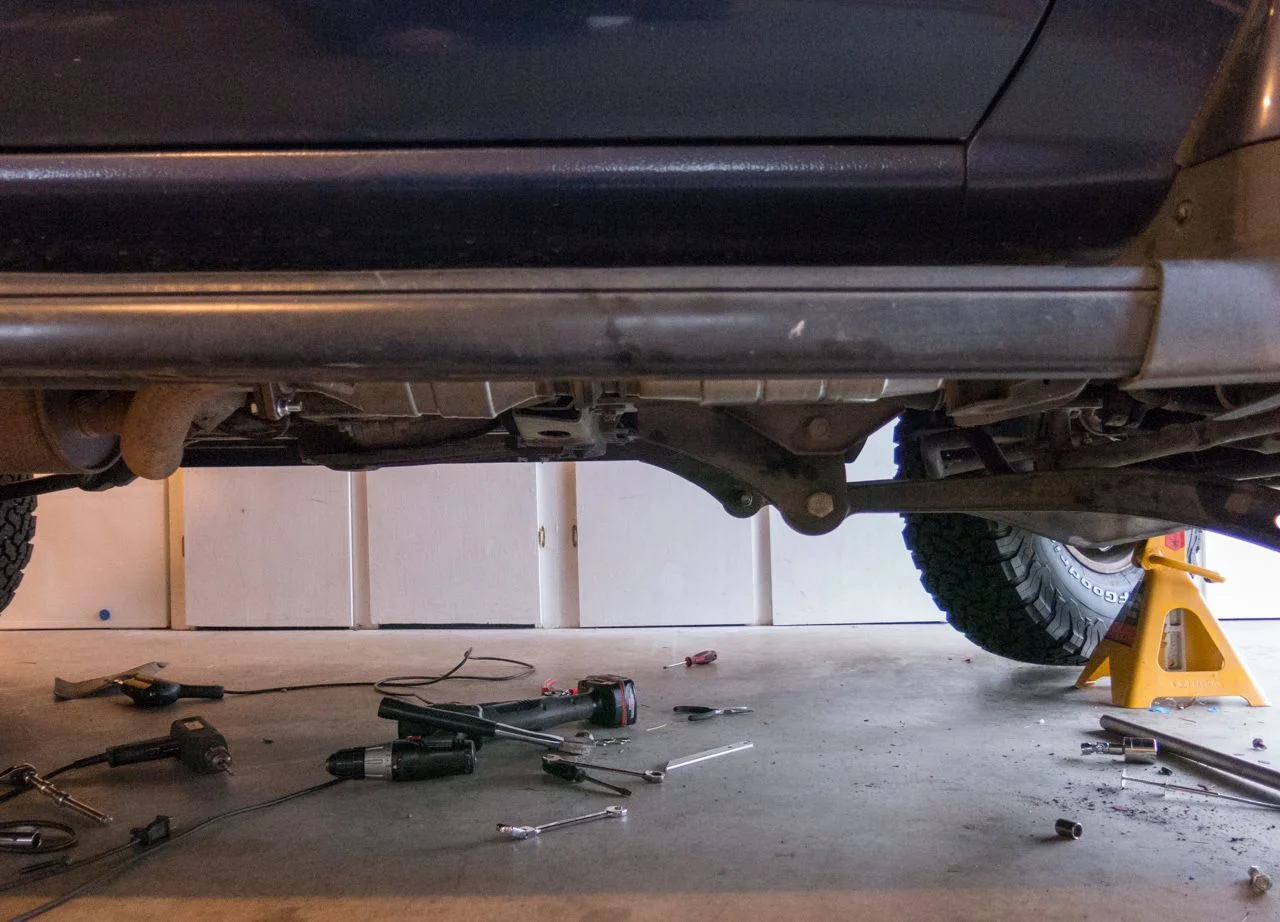

I got new cats and o2 sensors to install but only got 3/4 of the bolts off the old cats. I will finish that install tomorrow and report on any improvements.

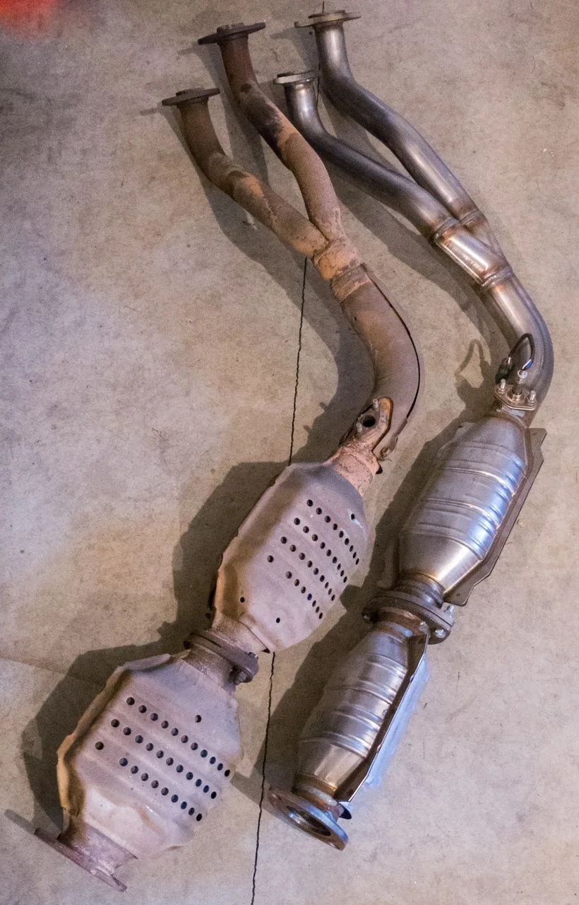

I finished the new cats install. I spent half the day drilling out two bolts. The Magnaflow cat replacement is much lighter than the stock. Installation was easy and they sit higher out of the way compared to stock. After starting up the rig I immediately noticed a louder exhaust note. I believe the old cats were partially clogged as the exhaust was silent, however there were no CEL codes. Standing next to the outlet you couldn't tell the engine was running. It is now audible but by no means loud. The computer is still in learning mode but I can feel the bottom end power is much stronger. WOT seems about the same. On a quick trip to Costco (50 miles round trip) I noticed it accelerated much better under partial throttle and MPG is a little higher via Torque monitoring app. I'll get a true mpg reading when I top off the tank tomorrow after a visit to Cabelas. Saturday will be the real mpg test on the day trip to Mt Hood for snow and trails. Total for both cats was $450 on Amazon. CARB versions run much more, sucks if you live in Cali!
New and old cats side by side

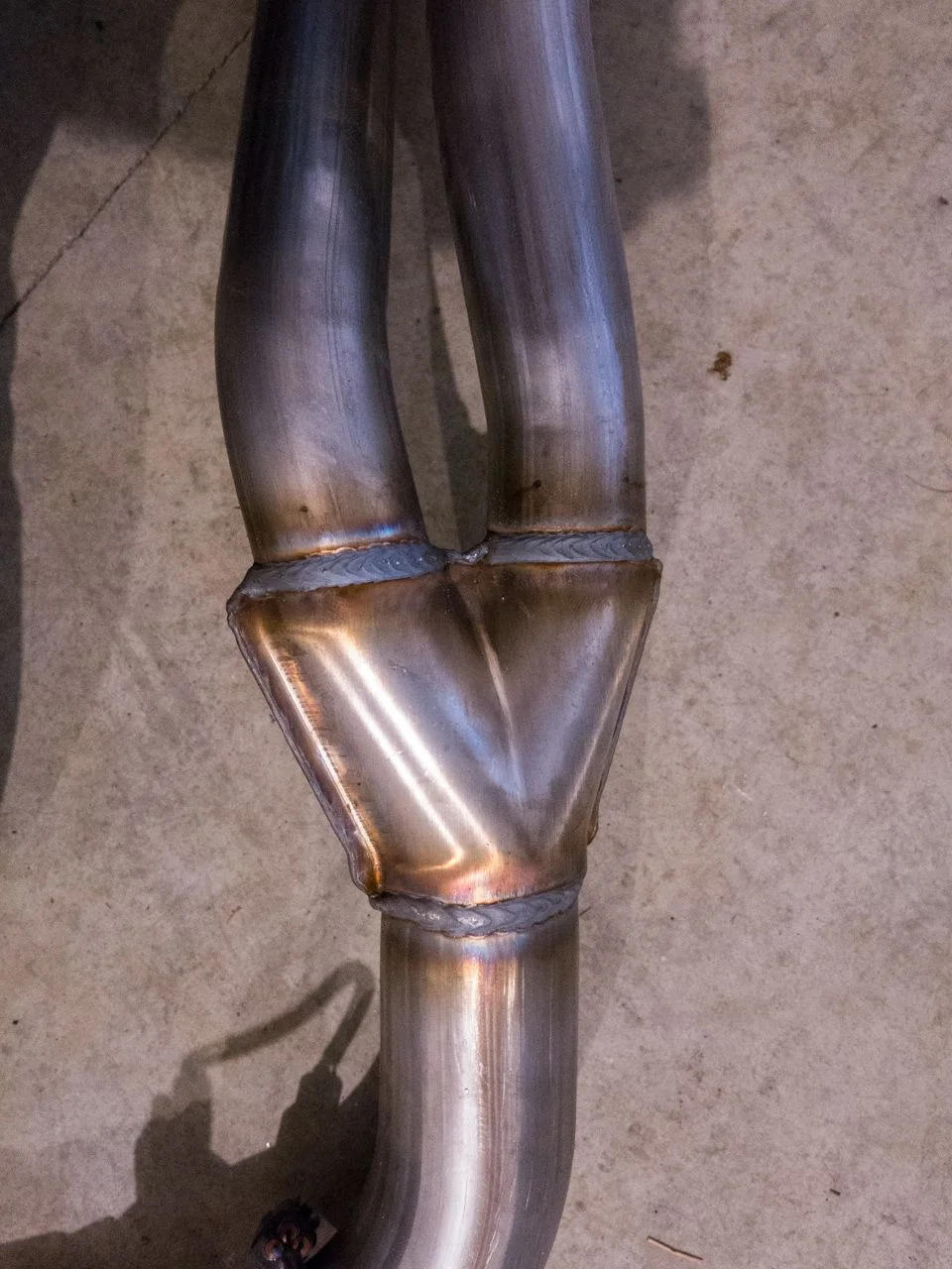

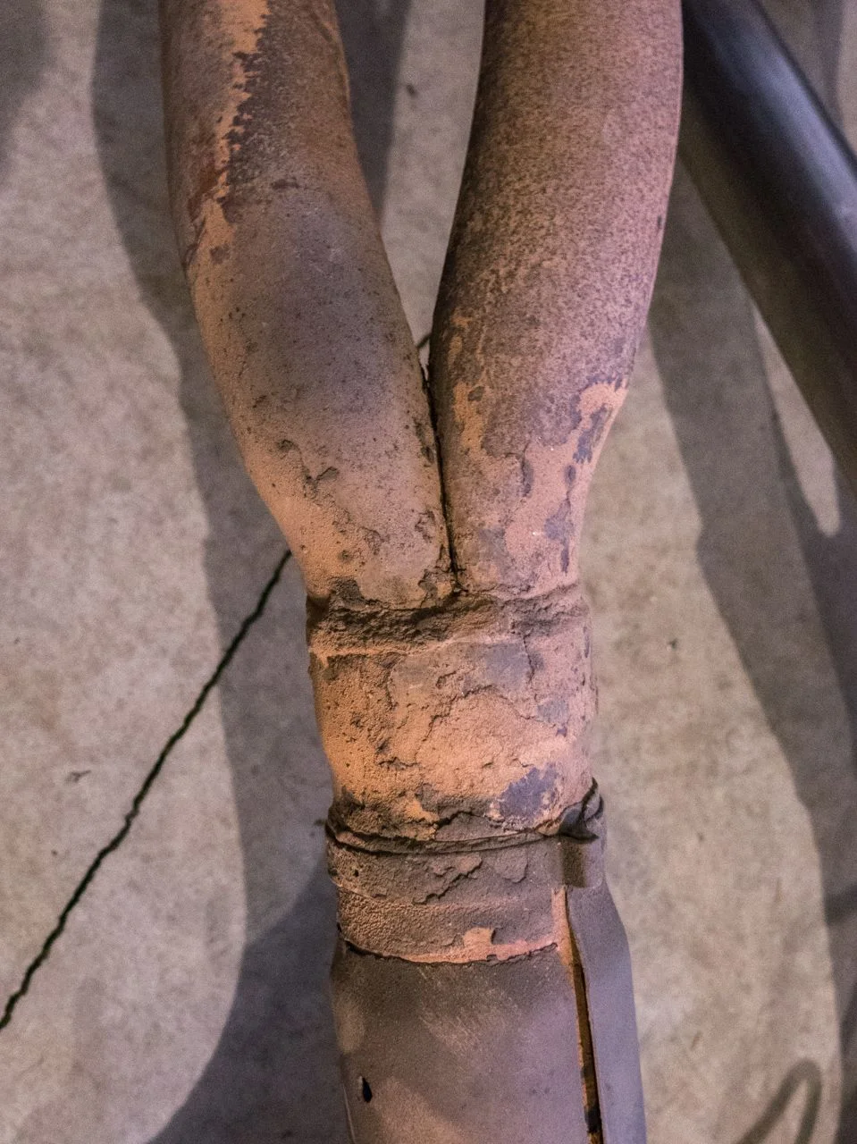

Old y merge

New improved y merge

The two into one and first cat.
