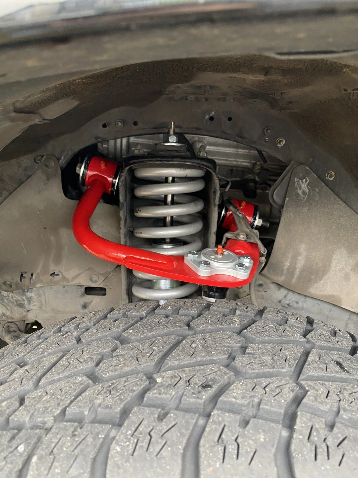

Hey first post but I have the kit now for about 500 miles.
coupled it with the JBA UCA’s and it’s a great ride. Used the 2nd perch up front so it’s just about 3” lift up front. Hoping that would settle some because I have a slight reverse rake at this time. I have the SSO rear coil on order because it has some flexibility in height. Hoping that’ll even things out.
havent had it off road yet but road manners are pretty close to the stock sport setting. I had the help of my brother in law but install was fairly straight forward and easy.

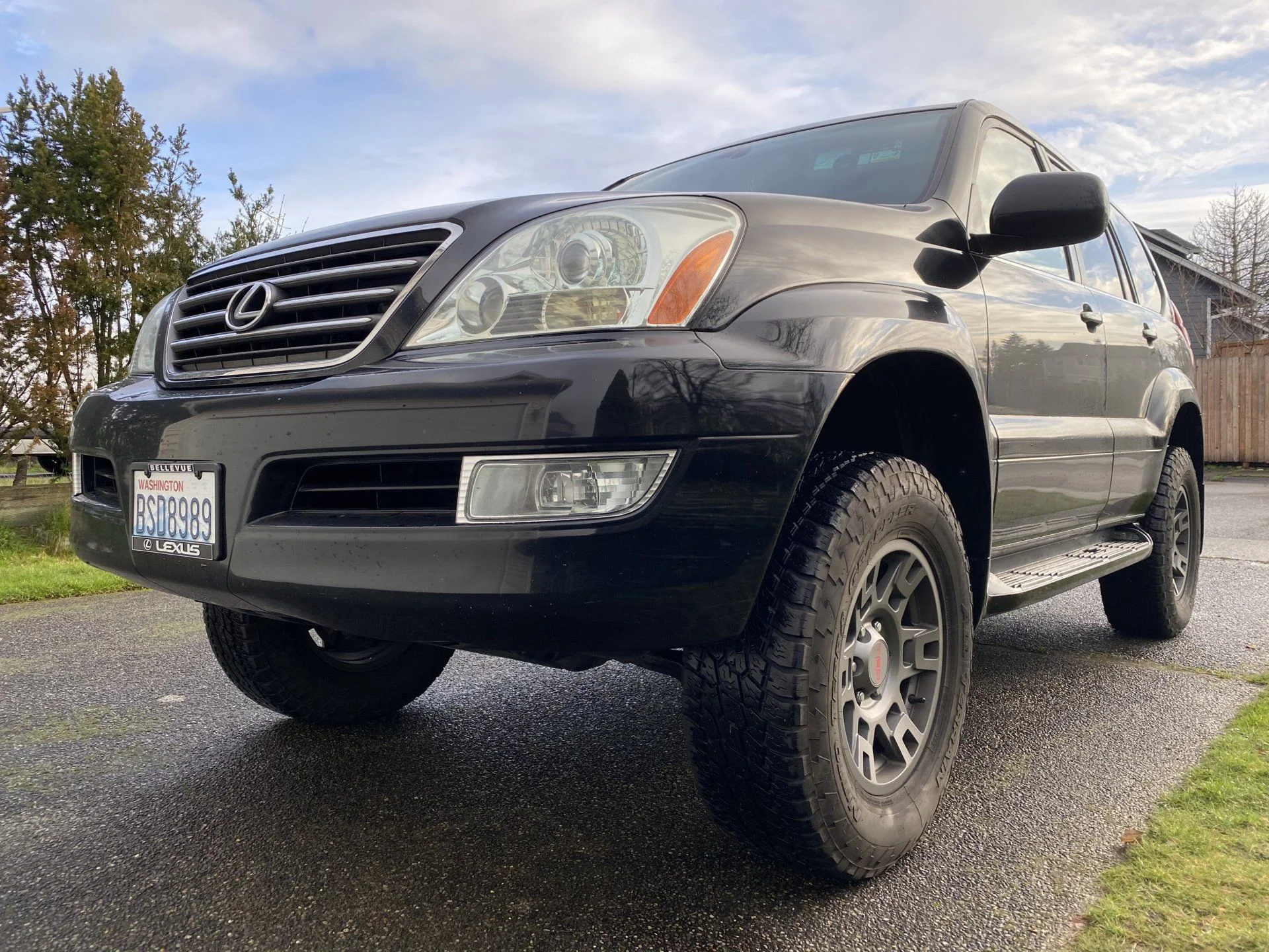

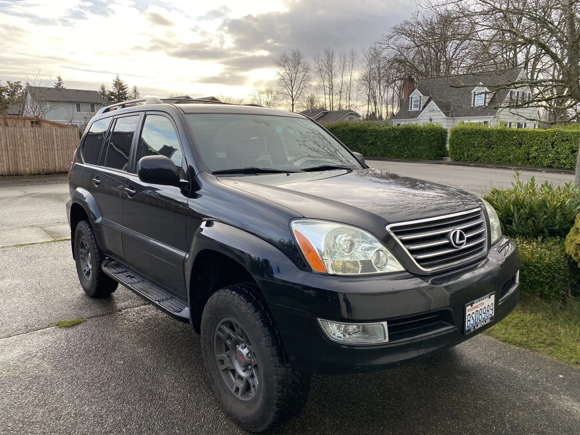

Love the look. Looks like my twin. ... thanks for all the feedback. I'm definitely leaning towards the eibach kit but was just looking for feedbacks and seeing if theres any cons compared to similar kits. So far, sounds very positive

Looks great man. I'm planning on Wildpeaks soon as well. Also note the change in geometry even with 265's has given me a slight rub on full left turns. Only really present when u-turning but haven't checked if it's body, fender, or side steps. Side steps are hopefully getting taken off anyway if I can convince the wife.

I did 3/2.2 F/R on stock UCA's so I do have slight reverse rake. You can set it to 2/2.2 if you want and it should carry over the stock rake profile. Honestly I purchased the vehicle used with blown oem electronic shocks and the airbags. The ride is amazing. It isnt overly stiff...feels like perfect valving for daily driver and offroad. It's softer than bilstein 5100s.
