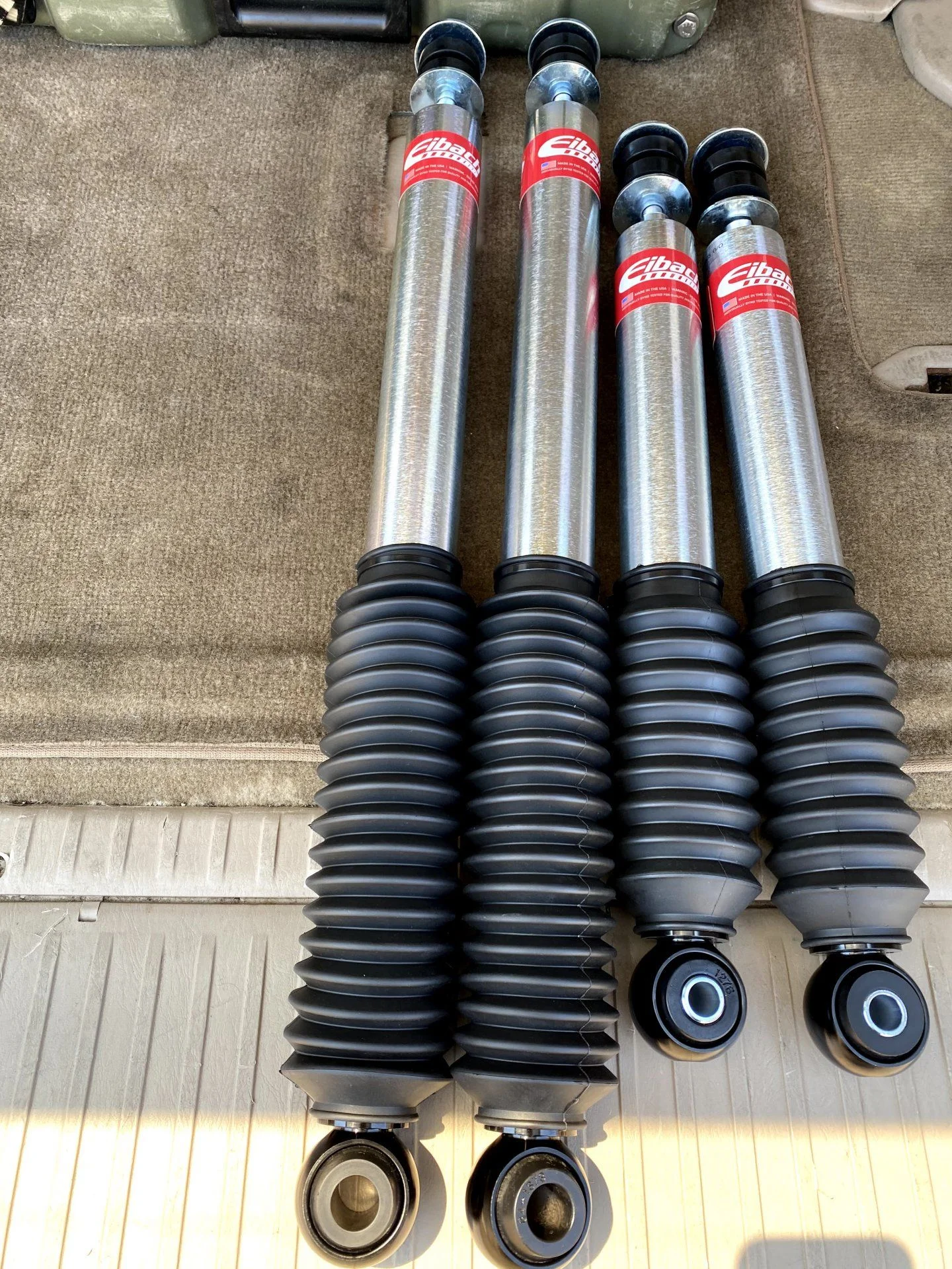

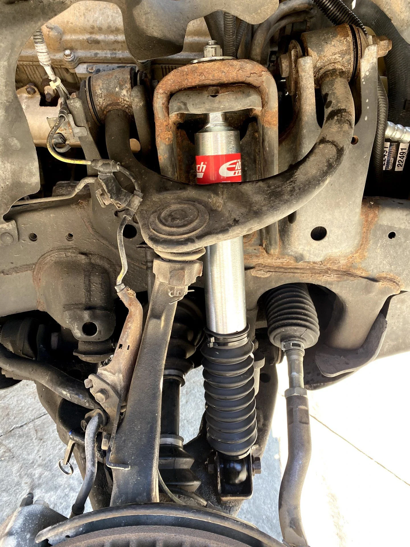

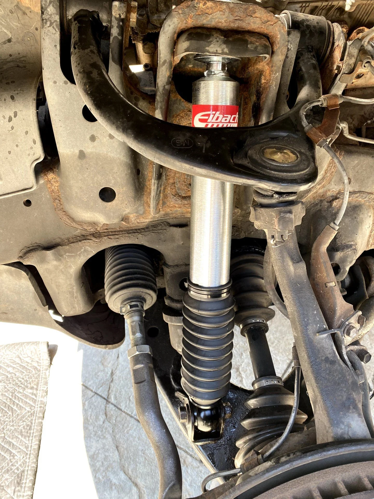

I just installed the Eibach Pro Truck shocks on my 1998 100 series. I already had these "2 inch" Dobinsons springs and these OME spacers. This was supposed to equate to about a 2.4 inch lift over stock, but I ended up with about 1.7 inches over stock. However, I had seen these same Dobinsons springs listed as 1.5" on several overseas websites, so I was actually expecting 1.5". The ride with these shocks is really good. The overall feel reminds me of the Bilstein 5160's I had on my Jeep, but with a much more compliant initial impact. So firm, but more compliant. I cannot really give a full 'review' of them yet, but I am sure they will be great. I will post an update after some more miles and some off road activity.
