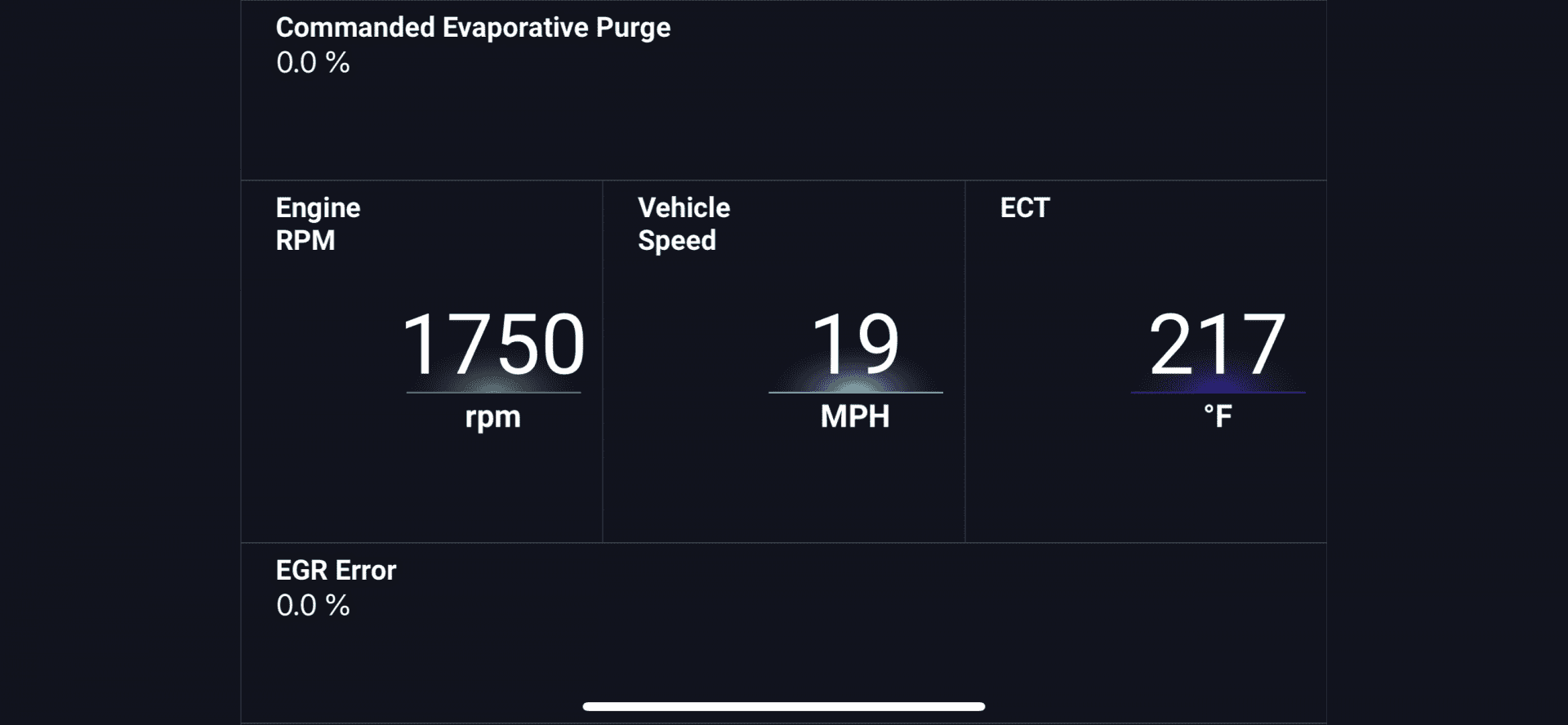

I think this was the highest temp for today
Damn man, that seems too high. Check the PHH, HCV? Thermostat maybe? I don't think it's EGR related either
Yeah, that is way too high for my comfort. I rarely see 200, even on the hottest days in AZ or the middle of the UT desert. And, I run my A/C all the time.
Ditto. Prob jinx myself but I’ve never had anything close. Even summer grinding away in 4-low in the desert.
Have you had the truck long? Is this the first summer or first time measuring temps via OBD? What’s the status of the cooling system?
It is super easy to reverse the erg delete, put it back on and do the same test.
I am with the others about a cooling system issue.
