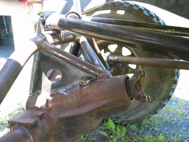

As Mace mentioned lotsa torque on that bracket, never seen one so highly mounted?
To metion, nice brackets and welding.
Thanks for the input on my axle upper links. I will give it some thought to try to make those mounts beefier. I could always make two more identicle sets of mounting plates and weld them to the outside of the existing brackets. Then I would only need longer bolts. Any ideas?
JRFJ4- my uppers and lowers are 1-3/4 x 1/4 wall DOM
