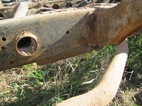

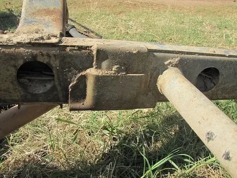

Can you do me a favor and look on your steel frame, now you have the cab off, and just around were the door area would be, is there any kind of channel reinforcement on both side, about 8-9" long added to the frame channel? I have two reinforcement channels on each side on my 82 that look factory but not sure. It was known to be a weak area of the frame. If yours being newer does not, mine may of been done by the PO. If you look at the last photo you can see the lest side with a "U" shape channel welded to the frame. It had a tray on it so he may of had some heavy loads and this may of been done before installing the tray as a standard before tray install.

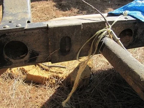

Made a quick visit to the farm this morning before it got hot. I had a look at the 47 frame and it has the the reinforcement brace just forward of the rear cab mount, so I would say its factory as it is properly formed around the section underneth. Also looked at the 45 frame and it has some reinforcement but not as much as the 47. Hope this answers your question. ;)
Below is the 45 showing less reinforcement.

Yes, mine looks similar to yours, if that rig had a tray on it at one time I am thinking that this is done by the folks who install the trays to reinforce that area due to the user increasing the loads. That's my guess as I would expect it to would look better (welds) if from Toyota factory. Thank you for that info it's good to know that other rigs have it as I was thinking this rig I have may of had a problem at one time. Cool.

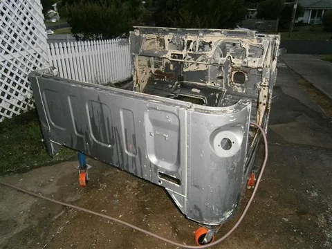

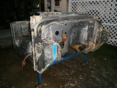

Spent some time removing and labeling all the switches/relays on the dash and surrounds, removed the pedal box, ash tray, steering wheel, heater box, foot kick vents, door hinges and pretty much everything else that was attached to the cab. Then I removed the wiring harness.

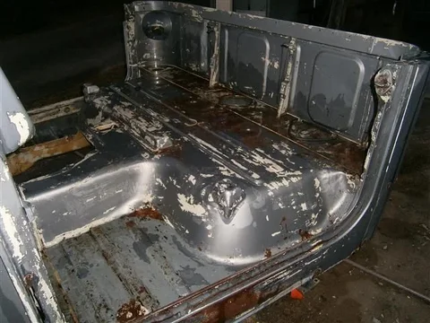

Then I turned my attention to the black tar stuff that is stuck to the floor pans. A heat gun and a scraper worked but it took some time, but its all off.:bounce:
The cab looks to be in pretty good shape.:bounce:It is better then the other cab, it does have some rust spots to cut out and patch up but a heap less then the other cab I was working on. Plus it has a tacho and a clock.:banana:
I did manage to slap some paint stripper on the cab. I plastered it everywhere, waited 20 minutes as directed, washed it off gently with the garden hose first so paint stripper didn't go flying all over the place not to metion on me, it burns so bad when it gets on your skin and then got stuck into it with a pressure washer and it worked great. Paint peeled off nicely, not all of it came off but it will save heaps on time on the grinder:bounce:

After two rounds with paint stripper and the pressure washer. It worked well and left the remaining paint quite soft, very easy to remove with a soft wire wheel on a drill or grinder.
Only surface rust around the rear cab seam, pretty happy with the condition of the cab:bounce:

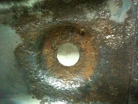

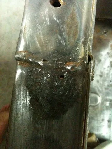

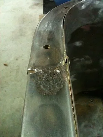

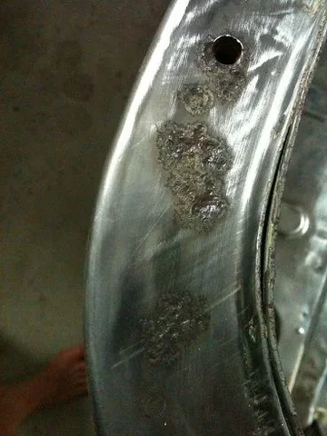

Here are some photos of the small rust areas on the cabs rear flange where the lower and upper rear cab join. I plan to remove these small sections and replace with new steel. I will start here as it needs to be done and won't be seen once its assembled so it will be a good area to hone my welding/grinding.
SOOT, it seems as you have some surface pitting rust in the same areas as I had.
If you look closely to my photos you see the same pitted rusted area with repairs ( light filler). What you have to do is take a small pointed tool (a screw driver will do) and push in, on, and around the rusted area, like your digging around to see if it will brake thought the metal. Do not be light on it, push as hard as you can. If it brakes though then it is definitely going to need cutting out. If its a small pin hole or holes you may be able to salvage that area without cutting it out. In those cases you can use some quality fillers that not only fill the small hole but will keep the rust rot from coming back and that is the most important part of all of this hole thing. If the medal is thinned out due to surface loss from flakes of rust being lost from the blaster and it is an area that takes a load i.e. brace or chair then cut, if not you can decide whether to just use a small amount of filler.That's were the baster comes into play. If the rust is not all gone it will be back and you are at it again. Kill that rust. Cutting and welding in new panels is the best way to go, but as said if it is small enough and cleaned up you can sometime eliminate the extra work with some good products. I used POR putty paste for the small holes and the pinholes on my pitted ares. This stuff when dry is like steel and hard as hell to sand but does a excellent job of keeping the rust from coming back. Of course a very small amount of body filler is to be used on top then a good DTM (Direct To Metal) epoxy primer. DO NOT cheap body fillers as they will suck the moister into that repair and blister latter on. Us quality.
I did use POR15 black paint on the underside and floor of my cab. Then I used a top coat on that, then the underside cot a shot of undercoating and the inside got a shot of bed liner. I hope it will last 50 years. I am not sure what is available in oz as POR or ? but again use the best you can find.
