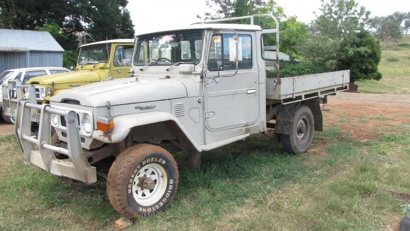

At the start of the year my father in law gave me his old daily driver, a 1980 HJ45 as he bought a 2000 79 series landcruiser. At the same time he also gave me a 1983 HJ47 that he bought cheap for parts that he had sitting on his farm. Both have a 2H under the lid.
That day I felt like I had been kissed on the a$$ by a fairy! and I still do!
Since then I have been busy with a new baby, moved into a new position at work and pulling these two cruisers apart with the grand plan to build one cruiser, which I have named Earl, out of the two with some extra spares. Sprayed Toyota graphite or a similar dark gun metal grey with a 2" lift and sitting on 33's with black steel rims.

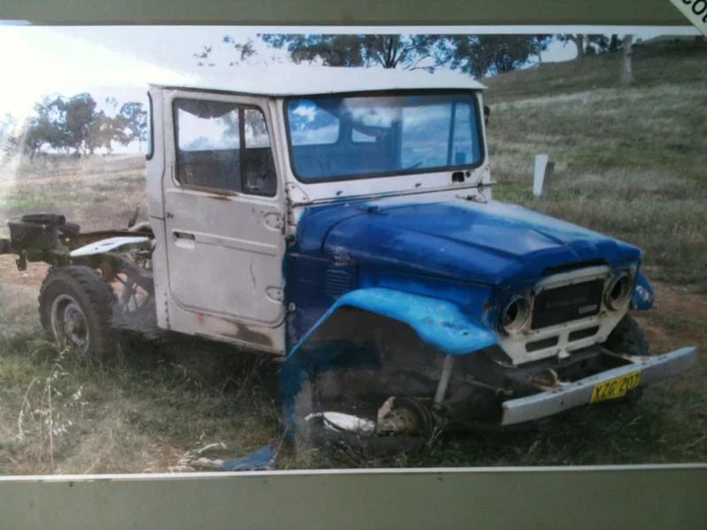

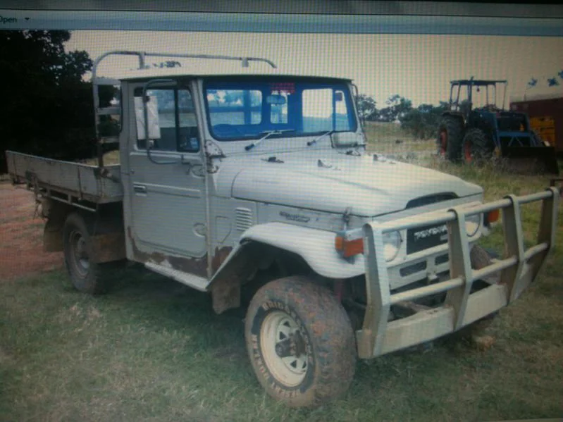

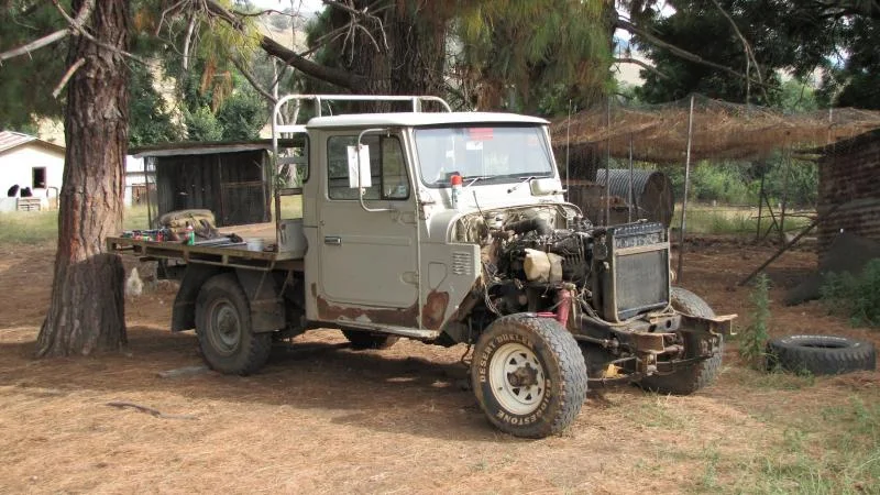

If this works this is a photo of a photo I took with my iPhone, this is the 47
45 in OZ

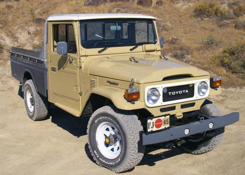

First welcome to the site. If you have been watching the site for as long as you said you know by know that there is a wealth of knowledge here for beginners to the advance builder/owner. Most all on the site that I have dealt with are real good folks. I kind of dabble in all types but love the old Land Cruiser, they just seems to have a personality of there own.
You have a very good uncle, hope you take him on a off road run when you are done.
So which truck are you going to use as the main build? All I can say is take your time on the build, grate therapy and the end results will carry for years when done right.
I too am the proud owner of a 1982 OZ RHD FJ45 that I am now finishing up. Has had its challenges being a non US model but when one looks back at it "its all good". You being in oz should have no problems getting the parts you may need.

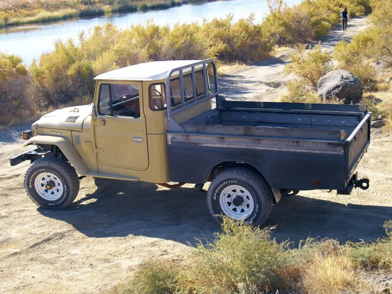

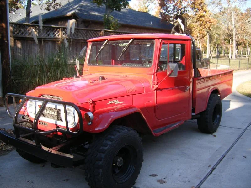

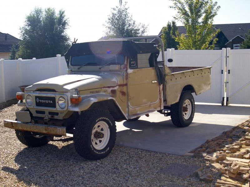

Welcome to the site! Happy New Year from the great country of TEXAS and a military "Hooah" to ya! Nice 45 you have there. My tan '65 has been undergoing major restoration and will be up for sale in about two weeks. The red '66 is my keeper and I have some minor things currently working on it.

Your FJ45 looks great, nice work! You should be proud, I bet it is a joy to drive after all the hard work. Those 45 beds are fairly hard to come by over here as most people opt for a steel tray with drop down sides. I have only seen one and was not in good shape.

Some more pictures of the 45.

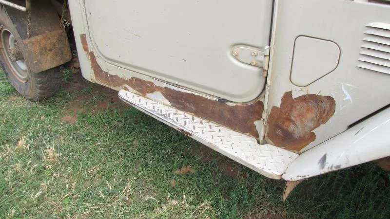

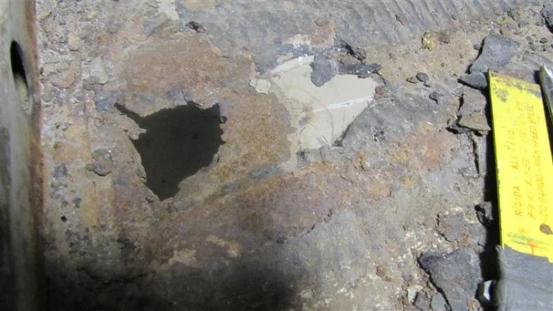

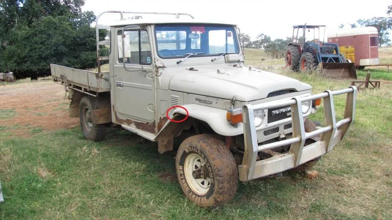

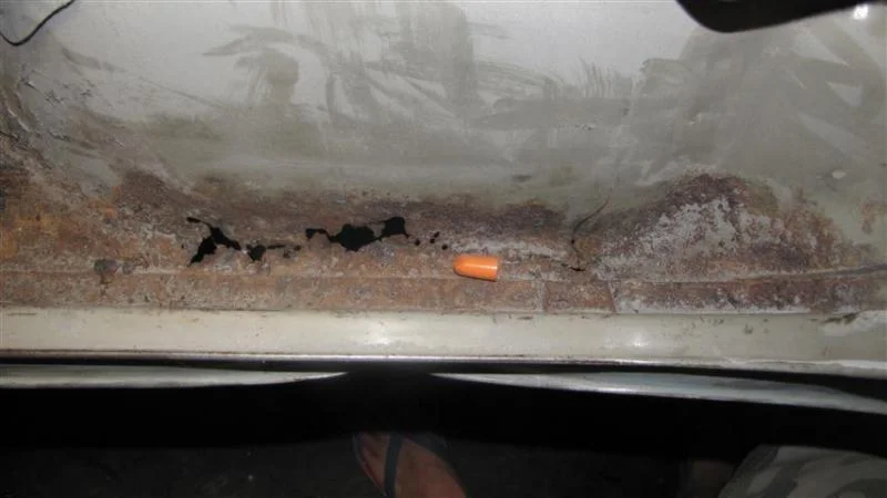

First one shows a slightly damaged front guard, damage under the door and it is hard to see but the door has a bow across the bottom half from impact with a strainer post
Second one shows below the right hand side door. There is heat marks from an oxy and small patterned dints from a panel beating hammer I suspect. The body filler was quite thick in this area. It looks like they did a ordinary job.
A better quality picture of the 45 from the other side, right hand side guard needs some work under the indicator and where it has cracked along and across on the bend. The hood is in great nick, just need to fix 3 of the vent fins as the have been slightly bent out of shape, and all of the hood catches need replacing.

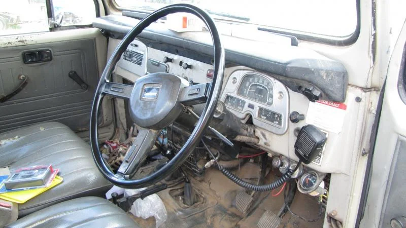

And the interior. I wish I took a picture of how much the crud was in the floor pans, it was about 2 inches deep, mostly dirt mixed in with grass seeds, beer bottle tops and old 22 shells.

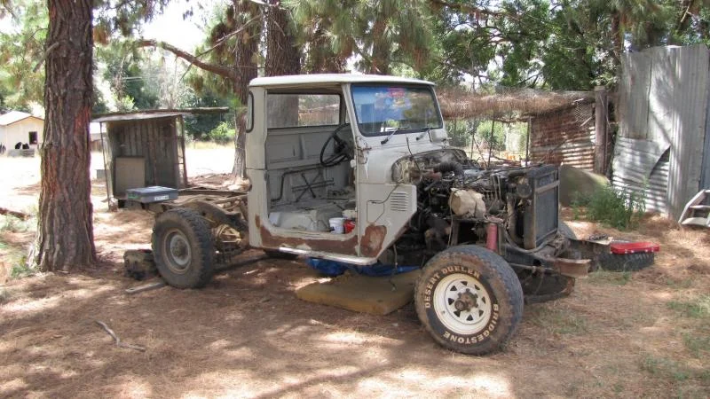

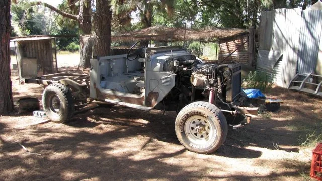

After cleaning out the cab of all the **** on the floor, I pulled the bungs and the pressure washer out and got wet.
I parked the 45 up hill of the pine tree just in case it decided to go for a quick drive down the hill. Then I started pulling some panels off.
Lifted the steel tray off with the help of the tractor:hillbilly:

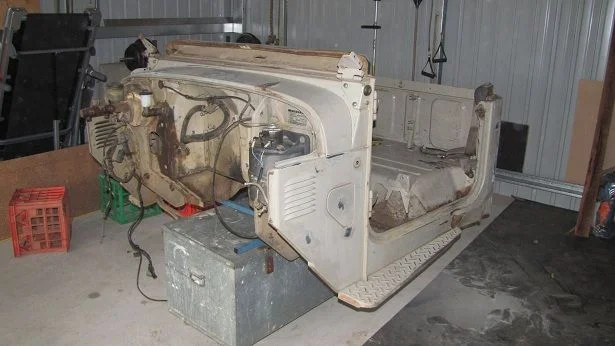

Then with full access to the engine bay, everything was disconnected from the cab body. Fuel tank was drained, disconnected and removed. Ready for lift off.:clap:

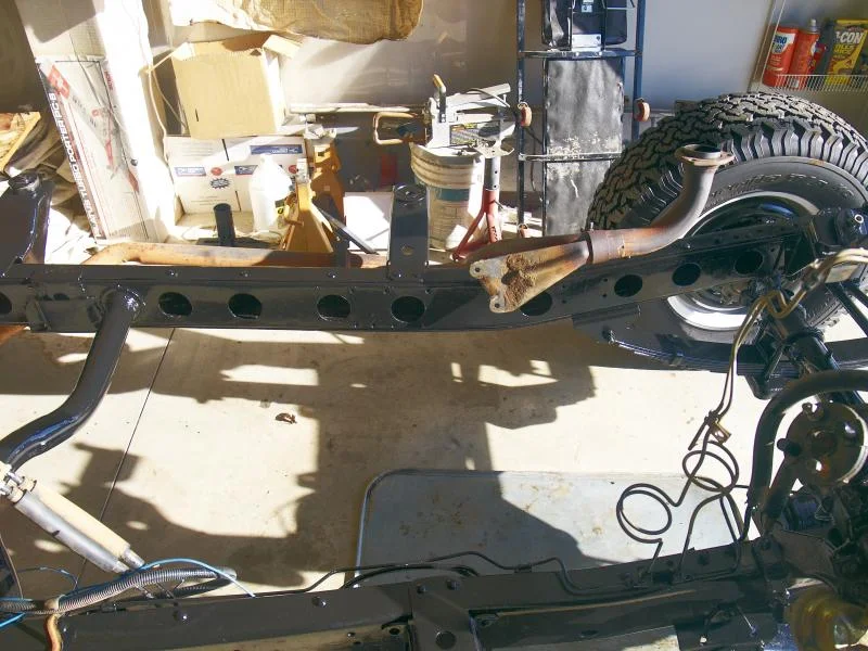

Can you do me a favor and look on your steel frame, now you have the cab off, and just around were the door area would be, is there any kind of channel reinforcement on both side, about 8-9" long added to the frame channel? I have two reinforcement channels on each side on my 82 that look factory but not sure. It was known to be a weak area of the frame. If yours being newer does not, mine may of been done by the PO. If you look at the last photo you can see the lest side with a "U" shape channel welded to the frame. It had a tray on it so he may of had some heavy loads and this may of been done before installing the tray as a standard before tray install. The box on it now was put on by someone in the states in 2010 as it came with no tray to the states.

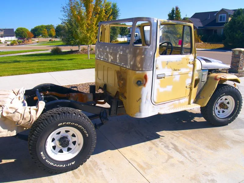

As you can see this old rig was in need of some serious love when I got it.
The cab was better than some I have seen, got lucky there.

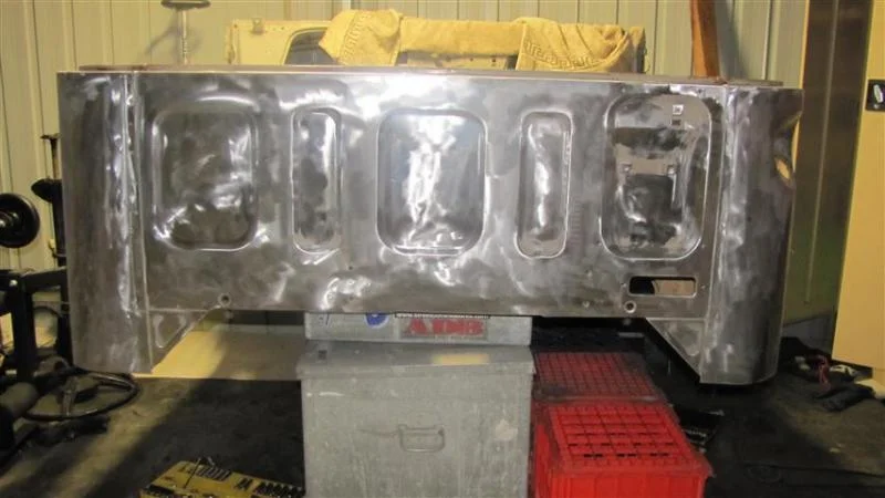

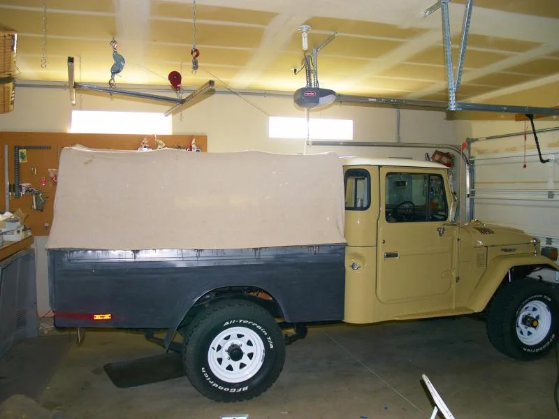

Another photo, still working on the bed.
The other is a project I am still working on-the cover for the bed. Still in the works, in the photo I just put paint drop cloths on to size the cavas needs.

For the area under the door I was planning the cut and paste method - out with the old and in with the new. When I washed all the dirt out of the cab out the nasty nasty showed its ugly self.:mad::crybaby:
Anyway the back edge showed no signs of rust that I see. Can't afford to get it blasted so I turned to other alternatives.:meh:

I will have a look on the weekend if I get out to the farm as I don't have any pics of the frame that show that area.

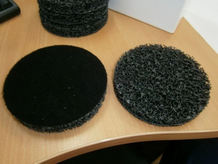

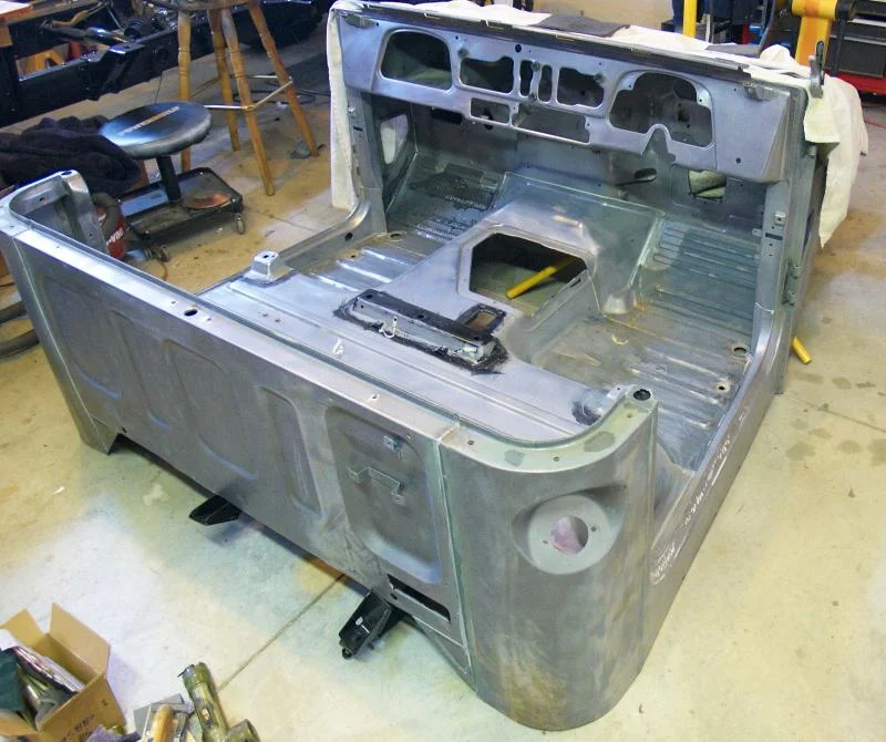

I tried some paint stripper on the cab but it didn't work that well so I took to it with an angle grinder and some 3M strip and clean discs. They worked very well and quick you just have to watch your pressure as they probably would remove steel if you let them.
This is them and the box they came in.
