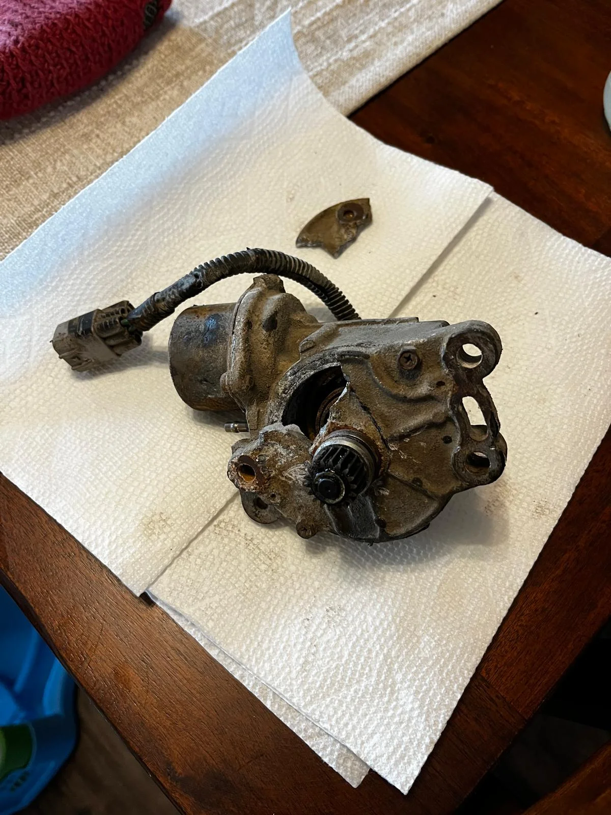

Hey All,
First Post, I have tried to search with not a lot of luck. I have a 1999 4Runner (why I am in the forum). My Actuator is toast. Corroded and the cast is cracked. I need a replacement, but cannot find information on which AISIN part to buy?
SAT-008 - Shows a fitment for 1995-2015 Tacomas
SAT-009 - Shows a fitment for 1996-2009 4Runners.
The 009 is 2x the price as the 008 - but I cannot see what the difference is? There was somebody who noted that a 008 fits, but he has a blinking light for the RRDIFF lock light.
Can i use the 008 for my 4runner?
Just moved the locker pin manually. Yes! The light is solid with rrdifflock. So I ordered SAT-008.
Now I’m going to clean the mating surface and paint with POR-15 in the rusty crap around there.
Fingers crossed, will update.
