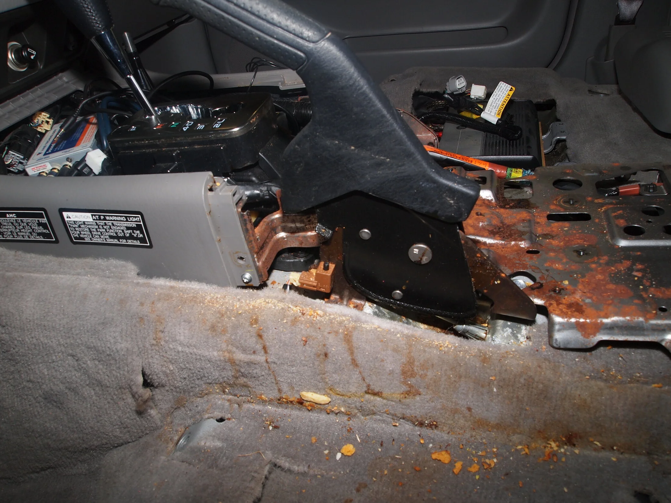

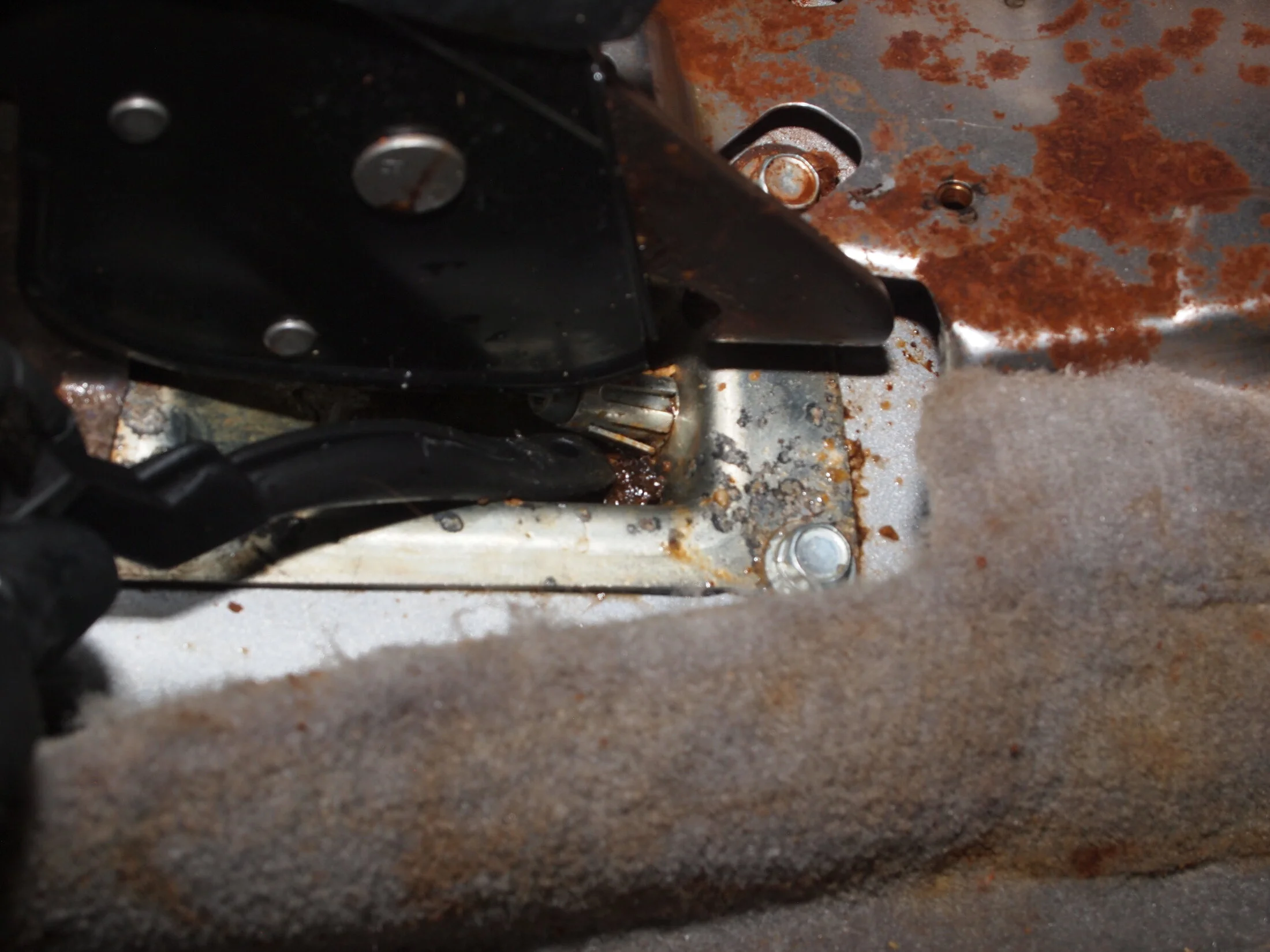

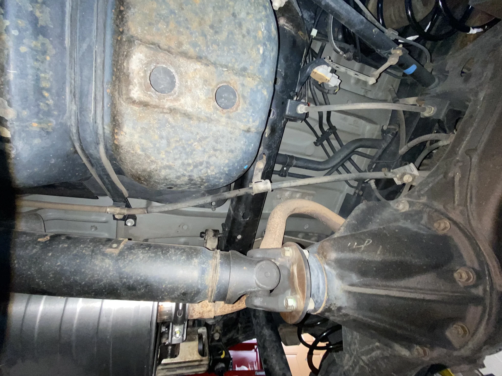

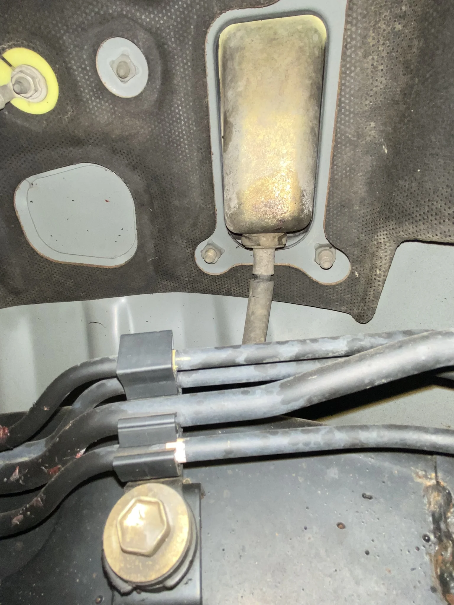

When handle will not pull up. But cable across rear diff, loose and bell crank moves freely. It is almost always, sugary drinks spillage, near handle. The cable runs down from handle into a blow, which has the cable housing at bottom. The sugary drinks, fill the blow, and coat the cable as it runs into the cable housing.
You can remove the cable and possibly clean out. I just replace them.
From under side, you can see cable coming out the blow.
Travels back, over rear diff.

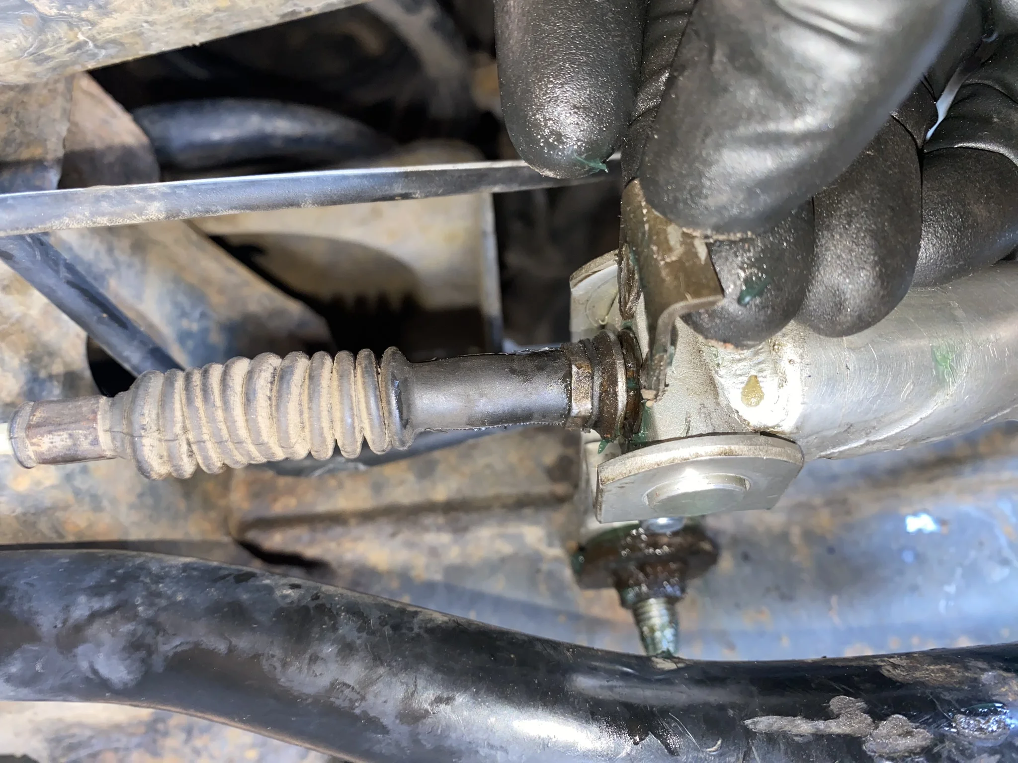

So if the hand brake lever is currently down/ebrake disengaged, can you take a picture of the current position of the bell crank assembly?
When handle will not pull up. But cable across rear diff loose and bell crank freely moves. It is almost always sugary drinks spillage, near handle. The cable runs down from handle into a blow, which has cable housing at bottom. The sugary drinks, fill the blow and coat the cable as it runs into the housing.

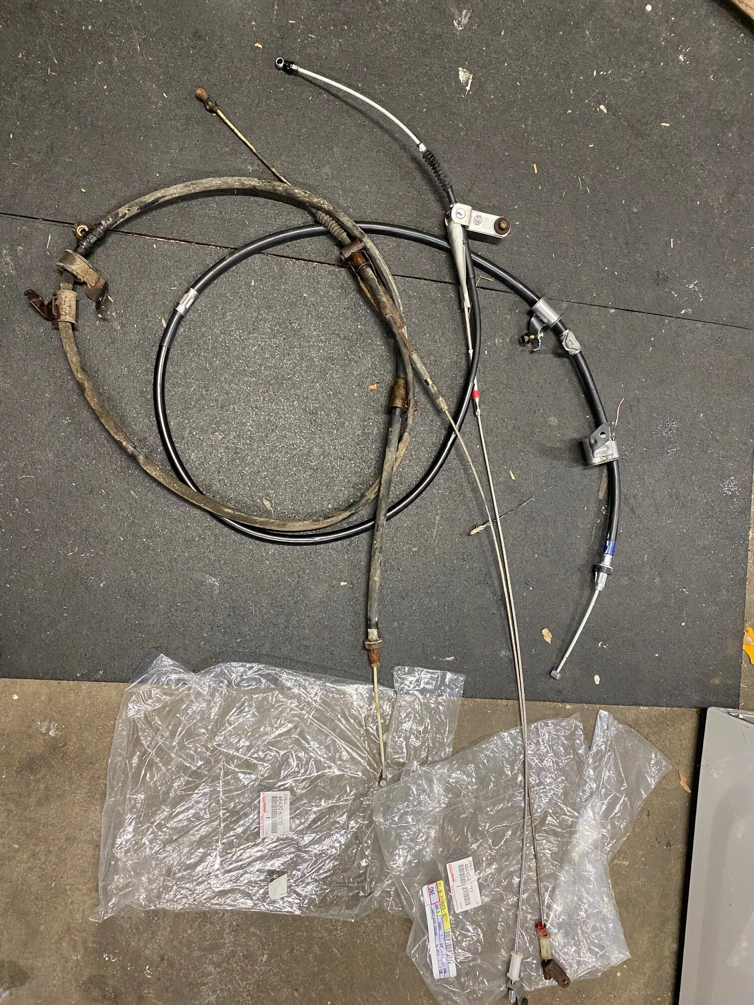

This is exactly what it ended up being. Everything about this truck was SUPER clean, but after taking apart the console, there was a sludge in that little cup. Replaced the cable which was 95% super easy, though that one bolt above the gas tank was a bitch to get in and out. Wouldn't have been so bad, but there wasn't enough space between the bolt head and the bracket to get a box wrench or ratcheting socket on it, so it was open end wrench all the way. I really contemplated if it was actually important to put it back, but ultimately i did. I still need to adjust everything, but the problem was 100% the cable getting gunked up.
I had the same issue on my 98. There is a little cup that the cable sits in, where it is attached under the lever. After years of ( I guess) Spilled drinks, the end of the cable became frozen. I replaced the cable with a new OEM one, and the operation of the ebrake is smooth again. it took about 2 hours to swap it.
The biggest issue I run into. Is freeing #1 from #2 cable, and freeing adjustor of #2 cable. Replacing both cables, makes job easier.

I didn't realize they were two separate things, so I only ordered the new long cable. Fortunately mine was relatively easy to get apart. I'm fortunate to live in the south and not have to hunt to find southern trucks with little/no rust. It makes a huge difference!
