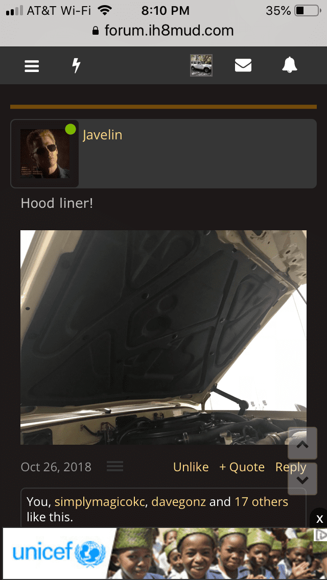

I got the idea from @Javelin off the what did you do with your 60 thread page 457
Here is his photo as mine is still in the box

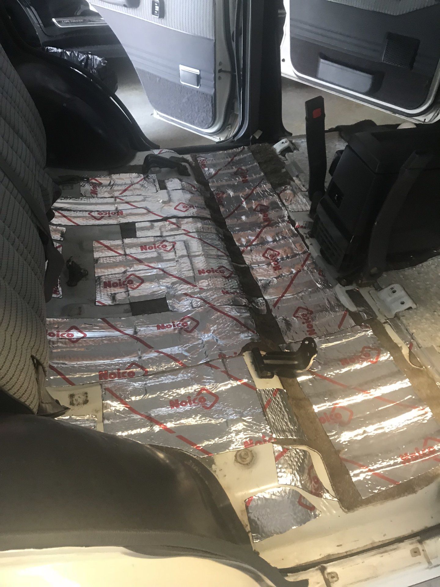

I used Noico and a wooden roller from a craft store. Very happy with it, No weird smell and the noise improvement was dramatic. Oddly, I did a decibel test before and after and it didn’t show marked improvement but cabin noise is more bass than treble if that makes sense. You don’t need to cover 100% of any surface to see improvement. Did mine in stages and had the most improvement from driver floor pan, rear wheel wells and inside the doors.

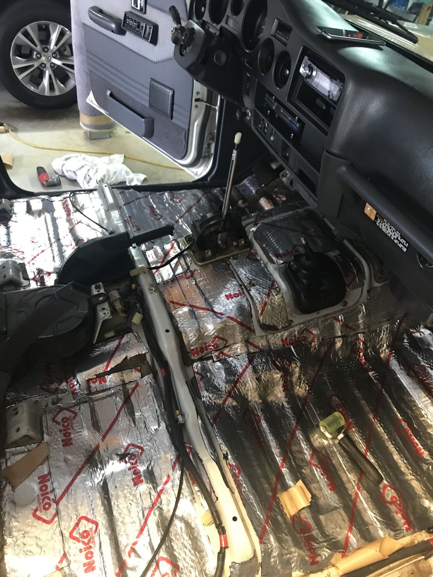

I did my 60 stem to stern with Noico. Definitely less expensive than Dynamat,
same quality and no smells or issues that way. To get the most out of it,
you must do the inner doors and rear quarters. It’s just time to install otherwise
not difficult. It won’t quieten the ride appreciably, but interior sounds will be
fuller with less background noise. Hard to explain, but makes a difference.

@EscapeWagon62 Looks great! Did you use a thermal product from Noico or just spins deadening? Did it have a good impact on heat coming up from the floor?
Great question. I don’t know for sure but I used the thinner of the options but it did cut down on sound and heat. I think the black goo does the sound and the foil does the heat.
if I were to do it again I would probably go with the thicker Noiko if it’s offered.
