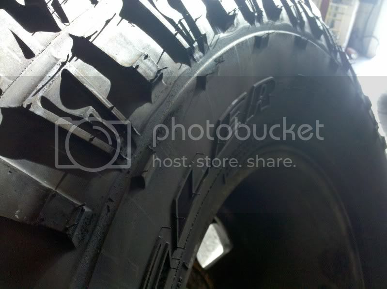

Well, new tires went on today. The manager was still a little peeved when I walked in because he had pulled my records up and noticed when I had made the initial purchase. He said, "Um, you know that you bought these tires back in FEBRUARY, right? And you didn't notice any issues until last Friday?" I then told him that I have a work truck and hardly ever drive it, and showed him my current mileage - less than 900 miles on my rig since the last rotation 4 months ago.
"Wow, that explains alot. No wonder you didn't notice anything."
Long story short, the 285s look straight up skinny compared to the super-fat 305s, but I have no UCA rubbing issues anymore, I can turn lock-to-lock again (without any hellacious noises from rubbing on stuff, that is), and the truck feels like it has a tad more spring in it's step from shedding 5lbs per corner in tire mass. I'm very happy with the end result. Surprisingly, the carnage didn't look as bad as I thought it would when we pulled the tires off. Still warranted a replacement I think, but there weren't gaping holes in the sidewalls or anything.
Passenger side inner sidewall:

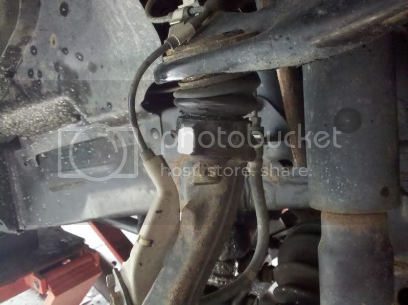

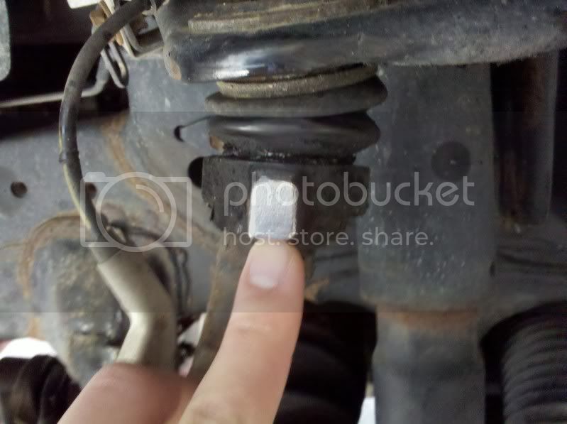

Passenger side steering knuckle rub spot, just below ball joint/UCA:

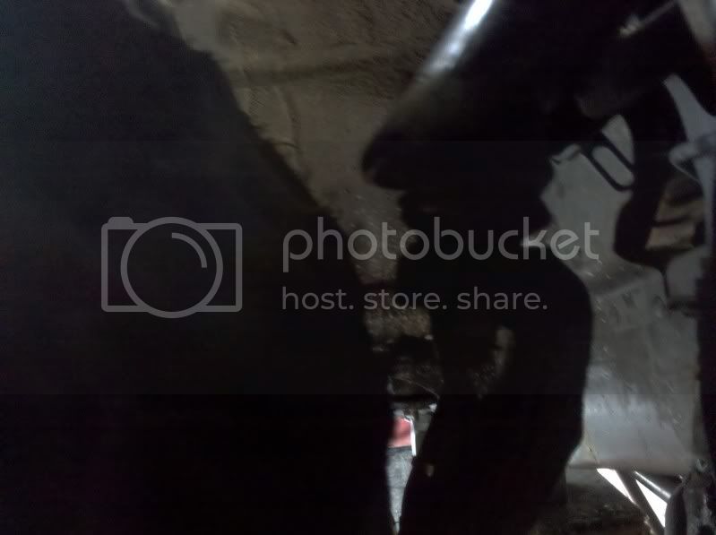

Last but not least, PLENTY of space in there now w/ the 285s on:

Hey Fuzz, did you notice if there was any room to grind down the knuckle a bit without compromising it's integrity? In those first pictures it looks like it's sticking out unnecessarily.
I was actually looking at that a little bit at the shop yesterday and again last night with the 285s mounted. It appears that the outer edge of the steering knuckle can indeed be ground down some, but how much I'm not sure. I don't know if that little 3/4" nub sticking out is just a casting element that they use during the production process that serves no purpose, or if it actually has some sort of lubrication channel cast into it or other important function that I'm not seeing in relation the UCA/ball joint assembly. I'm probably not going to experiment with it further until I decide to slap 315s on this thing in a year or two. I'm too happy with the restored steering ability and lack of rubbing! :D

Pretty sure spressoman said in the "what spare parts to carry thread" that these were intended to bed used in the brute force method of knuckle removal - hit the flats with BFH.

^^^ yes. The other factor most of us face at one time or another is deep mud. Even if you improve the clearance between the knuckle and the tire, by removing the metal knocker nub, for lack of a better term, you're still insufficient IMO when you get the tire sidewall mucked up with mud and grit. Grit and/or small rock infused mud will need adequate (more than a quarter or even a half inch) clearance otherwise its the soft rubber of the tire that gives/wears.
This is one plus for a 35" tire...as it gets the widest portion of the tire a little higher in relationship to that knuckle nub.
