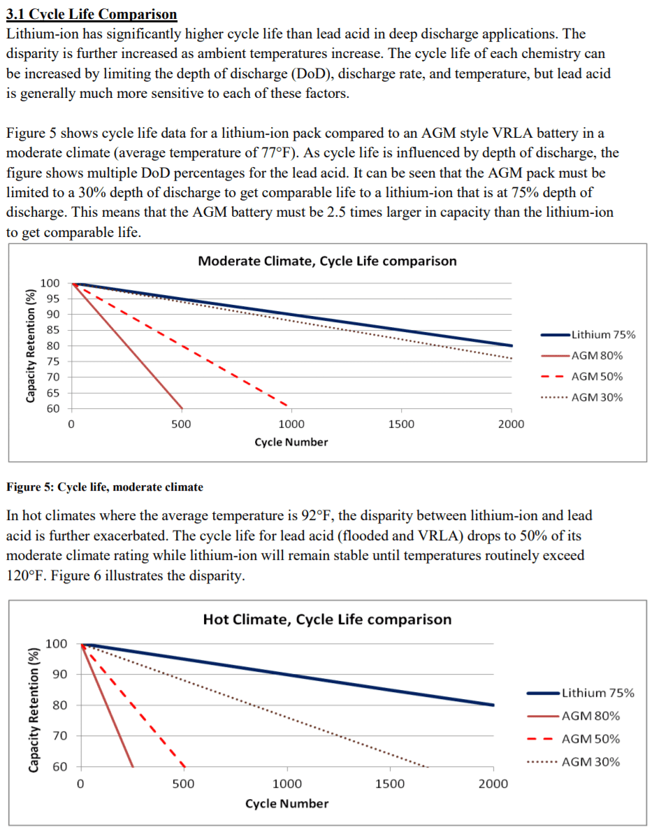

.... I also look at life expectancy, and GZ 500 cycles from 100% to 80% is not really impressive.
It looks like Odyssey Extremes are rated at 400 cycles from 80%.
Unlike other AGM VRLA batteries, the ODYSSEY battery is capable of delivering up to 400 cycles when discharged to 80% DOD and properly charged.”
So a GZ has 125% the life cycle. Is that right, or is another type of AGMs out there? I had always purchased sears diehard platinum and odyssey extremes, as they seemed to have the best reputation.

I expect much better than 500 cycles. Like any chemical battery, it depends on the average depth of discharge per use. 500 would be just about worse case.
