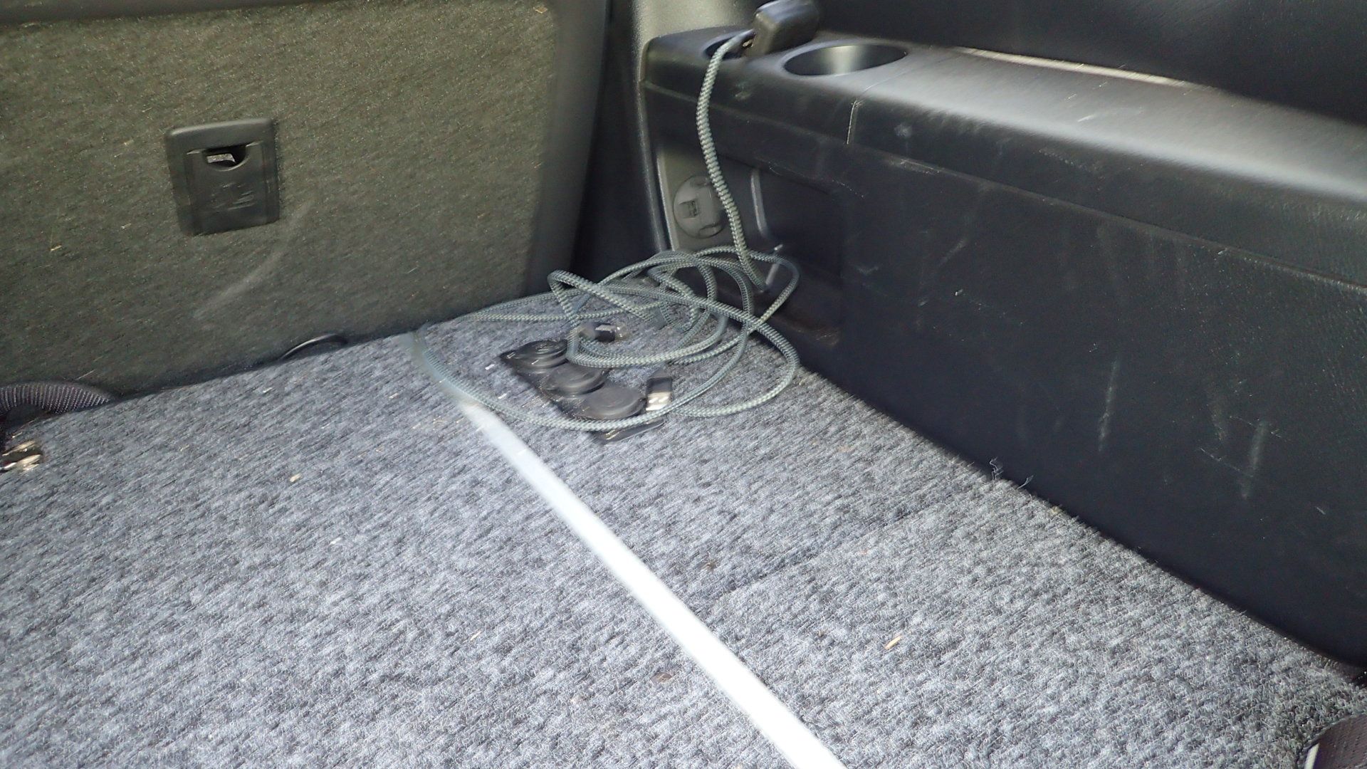

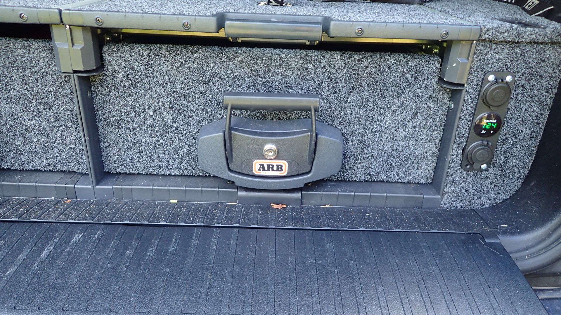

Distribution box - I ran a good size cable to the rear behind the 2nd row attached to the back of the ARB storage boxes behind the 2nd row of seats. Fold down the seat then you can access it.
Amazon product ASIN B07FT8L44J
USB and various other outletS off the distibution box.
I put them on the front of the ARB boxes and top beside the fridge, and some various other places. Hook to aux so stuff can charge 24/7.
Amazon product ASIN B072LN19K8
Displays (2) showing in and out.

With the plugs next to drawer faces is there room enough to plug things in with the tailgate closed? So what’s charging goes on top of the drawer?
The outlets behind the 2nd row seats I use to charge the 4g hotspot (sitting in the cup holder), head lamp sets, flash lights, blue tooth head sets, phones or what ever. Plus the iphones cords can reach the 2nd row seating.
There are cup holders there to stick stuff in that is charging.
My arb 63 is on that roller top beside those plugs.
Sitting on the tail gate the rear outlets can be used to charge a phone, or a flash, or run a 12 volt blender, or run a 12 volt hand held spot light.
There is about 4 inches clearance from the gate to the drawer system. I don't use those ones for charging stuff unless I'm sitting on the tail gate. You could do it though as there is clearance.
When I'm camping that back area is open with the tailgate down a lot of the time for cooler/fridge access, or to get a stuff in the drawers. Then it keeps the blue tooth music speaker charged.
The panel also powers the off road and camp lights, and 63 ARB fridge.
