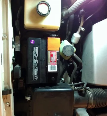

Decided where I will be placing the backup battery and checked out fitment before I start fabbing a tray. I have a LX470 with AHC so note the AHC reservoir at the top that owners wanting dual batts complain about.
It's a Group 47 size battery. Pretty much the smallest that Costco offers. Fits pretty well. The small battery will work well for my strategy as it's completely a backup. So I don't want to pay a weight penalty or an overly troublesome fitment for a larger batt.
I will be moving 2 things to make enough room here:
1) Resister (pretty sure this is the daytime running light, DRL, resistor) You can see it moved to the bottom left of the batt hanging along the vertical wall.
2) The power steering reservoir will moved along side the battery. When I fab the tray, I make provisions for this to mount to.
I'll be making progress slowly as time allows so don't hold your breathe. But I will get pics once I fab up the tray.
