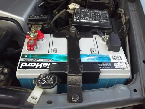

Does this battery fit in the primary battery tray? It appears the terminals are reversed. I'm wondering that since the terminals are in the middle of the battery, it would be easy to turn it around...
Terminals are not reversed. The picture (or your truck?) is just backward.
Fits incredibly well with the correct tray. Just enough clearance on all sides.

So, I guess I'm left with fitting a group 34 in the stock tray. Since I have a dual battery system, I really am not worried about less cranking amps over the 31.
Minor modifications allowed the 31 series to fit nicely...

It is in the spare location. The 31M (pictured in my last post, not my truck) is in the stock location using Shaggy's Tray, the 34M is in the Aux position using Slee's Tray. I need to get some better overview pics.
Chris Sandstorm FJ said:
Ahh, I should have looked at the paint color of the LC!
Yup that's a pic from my LX. Still need to finish the mount for a 34m behind my Ironman bar.
