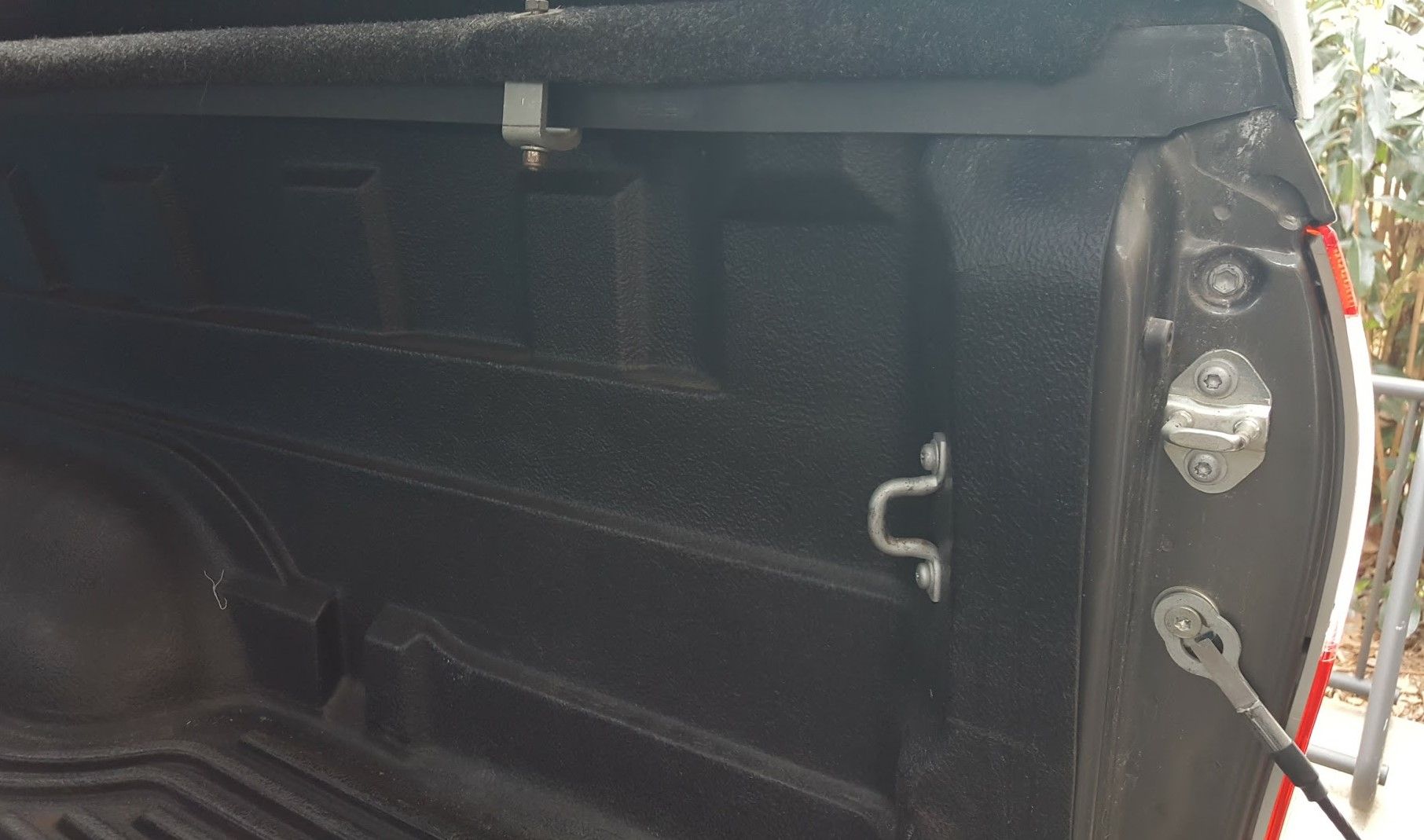

In the back, I am working on a custom plywood board set up that will wedged/secure into here:

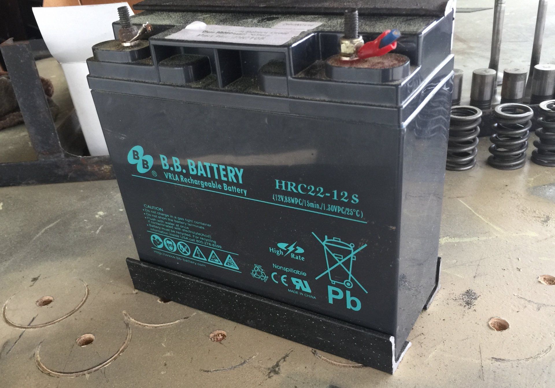

Saying that, I've got a few of these small sealed batteries I want to add in the rear quarter panel. I started building a batterybox but the project is on the back burner.
Demensions are roughly 7"x 2.95"x 6.5, so lots of mounting options.

. . . I've got a few of these small sealed batteries I want to add in the rear quarter panel. I started building a batterybox but the project is on the back burner.
Would like to see how you end up mounting these!
