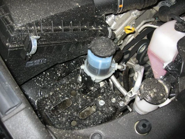

I was looking under the hood of my 2010 4Runner Trail tonight and noticed that there is another battery tray opposite the existing battery (makes it almost too easy). I just have to figure out how to relocate the components that are mounted onto a portion of it.

Here's a pic of the empty tray. I'm just wondering where to relocate the power steering fluid reservoir and what appears to be the A/C recharge plumbing. Thoughts?

I am facing the same situation .... where to relocate the power steering fluid reservoir?
Any advice or recommendations?
