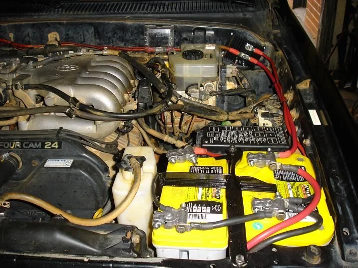

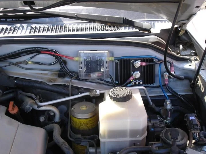

All you realy need is a good battery isolator. We make all of our own cables (2 or 4 gauge) per aplication. We also add a Aux Marine fuse pannel that is run off the secondary battery that you can run up to 100 amps (per the inline breaker) of accesories off of.
The isolator that we use is about $200 and you can get the fuse pannels for about $50 from any marine supply store (west marine). There is also about another $100 in cables, ends and shrink wrap.
Without an isolator there is nothing keeping your accesories from killing your main battery which is realy the main reason to do dual batteries in the first placee.
The first pic is of a 2002 4-Runner and the second is a 100 series Cruiser.
