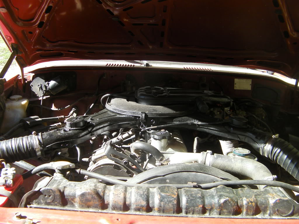

just wondering what yall think about this idea, i'm hoping it would give me a smidge more power/fuel economy....
i am considering cutting the air intake horn off of a junk fj60 air cleaner and welding it to the front passenger side of my factory aircleaner ('86 FJ60) and then running the air tube out under the battery tray. there's a hole already there just like on the drivers side. surely someone's done this before?

well, i finally went ahead and did it.....it seems to me like there is a small improvment in throttle response and power.....i'll let yall know if there is any difference in fuel mileage
also, i shaved the tube off of the bottom of the HAI valve and welded a peice of sheet metal across the bottom of it, then T-d off of the vacuum line of the original HAI so that hopefully it will close the airflow of the new intake when it's cold, i'm not sure it that line pulls enough vacuum to close two valves at once or not....well see

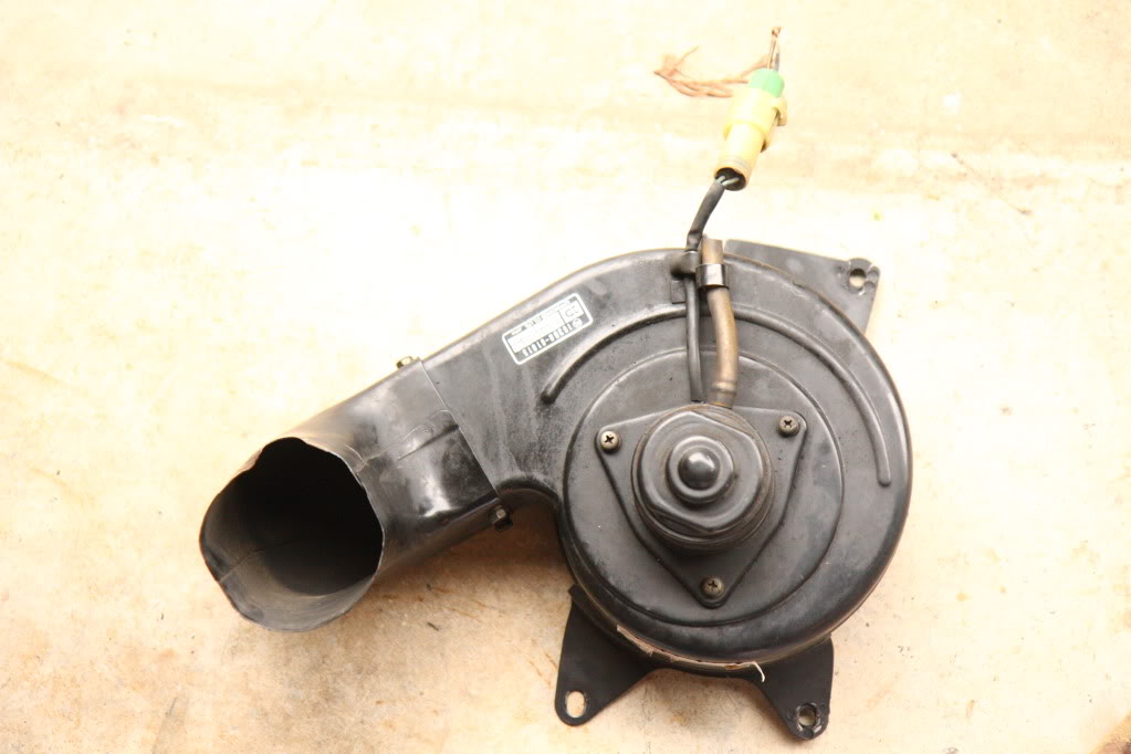

This is my franken-setup. I just hacked off the housing and threw out all the tubing. I wheeled in the dust this weekend so the K&N is dirty but I'm willing to clean more filters for more air. So far cool winter driving has been awesome so we'll see how it does this summer. Oregon is pretty mild so I wasn't too concerned about the Hot air intake.
As far as power goes: big improvement over the behind-the-headlight-garden hose, especially in terms of immediacy. Gonna do headers soon to free up the exhaust.
On another note, why not run this blower on passenger side where the air is presumably cleaner and cooler, wire it to the ignition (I can't figure out when it's supposed to kick on but mine never did) and pump it directly into the intake hose?
Your carb. cooling fan prob. didn't kick on because the wire to the sending unit got britle and broke off. Common problem. If you remove it from Drvs side location you may have problems with hot starts as thats what is for(cooling the carb. to keep it from vapor locking).
No prod. You can do a search for carb cooling fan and find the fix for it. It's easy. I did the direct ground method and have had no problems. See ya.
