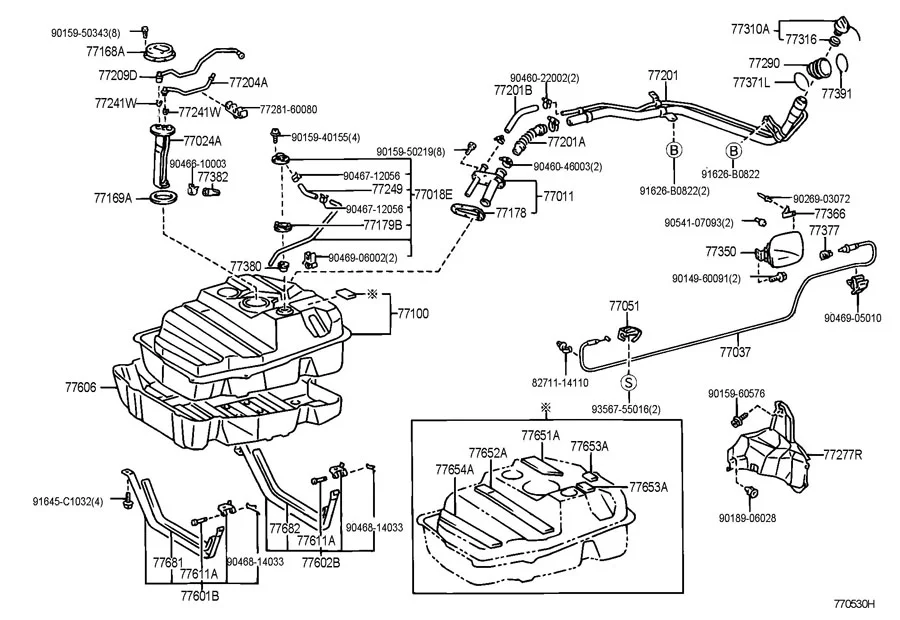

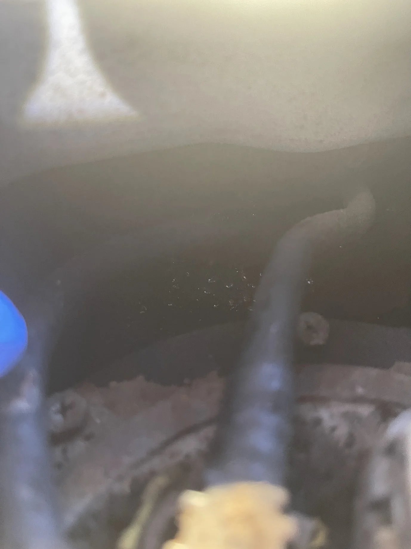

Long time 98 LX470 lurker here. She developed a leak in what looks to be one of the two fuel lines at the pump (77209 / 77204 from the diagram). I can't create a post without a pic of what I'm talking about no matter how bad the image is, so here you go :P.
Anyone know if I need to drop the tank to swap those lines?
You likely don’t have to drop it fully. However, if those leaking, I would strongly suggest looking at your others while down there. I went to replace one and luckily took a look around and replaced all hard lines underneath, the tank and skid plate.
Fuel lines came in last week and I was successfully able to get them in WITHOUT dropping the tank!
After inspecting the old 77209 line, I must have hit it when cleaning up with a wire wheel. Outer hose had a pretty good gash, inner was barely punctured, but enough for it to leak and run back to fuel pump area through the outer.
