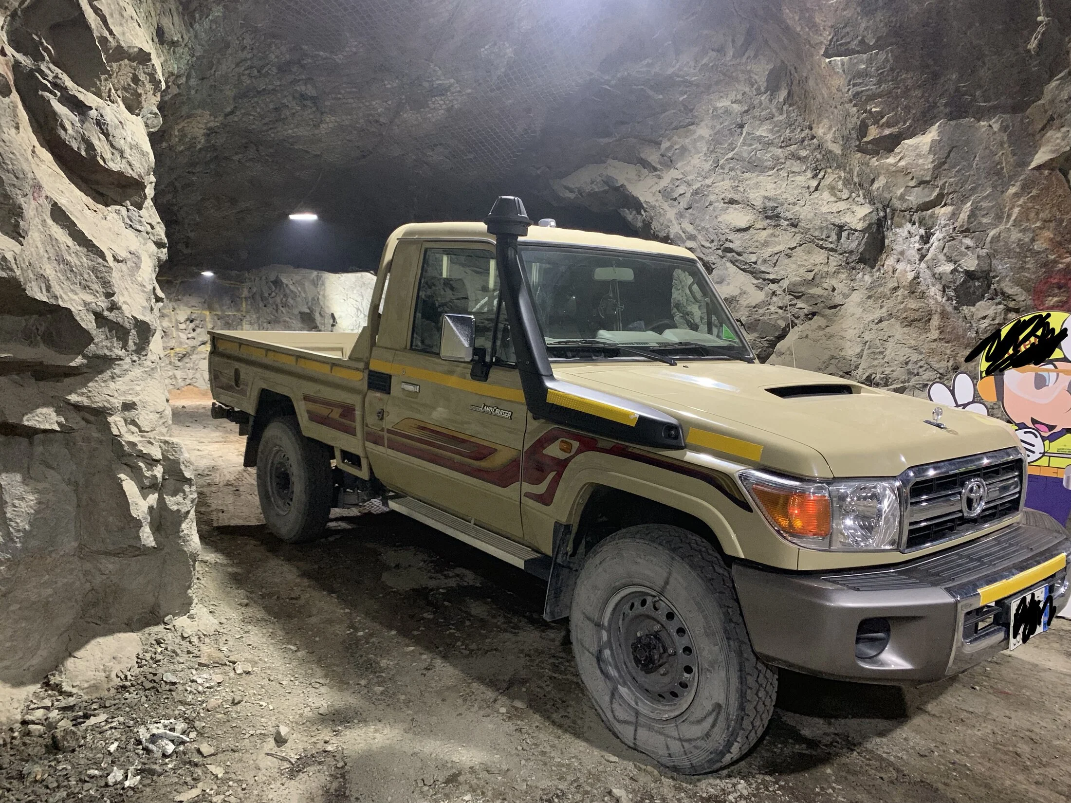

Just kidding but there weren't many. I didn't know that about the diesel 70's. What about the VDJs? Pretty sure this one didn't have lockouts. I took this photo west of Riyadh in late 2019.
So how many diesel 70 series were in The Kingdom 10 years ago? Two?
You'll surprised how many HZJs are in the market. The VDJ above has Auto hubs which all GCC VDJs came with. I converted mine on the 78 to manuals. They are easier to deal with.
