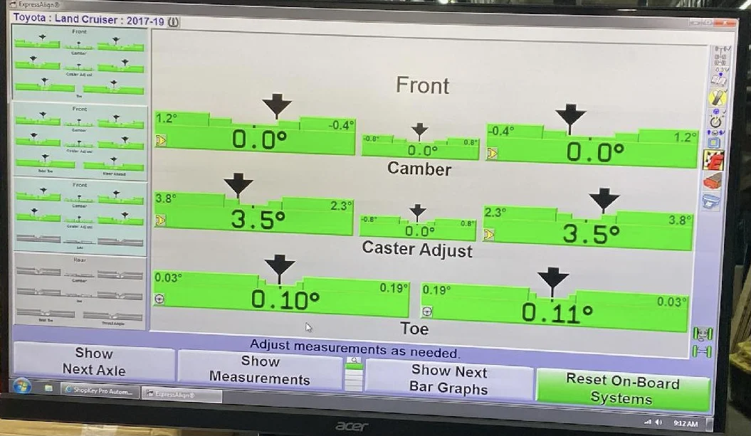

Have the alignment checked. I had mine checked recently. While the values were all spot on, I had them adjust the camber inwards to the limit of the range and it improved things noticeably, but not dramatically . My next step is spacers to push the tires out another 1" to compensate for the COG being 2" higher. Not sure what effect it will have, but a cheap treatment option and might look a little better too. I can't do all of the things and add all of the weight I have to my LC and expect it to drive like it did when stock - it just isn't going to happen.

Have the alignment checked. I had mine checked recently. While the values were all spot on, I had them adjust the camber inwards to the limit of the range and it improved things noticeably, but not dramatically . My next step is spacers to push the tires out another 1" to compensate for the COG being 2" higher. Not sure what effect it will have, but a cheap treatment option and might look a little better too. I can't do all of the things and add all of the weight I have to my LC and expect it to drive like it did when stock - it just isn't going to happen.View attachment 2754541
I am going to consider this next time when I go in for an alignment visit.
