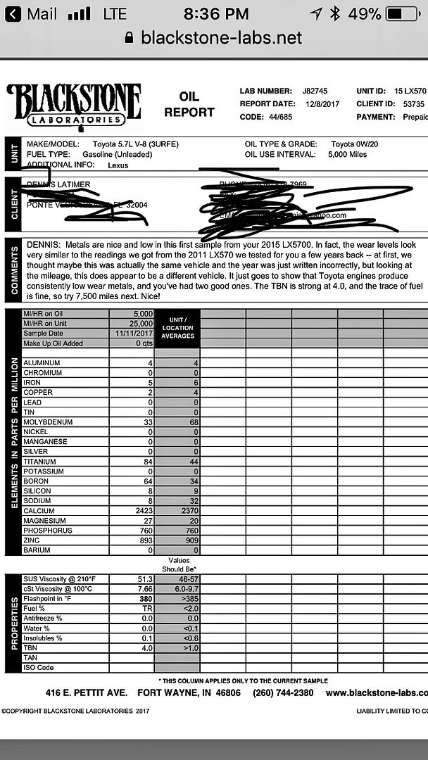

They used Kendal 0w40 on the oil changes. I figured that out from my Blackstone oil analysis, because of the high level of titanium in the UOA results, called the service manager and he confirmed. I'm sure they are using Lexus spec oil/lube at the best price. As long as it meets the spec's it does not have to be labeled Lexus/Toyota.
0W-40 oil does not meet any Lexus/Toyota spec for the LC200/LX570. Your dealer used out of spec oil.

I did the used oil analysis to determine how my engine was doing and when it showed it had high titanium in it which doesn’t match anything in the engine I started researching and found that Kendall liquid titanium 0W 20 oil uses titanium as one of the lubricants it’s a good thing not a bad thing I don’t care what my dealer uses as long as it’s quality and meets Lexus specifications. Toyota doesn’t manufacture oil they bid it out and people like mobil make the oil and the lube too Toyotas specifications which are not wild and crazy off the charts specifications, generally pretty much what anybody other manufacture uses

Still surprised your dealer would use Kendall products ... Here's a used oil analysis of TGMO 0w-20 oil from a LX570 - might help you track down what your dealer used:

That's my used oil analysis that I posted on my LX570. The titanium in it lead me back to calling the dealer about what oil they were using. They use 0w20 Kendall liquid titanium synthetic. Meets all Lexus spec's and is a superior oil. I do think it's wrong that Blackstone is showing titanium in the unit measurement average since I don't think Toyota/Mobile use any titanium in their oil.
Well ... unfortunate - and misleading - that you identified the sample as Toyota 0w-20 oil.

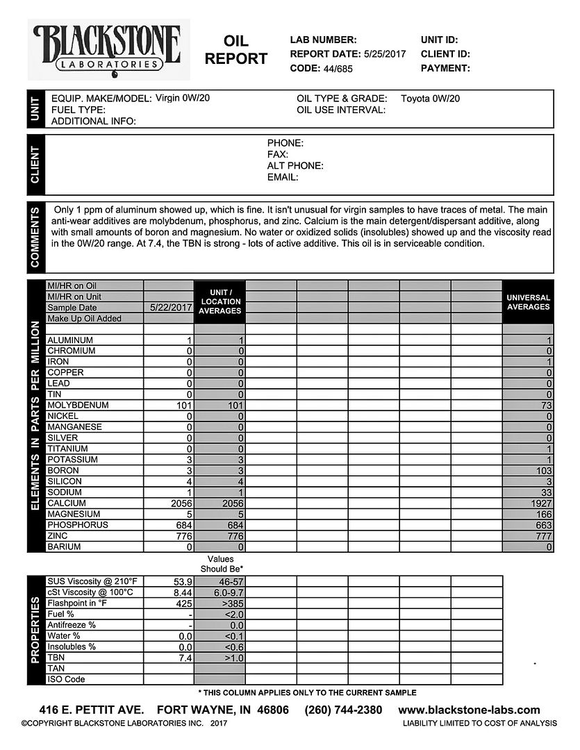

Just for the record, here is a Virgin Oil Analysis (VOA) of TGMO 0w-20 in a Toyota bottle, purchased from a Toyota dealer:
And to confirm that TGMO 0w-20 is made by Exxon Mobil, here's a link to their MSDS for the product: https://physics.usc.edu/Undergraduate/temporary/toyota_0W-20_msdn_vrd_0004740940mfv_0005160165.pdf

I guess it was kind of naïve of me to assume that a Lexus dealer used 0W 20 Toyota Oil which I know is made by mobil for Toyota. I question why Blackstone didn’t catch that it had to be Kendall liquid titanium 0W 20 because of all the titanium in the oil. One of the guys on Bob is the oil guy site caught the fact that it had to be Kendall liquid titanium to have that high of titanium in the oil no other brand does. I did some research and it looks like titanium has excellent antiwear properties and is replacing molybdenum that some other oils have commonly used like mobil one.
