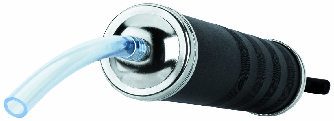

For those of you changing your fluids, one of these (see link below) works much easier than the POS hand pumps. It only holds 18 oz, so you have to fill it a few times, but only takes 2 seconds to load up. It made the front and transfer case a breeze, and pumps in super fast. For the rear diff, I recommend removing the spare tire and just squeezing it in directly from the bottle. I have used the M1 Syn 75w90 in every Toyota I have owned, amassing over 600k miles and my diffs have been trouble free. Then again, my brother has over 200k on his 2004 tacoma and it is still on the original diff fluid and is still working great (he has only changed oil and filter on the thing).
https://www.amazon.com/Lumax-LX-1185-Black-Suction-Vinyl/dp/B000MD4YNY/?tag=ihco-20
