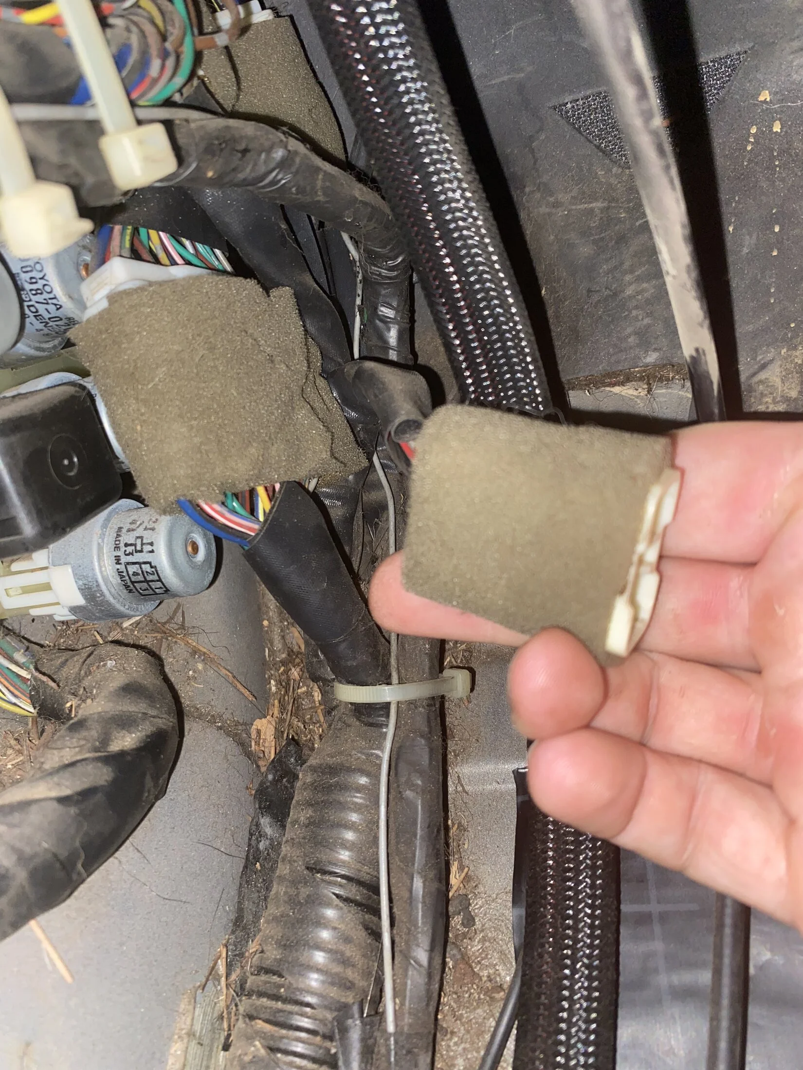

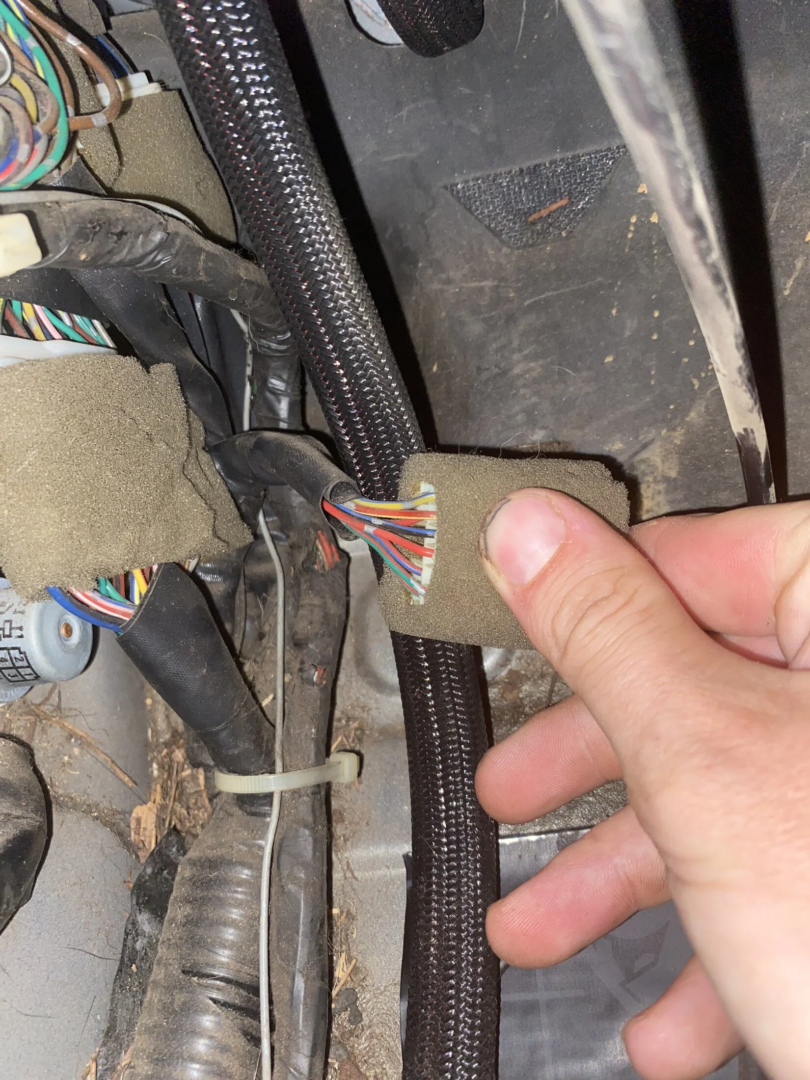

Can anyone tell me what this felt covered plug is for? It’s unplugged and there’s nothing obvious to plug it into to. It’s in the driver’s side kick panel
Also, what these three wires are for that have wire taps on them?
Thanks
The wire taps I believe are for your alarm system. Trace them and see where they go, if they go under the drivers seat that’s the alarm. There are a lot of options on different years and countries are rigs have lots of dead end plugs that are not being used. If everything is working don’t sweat it.
Thank you!

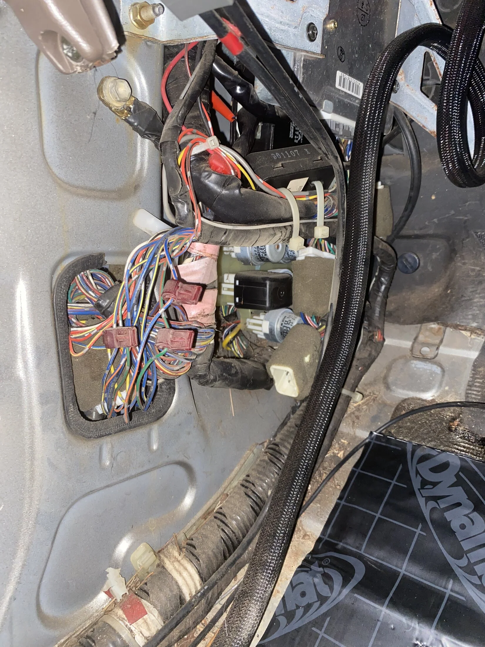

Trying to chase down no power to my rear dome light and rear door switches so this rules at least one thing out
Check the wiring splice... See post 11
Thanks for this! I thought I must have read every thread on mud about rear dome lights but I’ve not seen this one
Pull that entire bundle of wiring out from the rectangular opening and see if you don't find the other end of that loose connector.
