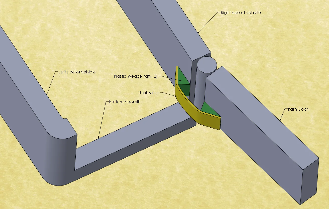

If you get a thick enough strap, similar to a tow strap, when you attach it to the door and the inside frame, use a piece of material (plastic) as a wedge to attach the strap to the door and frame. The wedge would be the width of the strap with the wide part of the wedge facing away from the hinge. This should ensure that even when the door is fully open, it should close while pushing the strap outward and being close in the door when shut.
I threw together a quick 3D model of what I'm describing (NOTHING is to scale, just for diagram purposes):
When you close the barn door, the strap should protrude outward preventing it from closing in the door.
That’s brilliant, I’m sorry I just now saw this.
I’d need to think through how to attach said straps to the panels. My gut says rivnut(s) with a grommet(s) through the webbing.
